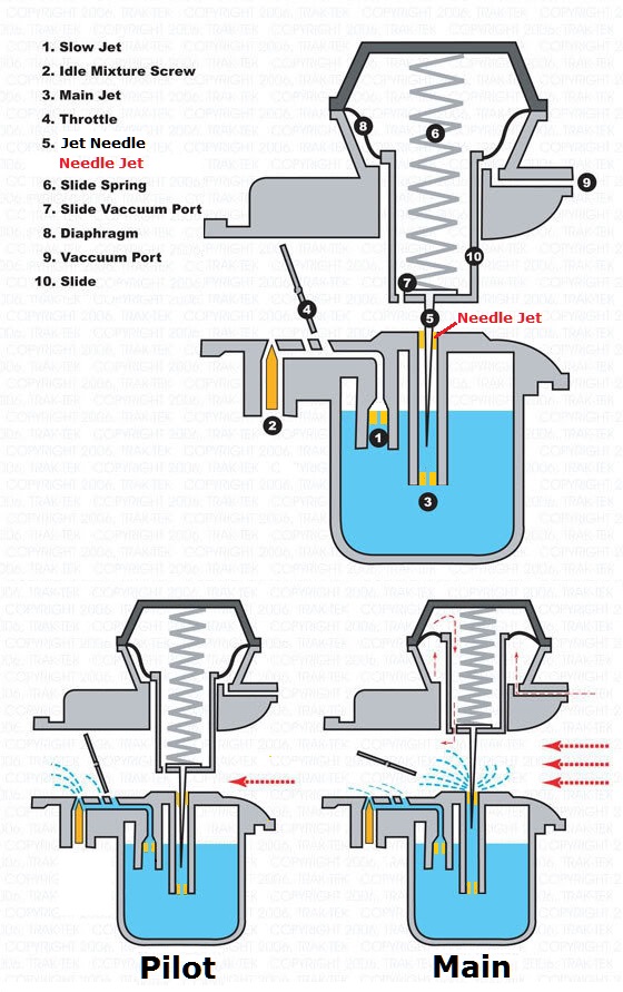

rboutin2 wrote: ...stumbles and is running lean on the low end, anything below 2700-3000 rpms....
Is a classic symptom of blockage in the pilot circuit.
Would double-check that carb spray squirted into the pilot jet exits from both orifices into the carb bore.
Some CV carb designs have the orifices located through top of the bore, and in any event the orifices are usually located near pointed tip of the the pilot screw.
If an in-line fuel filter isn't fitted, or the float bowl contains grit or sediment, a perfectly clean pilot circuit may instantly again become blocked.
