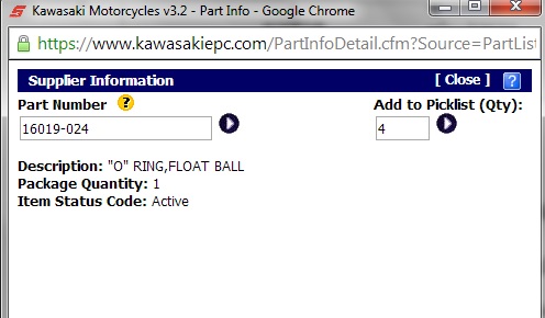

So I went to kawasaki.com , owner info, parts diagrams etc and looked up the float bowl o ring for my 750 carbs which is still available from kawasaki and after selecting the part number - see pic - I clicked on the little yellow question mark.
Clicking on the question mark gives a long list of carbs which use that O ring which is the same as yours. At least I think it looks like your carb. Going through these from the top it looks like pretty much the same carb as in your photographs is used on everything on the list from and including the KLT 200 A3 to the KLT 250 P1.
So not a "hybrid" carb as I thought and suggested above. If you can call up the list on Kawasaki.com you might be able to narrow things down a bit further.
Not a full answer but hope it helps

Thanks JR! You are absolutely right! Looking at the KLT200 exploded view of the carburetor it looks identical to mine. How about that...
Now the question remains is; did kawasaki put this type of carb on the later models kz200 or did the previous owner?
Anyway, thank you so much!! You guys really helped me with this one! :woohoo:
