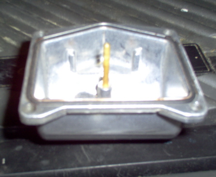

Re: 1983 KZ200 carb identification
05 Mar 2014 17:40Boudewijn wrote: That were my first thoughts also, that someone had put a 250 carb on it. Though i bought 3 dutch magazines from the late 70s and early 80s with the kz200 in it. In the '76 and '77 magazine i clearly see the original PW26 with the lever-type choke and bracket under the float bowl. The 1983 magazine shows the exact same carb as is fitted on my bike so I guess it's genuine as well.
I see what you mean. Your picture of the float bowl looks exactly like mine which is the same as in the diagram 650ed posted (KZ250 CSR) and yet if I enlarge the picture of your bike the carb does look like a totally different animal
Heres a pic of my float bowl.
I hope I am not causing greater confusion.
