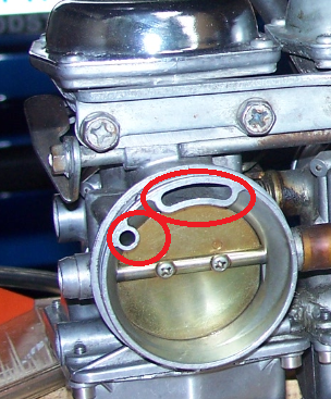

OK, so I guess I will run stock air box for now. And you were right rubbers on filters block these circled intakes on carbs. By the way the bike is '83 KZ750E.

01 Mar 2014 15:48So, took the "Made in China" pods and made some adjustments.
You can cut the rubber on the pods to make a room for the air openings indicated.
