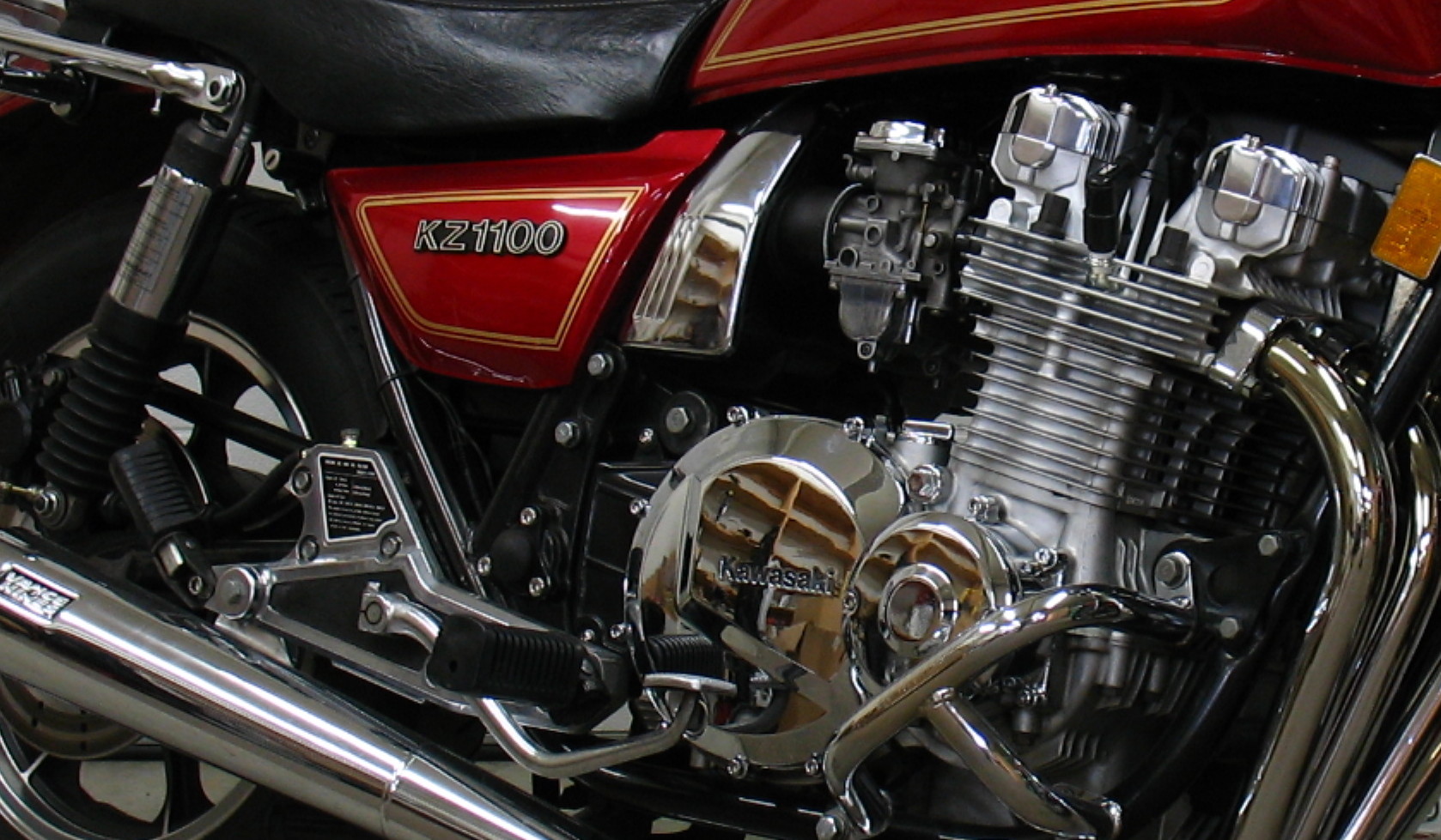

That small picture of bike looks beautiful.Looks you chromed everything.I want to restore my bike pretty much.Is that the stock color and decals? What color is that?

crusierlover
Such a nice complement. :blush: She's best when clean...squeaky clean, that is.
I tried frugal...forget it. Take time and do it right. Install Genuine Kawasaki parts, gaskets, etc...with few exceptions.
The color: luminescent Red (from the factory) is way-cool in certain light, especially when the sky is pinkish-orange. :kiss:
I love the way those massive, beautiful engines are just...all out-there for the world to see!
1982 KZ1100-A2
