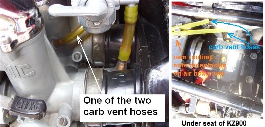

Would also assure that both carb float bowl vents are exiting to open air.
Which is usually via a hose attached to each vent nipple.
The hoses may be routed to exit underneath the bike, or as in the KZX900's stock routing shown here:

Also you mention two vent lines. In that location on my carbs there were caps when I got it. Last night I damaged one while I was removing the filter so I just taped over it until I get more caps but maybe I need vent hose instead? Also I have 3 of those vent nipples not just two?!

Your set of carbs should have 2 vent ports, and they must not be capped. They are intended to prevent the carb bowls from building pressure or vacuum as fuel flows into them or is drawn from them. One vent port should be on carb #2 and one on carb #4. They should have a vent hose going to the open air. The fact that you have a vent port on carb #3 tells me that a previous owner replaced that carb with the wrong one. That may not hurt anything, but that vent port should not be capped either. Ed

Also after reading several other threads I suspect my main problem was coming from having the vent lines "capped". The caps were sooooo old and worn that I'm sure they were leaking which would explain some of the erratic tendencies of the starving then running fine. So now that I have put vent lines on each nipple it should really change things!
