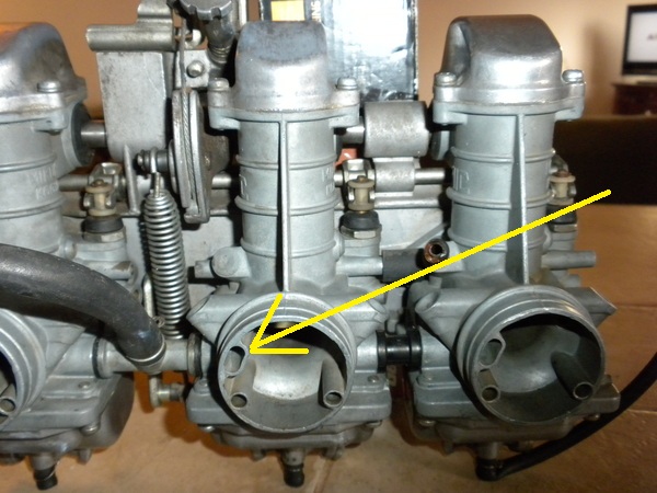

Re: 1978 650B Can't keep it Running - Carb Help VM24SS
08 Sep 2013 23:35 - 08 Sep 2013 23:35
A few questions....
It appears that the mufflers are not the stock parts. Does the bike have the stock air box and air filter? If not, what has been done to the carbs regarding rejetting? Also, assuming the carbs in your photo are the ones that originally came on the the bike it is a KZ650-B2A rather than a KZ650-B2. The distinction there is that the carbs are not the normal VM24SS (24mm) models. Instead, they are VM22SS (22mm) carbs. That may be worth noting when and if you must rejet them. The easy way to identify the 22mm carbs is by the extra orifice on the throat (see arrow in pic). The 24mm carbs do not have that. Ed

- goodspeed9000
- Posts: 4
09 Sep 2013 00:05
Sadly I have seen you post that before and completely took it backwards. I do have the VM22SS, would probably explain why every search always seemed to be the wrong carbs. :S Two weeks of thinking that... I just figured there wasn't much info. Yes it would probably appear that I do have the B2A, I had wondered that early on, but it seemed very consistent to the B model and I didn't think much beyond that.
Also I know nothing about the original owner of the bike, so exhaust could be aftermarket, but it is what was on the bike in 1996.
Air box is stock, with K&N washable filter.
Looks like I'll go back and start looking for info on the 22's and not the 24's. Thank you!
