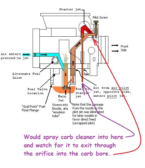

For reference, if not already done --
Would also assure that the timing advancer is properly functioning, and not sticking or hanging due to rust or corrosion.
