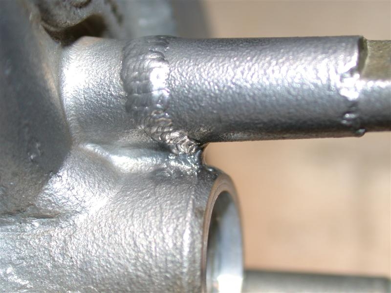

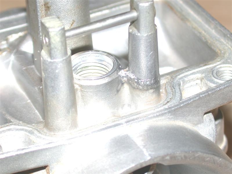

check out this post.
kzrider.com/forum/3-carburetor/535889-br...post-can-be-repaired
www.jmfmicroweld.com/MicroLaser.php

maybe jb weld is the only answer, aluminum is not easy to weld. another alternative would be a screw or small bolt with a helicoil.
- Powerstroke_fan
- Posts: 1019
- Thanks: 90
Re: CARB POST BROKE WHAT TO DO ??
15 Apr 2013 17:13
It probably could be welded also but jb weld should be sufficent.

banshee's got skills for days.
I bet a bit of molten melted aluminum dropped on there wouldn't have worked that well.
