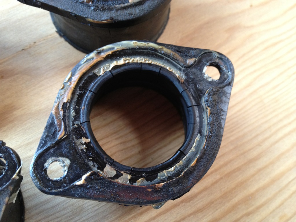

Does have new plugs clean carbs and full charged battery. I'm thinking its the intake rubbers. I've seen how to fix the mating surface but why do they say not to fix the sides?

It has been my experience when people bring me carburetors that they say have been cleaned, by "cleaning" they mean they took the bowls off off sand sprayed carburetor cleaner all over it. This does "clean" the bowl surface but does nothing for the passageways. I will take the carbs apart and find all the small passegways clogged up. Now were your carbs "cleaned" and if so by you or someone else. If someone else cleaned them I would do them myself. That way I know for sure they are done correctly, eliminating another problem area.
The reason you usually do not have to fix the side of the manifolds is because theat is not where they leak even if they have visible cracks. Even with visible cracks the manifolds are so think theat crack does not go all the way through. If they did the manifold would start to fall apart and that would be an abvious problem. They usually leak at the mounting surface.
