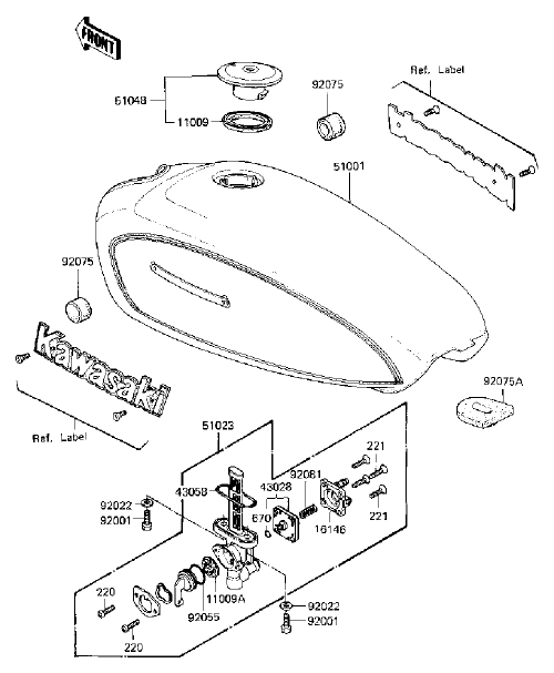

I included a few pictures of the disassemble, let me know if you see anything weird. specifically in the last picture, is this the correct orientation of the diaphragm, or should the other side of the diaphragm be on this side of the plastic?
TO be more specific, with the diaphragm in place in the petcock, the o-ring cannot be pushed inward any further, only pulled outward. Hopefully that make sense.

wait a second guys.....on the lever side of the petcock there is a metal washer/ring. Does that go in between the lever and the rubber gasket, or between the lever and the cover plate? I've been putting it in between the lever and the gasket thinking that the lever "slides" on it.
In the following image, 92055 is the O-ring, but i think I put the washer there instead. There is a ring between the plate and the lever that is unmarked. Is that the metal ring?
Could this misplacement cause a continually flowing petcock?
