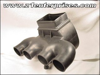

Wondering whether it might be feasible to use the Z1 airbox in a KZ900?
www.z1enterprises.com/detail.aspx?ID=2670
1976 KZ900
1976 KZ900

I believe the reason the KZ airboxes were redesigned (from the Z1 style) was that air would flow through the box with less resistance (sorry for the non-technical answer) and the KZ boxes have a higher volume. Someone asked if they could mount a KZ airbox on a Z1 and the short answer was no because the side covers were different - you'll possibly run into that issue.
May I ask why you want to do this? Are the KZ airboxes reproduced?

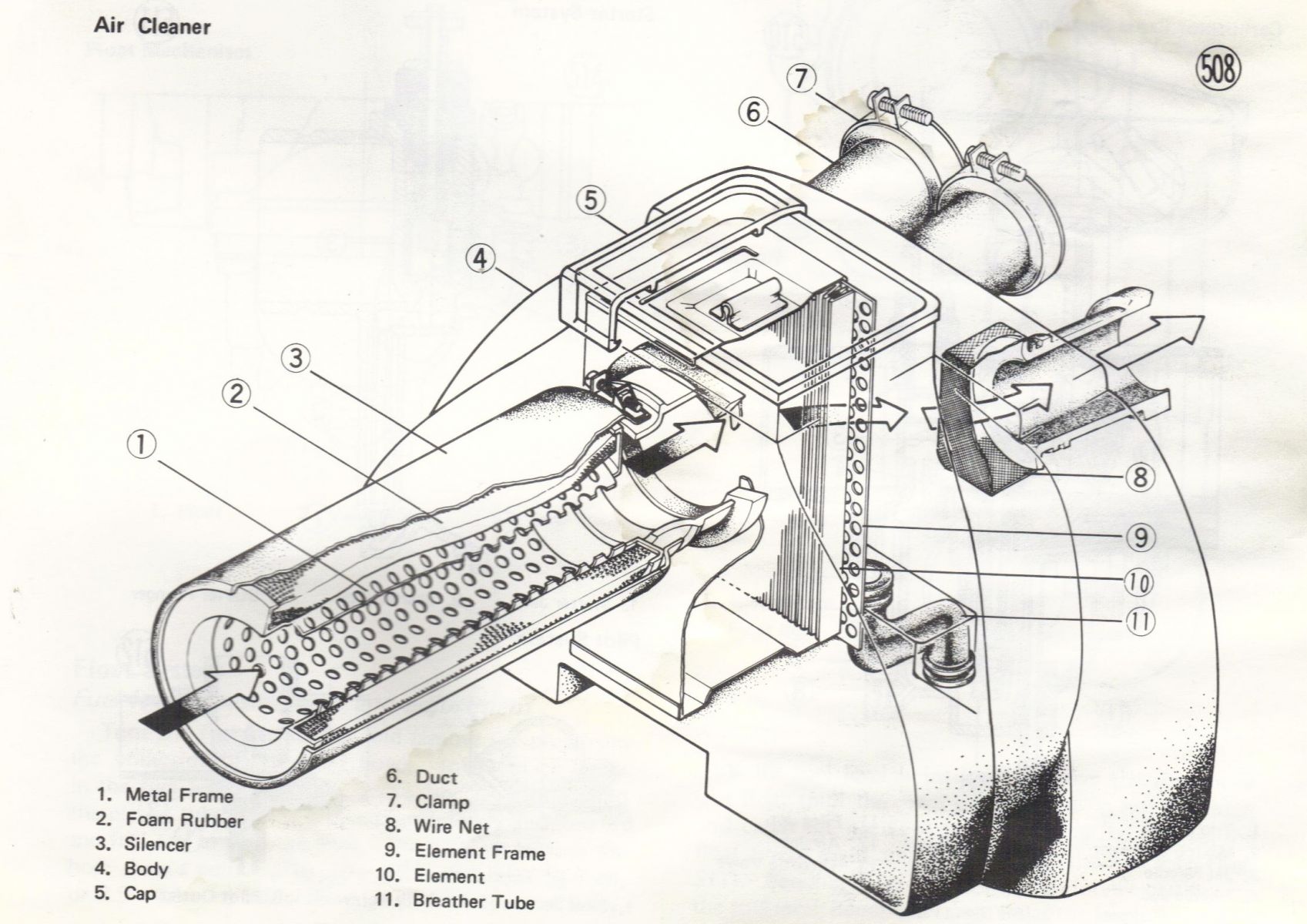

To update my last--all I really need is the silencer that fits on the back side of the airbox. If need be, I'd consider buying the entire assembly though to get what I need.

Well, back to the drawing board I guess. The company that told me they had the silencer for my 1976 KZ 900 airbox just emailed me and told me the silencer is no longer available and is discontinued. GREAT!!
Anybody know where I can find one--or know anybody that's fabricated one? My mechanic says I gotta do something to control the airflow. Right now all I've got is the airbox. Bike runs like crap. Goes on the bench tomorrow to see what he can do with it until I find/make a silencer.

I doubt the silencer is the cause of your crap running. A lot of people back in the day pulled them off and they ran great. Mine has run like that for 59,000 miles just fine. It was rejected to 120 mains for that, k&n filter, and exhaust. Chances are something else is wrong such as crap in the carbs or something. Just my .02
