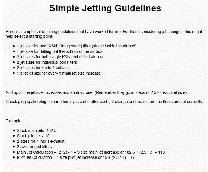

I'm happy to report that the conversion is done and the bike is finally running again. Seems the computer was bad before but with my new Mikuni carbs on there the bike has come back to life
Still need to re-jet the carbs and adjust valves etc. but it runs for now. I am selling any of the fuel injection stuff if anyone out there wants it. The only thing I am pretty sure doesn't work right is the computer. The bike wasn't charging when it would run previously and now that the computer is disconnected and carbs are set up it has started charging my battery again. Strange but glad that problem seems to be resolved for now too.
Any suggestions for jetting the carbs for my Z1 with pod filters and a stock exhaust?

What carbs are you running?

Mikuni VM26 I believe. Got them off craigslist from a guy that was parting out a 1977 KZ1000
I have pod filters on and have been using the jets that were already in there but I ordered jets for it from Z1 enterprises last week. Just waiting for them to show up.
The pic is how the carbs looked when I got them. I cleaned them up and polished them some.

Possibly help in getting you going...
NOTE: Keep in mind elevations/temperatures/climate conditions such as humidity etc...
