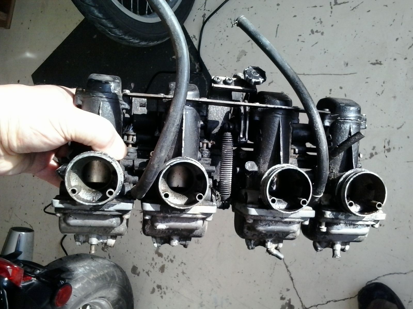

Not that I am looking to derail an old thread but to me it sounds like you have dirty old carbs with clogged circuits.
26 mm carbs on a 77 kz1000 may not be ball buster fast like some of the others but when they are clean and tuned they work great and are "very" reliable.
Wire George can make them brand new for less then 400 bucks

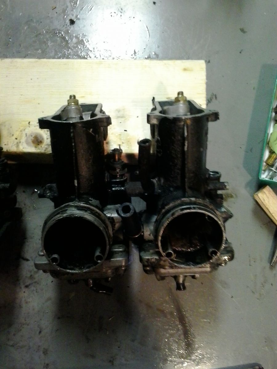

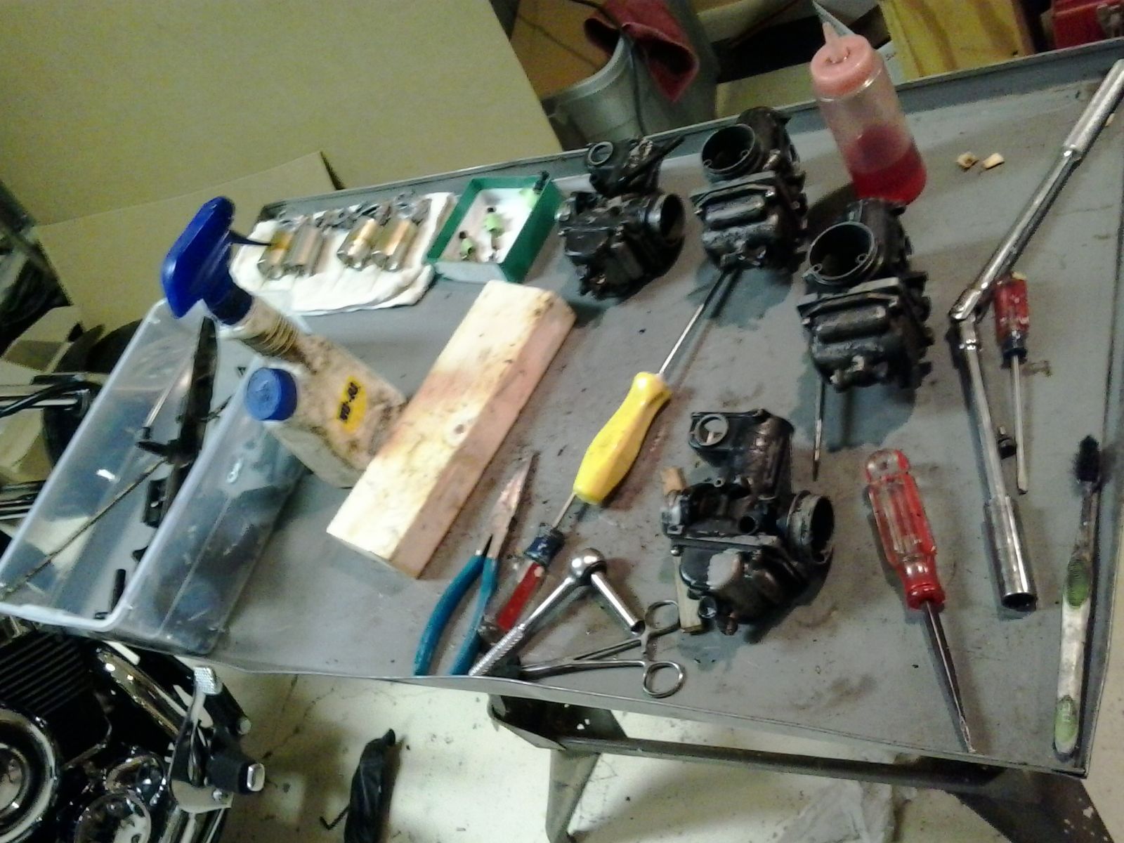

I don't know about free but yes you can do it your self for a lot less
For me it is a matter of economics but if I had the bread I think I would rather have WG do the next set.
This is the Winter of rebuilding carbs for me, I'm doing a set of 24's and a set of 26's
Both were froze up when I started and the 26's were painted :sick:
Beyond the free labor and cleaners I will need all the gaskets, O-rings and a can of carb dip
Then I still will be taking them to the local Suzuki/ Honda shop,( a very cool old school bunch of guys) to
have them sonic cleaned,
No idea what that is going to cost but it shouldn't be too bad.
I'm into it and don't regret doing them but I don't wish to have do it again any time soon.
I know that FI can be very dependable and if I ever find a Harley that I want to fix up it will have fuel injection
but I am not convinced that retro fitting F I a system on a 77 kz1000 is the simplest,cheapest, efficient/reliable way to go
if he wants to ride much this year.
Welcome to my nightmare :laugh:
