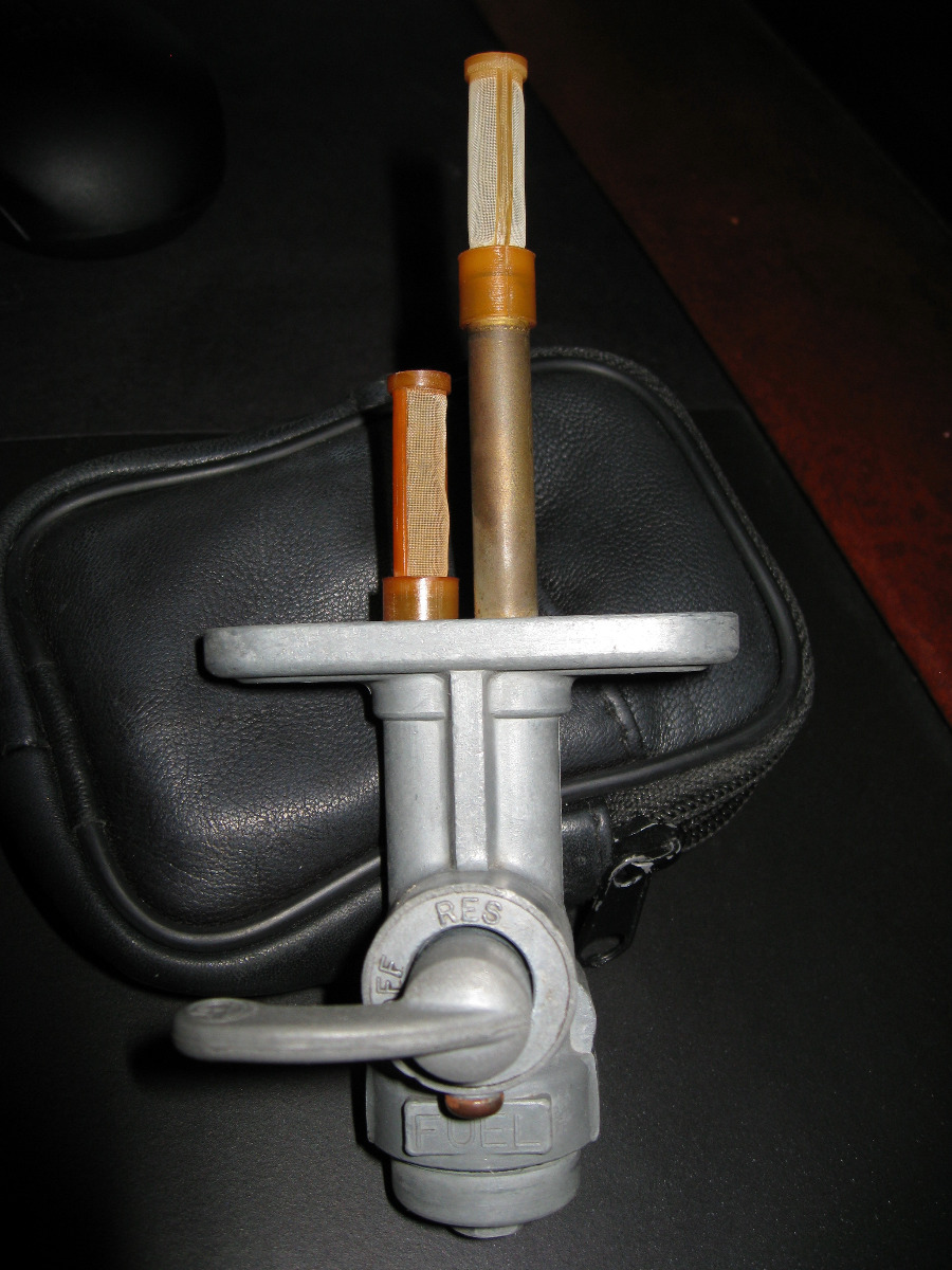

Re: How do I make my cold starter KZ650 Start faster
05 Oct 2019 17:22RayCheck wrote: I have the same cold start problems with my 1977 Z650. 15,000 k's on the clock.. how long should i use the prime setting and will it flood the bike. It is not unusual to run the battery flat when trying to start it from cold
It sounds like someone has already screwed around with your bike. No 1977 KZ650 ever came with a petcock that had a "Prime" position. Ed
05 Oct 2019 22:33
The rubber diaphragm in the original petcock was perished. I couldn't find a kit so bought a new petcock through Z1 that fitted. think it is made for a Suzuki. Works good.

06 Oct 2019 07:01 - 06 Oct 2019 07:01RayCheck wrote: The rubber diaphragm in the original petcock was perished. I couldn't find a kit so bought a new petcock through Z1 that fitted. think it is made for a Suzuki. Works good.
The 1977 KZ650 petcock did not have a rubber diaphragm and did not have a "Prime" position. Also, the carbs on the 1977 KZ650 did not have an orifice to attach the petcock "Prime" hose, so if the petcock was changed how would that hose attach to the carbs? If your bike has carbs with that orifice either the carbs have been changed or you do not own a 1977 KZ650. Below is a photo of a1977 KZ650 petcock. It has ON, OFF, and RES settings - no Prime setting. Take a look at label on the bike's the steering stem and post the VIN and date the bike was made. If the label is gone the VIN will still be stamped in the neck. Maybe it's a 1978 KZ650 rather than a 1977. Ed
