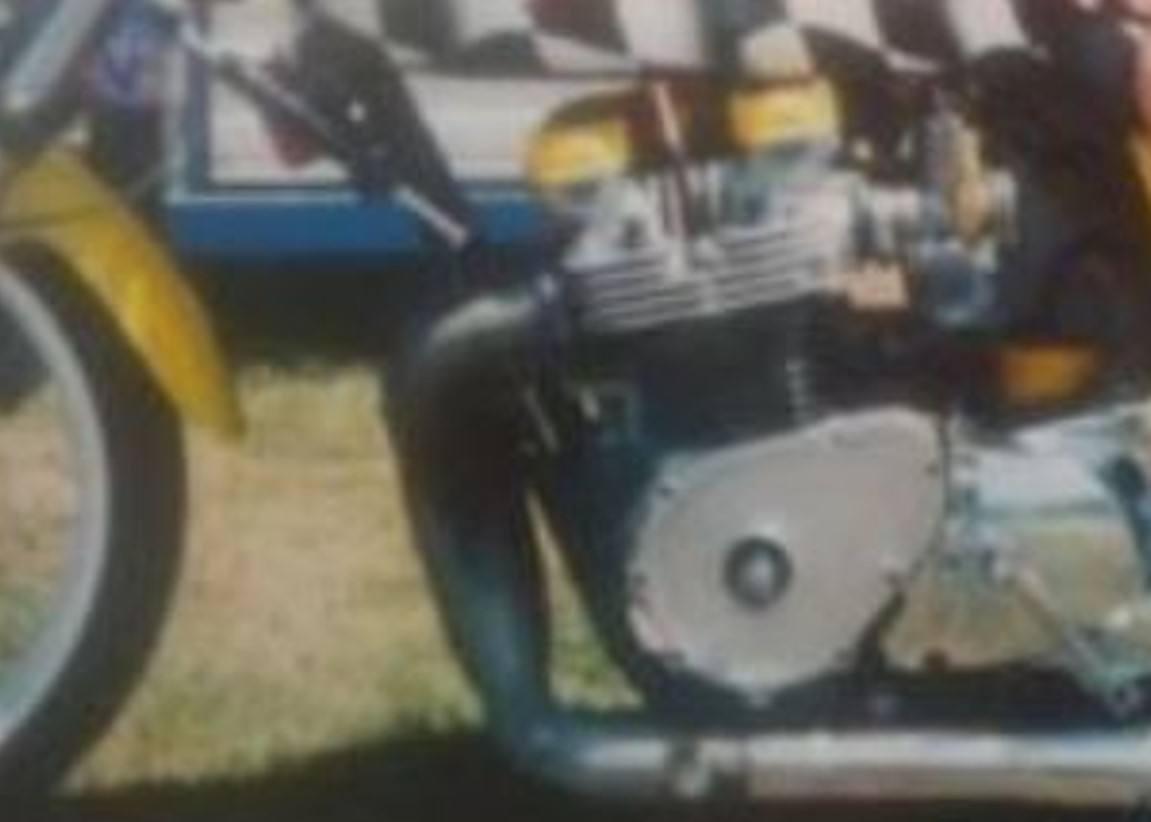

Once you set those Lectrons up you never have to touch them (hardly ever) My used 40's (on 1327cc) came with the wrong metering rods so my cylinder head guy sorted me out with some used rods off Paul Gast's old pro stock bike
The small cc engine is the main issue, as most used sets out there are 38mm and bigger (OK for +1260cc) Generally if its a blistering day the larger carbs do better, the rule of thumb is at least as big as the intake valve with +2mm maximum as long as you have some CC's behind it.
I have another pic of that 1075 yellow drag bike I bought as a roller from that guy, he was using 32mm dirt bike Lectrons.
I never did get the full specs on his engine and the majority of the stats came off his Craig's List add. He probably had a big valved pro ported Z1 head (round end cam cover) 31/37 valves with some +.430" lift cams. He tried to sell me the engine when I showed up for the roller, but he wanted $3K for the engine/carbs (back in 2012) but I thought that was too much.
Sorry about the low res crap pic.
Maybe you can search around for some used dirt bike carbs for the 1075 engine? Either that or just bump up to a big block to be able to run larger carbs.
