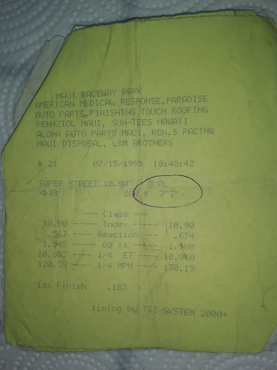

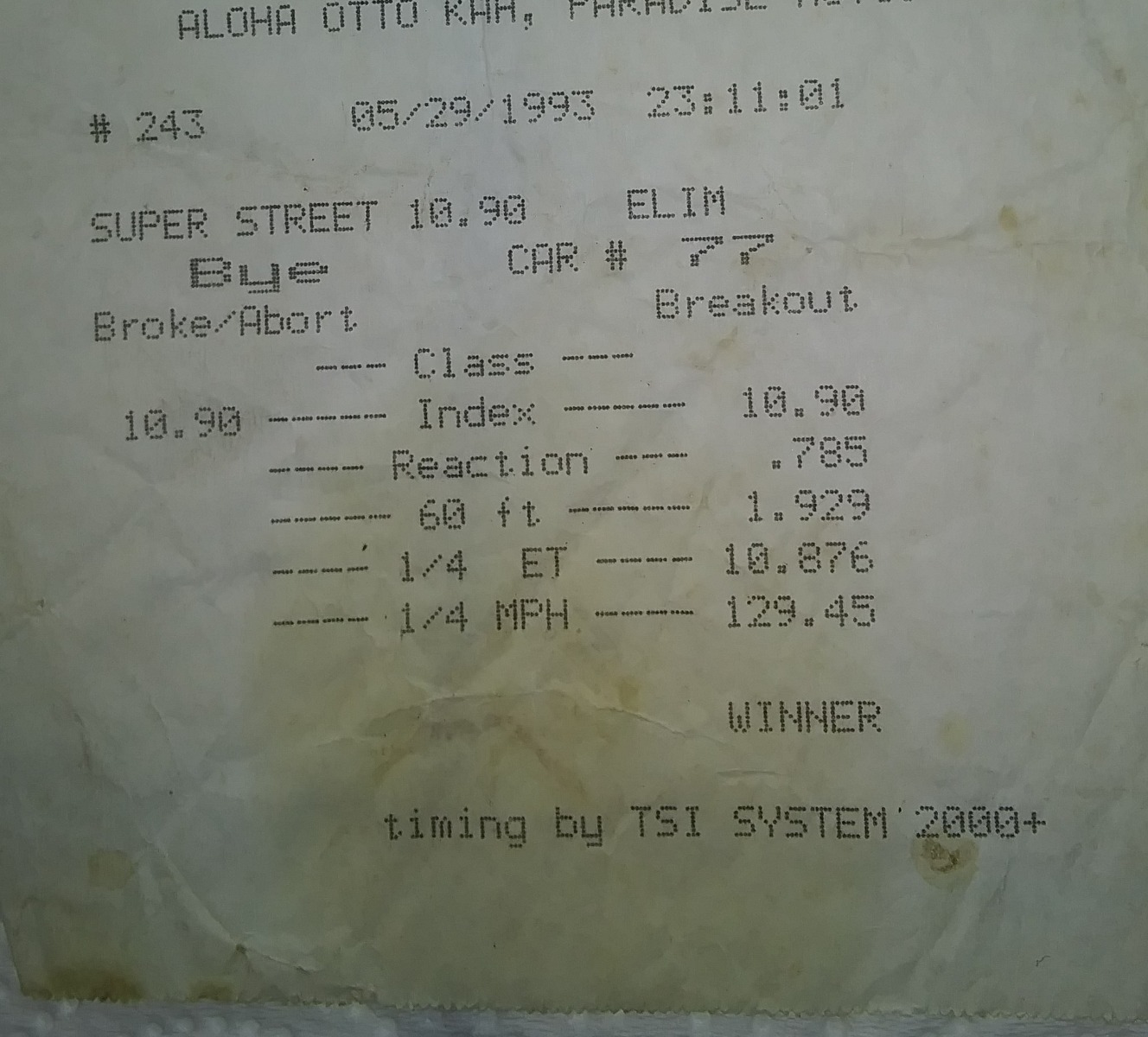

For me, (way back in the day), with my particular set up, shifting from 1st to 2nd was very early, maybe 60 ft. But as mentioned there are way to many variables that can effect that. I guess you just want the shift point at the max power band, rpm, and not before it or after it... That's what makes figuring that out so much fun at the drag strip. And the smell of burning rubber also...
Some of my time slips from the shoe box of yesteryear....
