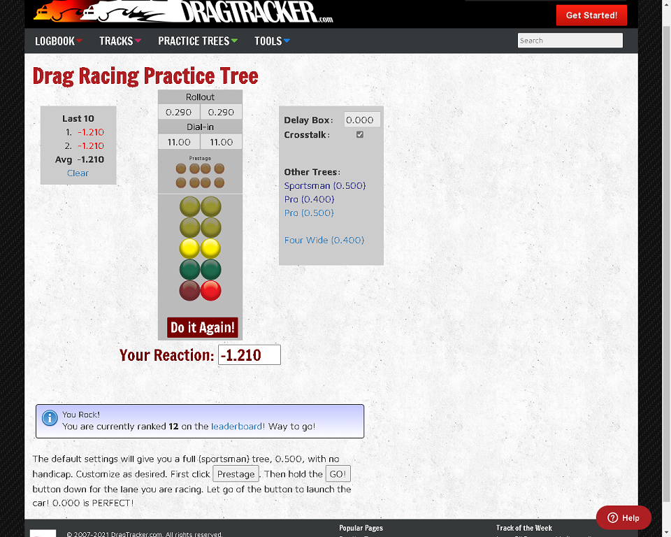

This won't help with the gearing, but maybe with the jitters.
www.dragtracker.com/app/practice-tree/
