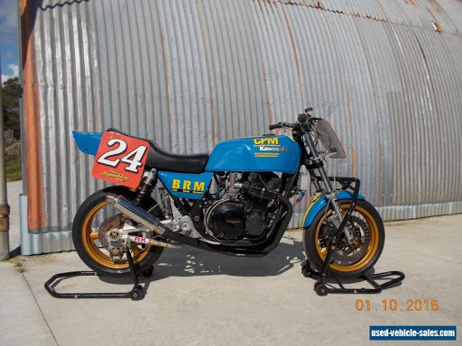

What State are you in ? I found this pic on the web with a small description of its mods for period 5.
"KAWASAKI GPZ100/Z1100 P5 RACE BIKE:37mm CR carbs, ZXR swing arm, brembo brakes, Manta disc's-forks-brace-triple trees-, CBR 600 legs, Scitsu tacho charger, wets and wheels , spare Ohlin's shocks, Dyna Ignition, Dyna coils , Dyna leads, Moriwaki cams-spring-retainers, Moriwaki 11.5:1 pistons, light crank, modified oil system cooler"
