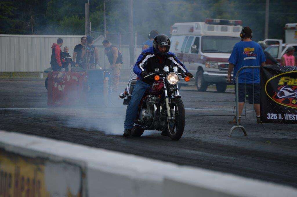

Went to the drag strip last Friday. What a blast! It's been a few years. It's the first time out on a fresh motor. Best time was a 12.23 @ 108 against a vrod. Here's something odd that happened. I rode the bike to the track, raced, and rode it home and parked it in the garage. Then Tuesday I started out for a ride and could not get it above 4k rpms, it just spit and sputtered. At the suggestion of the local bike shop I threw a new set of plugs in it and blammo, back to it's normal bad self! Easy fix, but baffles me how the plugs go bad AFTER cooling off.

Great photo by the way

Yes, it's quite the rush to race like that. It's also a lot safer than I think many people realize (like my mom and sister). If you're going to get hurt at the strip then it most likely was your own fault. It's not going to be someone pulling out of a driveway, a deer, potholes, etc. If something does go wrong you at least have the EMT right there to scrape you off the track. I'd like to think it makes me a better rider. At the very least I am very competent at nice smokey burnouts and well you know.....how cool is that!
