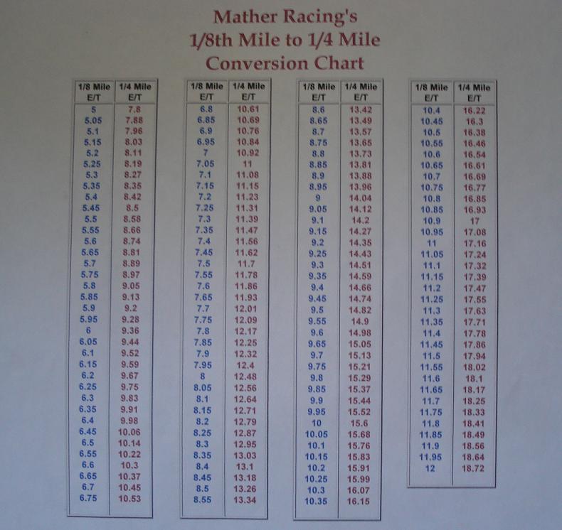

Went last night ran 1/8 mile. went 7.40@92.63 that works out to about 11.60 1/4 mile.
Made a few head's up pass racing a 2013 ZX6R and beat him 2 out of three runs.
Motor ran great was getting faster every pass then in elim,s I made it to the second
round had to run that ZX6R and bogged the motor off the line and couldn't quite run him down
he got me by about 1 1/2 bike's.

KZB4 you can't get to old to drag race. Last Sat was my B-day I turned 54 y/o..
Racer I used this calc. to come up with the 11.63 number but I'll take that 11.56.
www.hotrodpitstop.com/tool.php
Right now the rev. limiter in the GPz ign. is stopping it from going quicker
it shut's it down at about 9800 rpm's and the motor should be able to turn 11,000.
Was going 1.70 60 ft and the limiter was making me shift at about 45 ft out.
Friday's my bonus check payday so a Dyna2000 ign. WILL be ordered.
to fix that issue.
