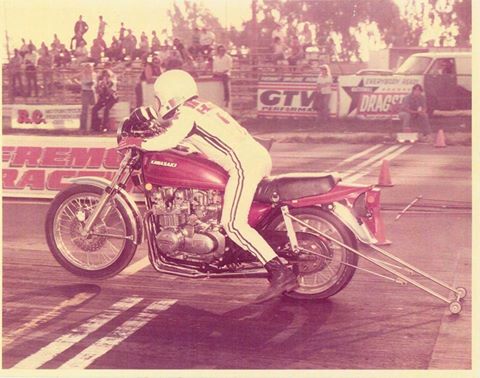

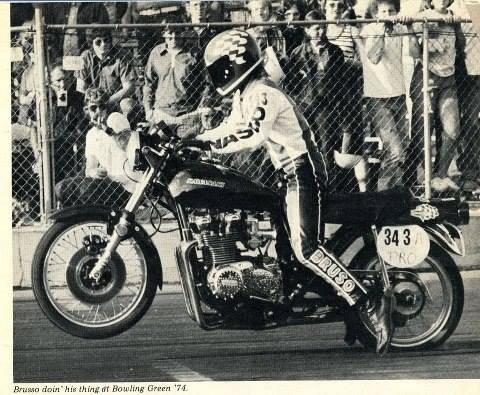

13 Feb 2015 16:54The good Ol' days. Mike Bruso wheelie bars with a Denco left exit header
