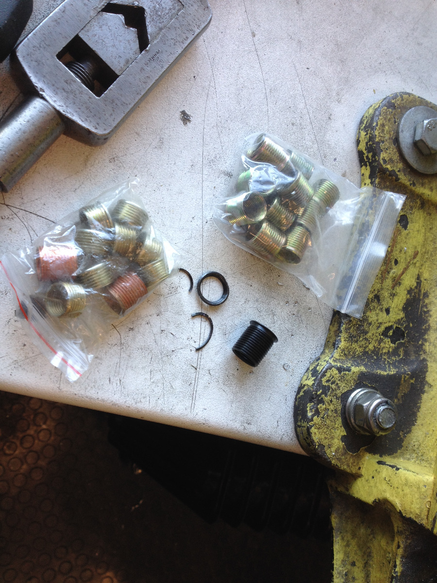

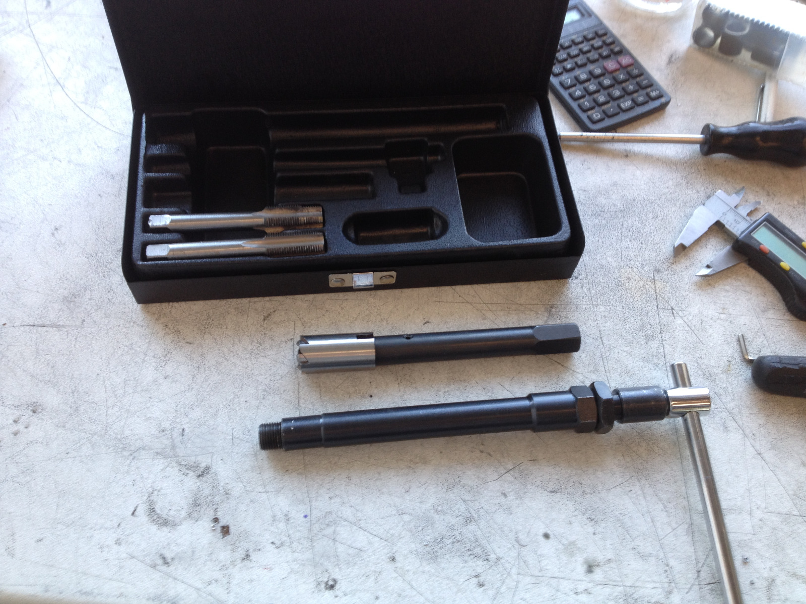

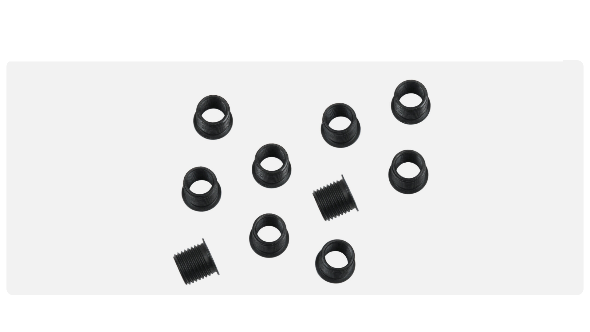

The complete kit i´ve shown above with 10 +10 thread inserts, ( 16mm + 10 mm lenght) had cost me about 30,- USD incl. shipping, so it was a simple choice for me, for this price i hadn´t get any M14x1,25mm tap, inserts and and driver separate...

Just in case: yesterday I bought 10 such threaded inserts very cheaply for less than $2...
( Inside M 14 x1,25 mm,..Outside M16 x 1,25mm,..by 17,5 mm lenght)...To have it, is better than to need it...!!!

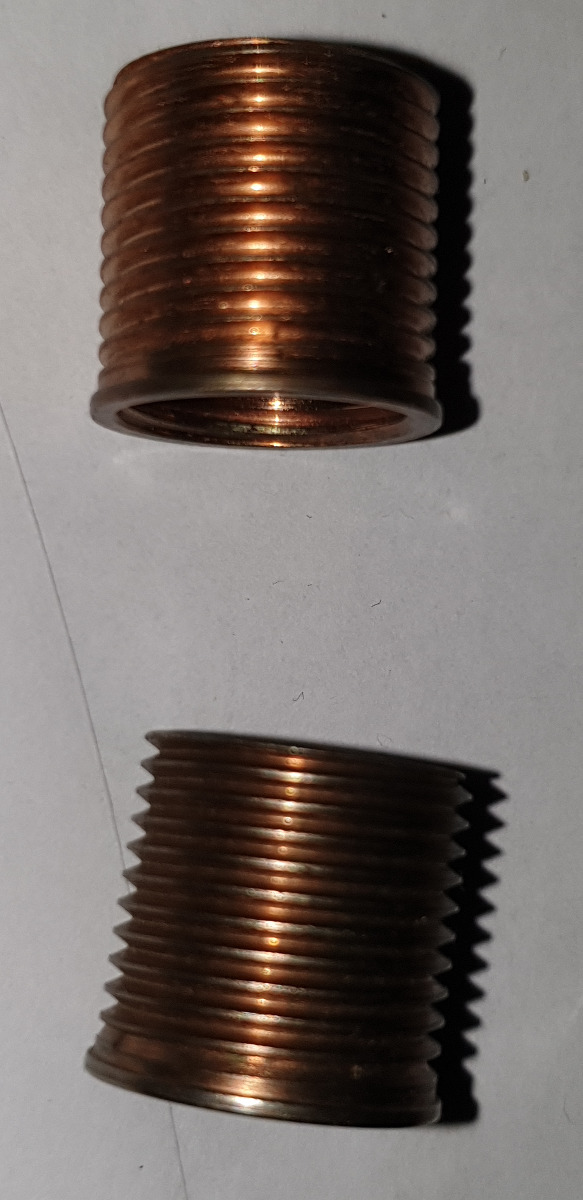

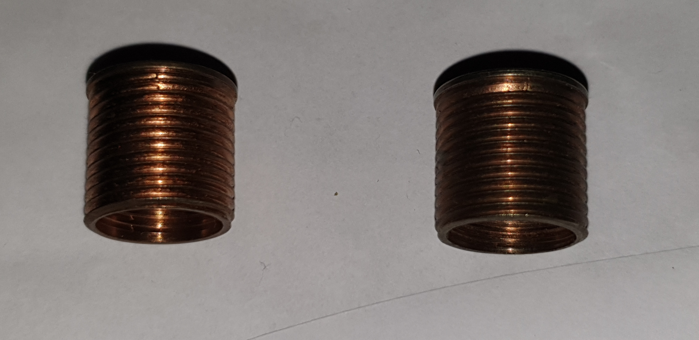

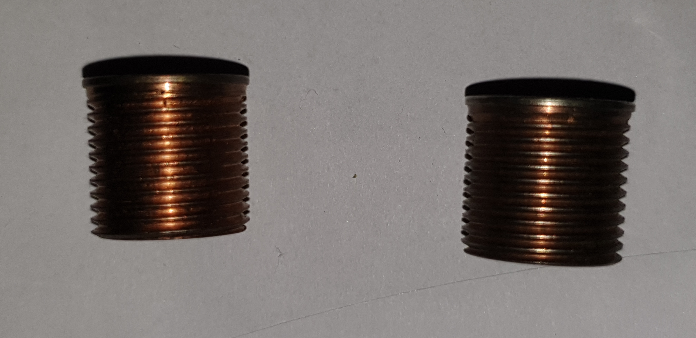

01 Mar 2025 15:41 - 01 Mar 2025 15:49To be honest MFP-Joe , but these black "thinks" are cheap China Ching-Chang-Chong Time Sert knock-offs!!!
Real Würth Time Serts are copper plated/colored ones.......

You´re right, scirocco, as i´ve mentioned, they have been cheap,..and maybe a handfull of brownies,... but for this price it would be a fun for me to give them a try in a block of aluminum, put (as ever) some copperpaste on the plugs thread, hotten the alu-block several times, pull the plug also few times,..and than i will judge about and be able to report here...

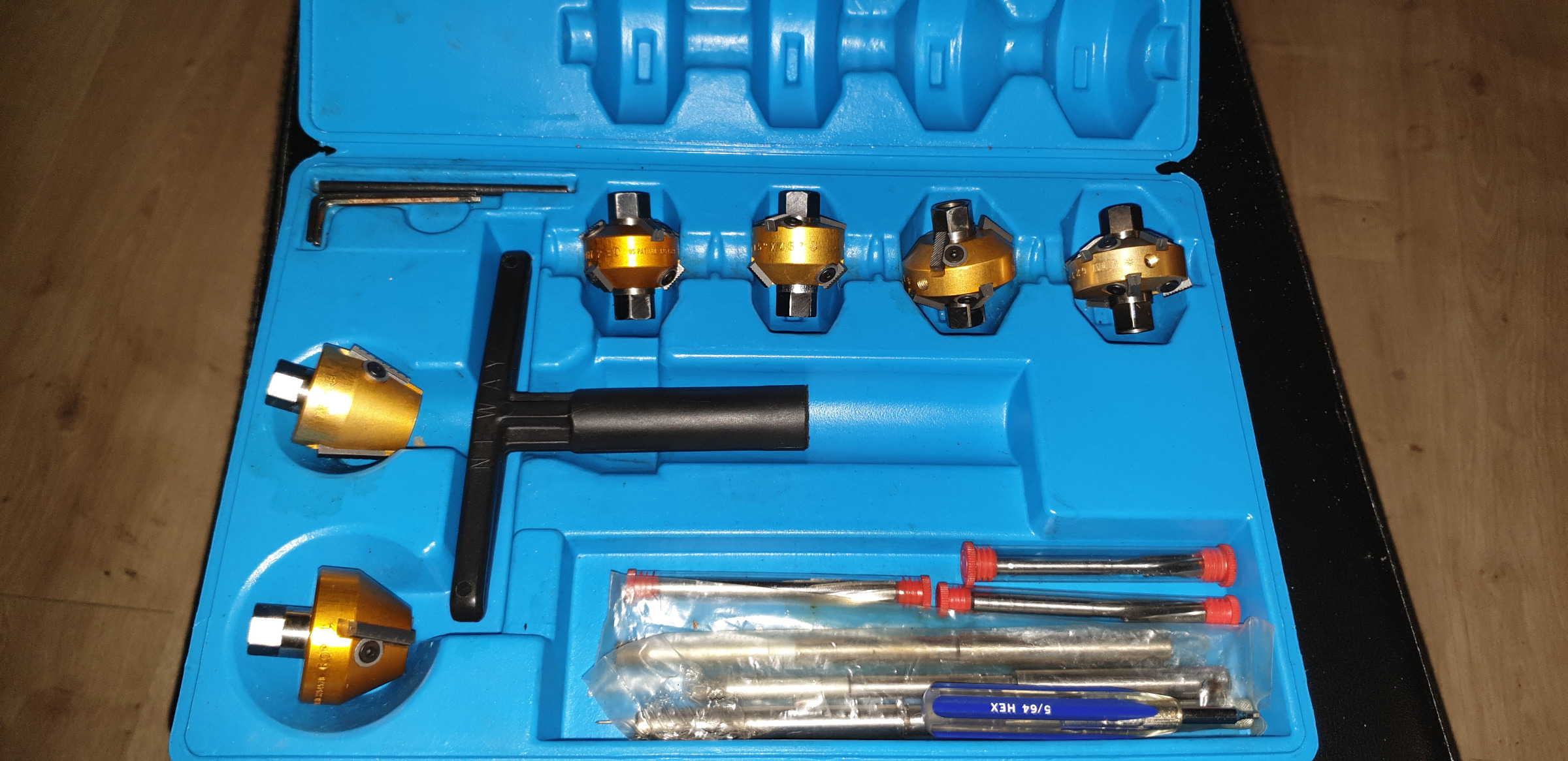

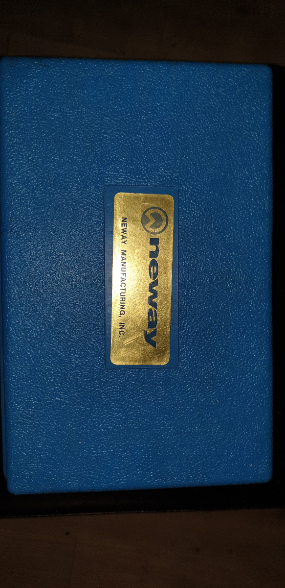

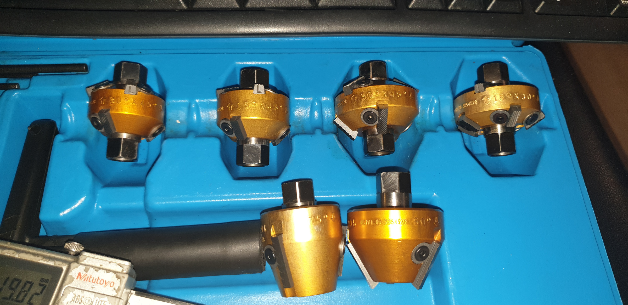

Bye the way: Are you satisfied with theese Neway seat cutters? i´ve worked only with Hunger-tools in the past and have no experiences with Neway cutters..

I also use the ne-way cutters they are super !

The NEWAY valve seat cutting tool set worked perfect for me.
One of my best tool (and expencive) investment ever!

Scirocco;
you´re right and i must agree! -These china ding dongs are really made from some mystery metal,..a bit of steel, a bit of some shit,...and with focussed lennce, you might read on it " at first life i was a beer can"...( bye screw in inthe new tapped M16x1,25mm they broke and disintegrated totally....is for the trash can...! ( The few little bucks it was worthy for me, to check them and have now a prooved experience
The "gold" ones came with my tapped kit, and they are working problemless, strong and reliable!
I´ve done 5-8 repairs withit, works very well...

07 Mar 2025 11:59Scirocco;
In Germany we would say: "Kauf billig, kauf zweimal !!!" (Buy cheap, buy twice)

The gold plating has nothing to do with the quality of the insert, its yellow zinc-chromate, commonly found on lots of cheap steel products. Black oxide is an adequate finish where corrosion is not an issue. The inserts also come in 303 stainless, and the "Timesert" brand black inserts are zinc-phosphate coated. None of that has anything to do with the quality of the steel and often shiny zinc is used as a marketing ploy to give the appearance of value.
