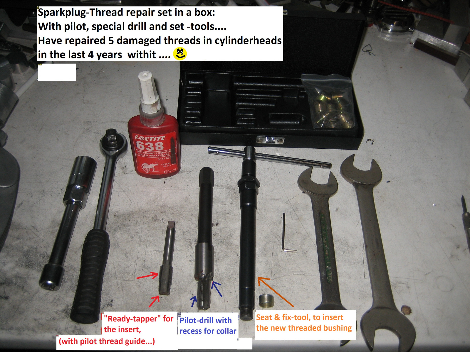

Sure, Wook, i agree full about the price, "Würth" is an realy expensive choice,..BUT:This video actually explains it best! It is also important that the socket has a collar at the top
That doesn`t meant, that it is the only one, i have a plug-threat renew-kit from an nameless manufaturer, and it works same way, with same style inserts and installations tools..!
Here you can see the tool-set, i do my work withit...(( and as Wookie58 mentioned before: For rare and "sometimes" repairs in a hobby it´s good enough and the inserts are still sittin`as they should,...but if i had to do it as an professional day by day, i would buy the "Würth"-setup! - Just my opinion

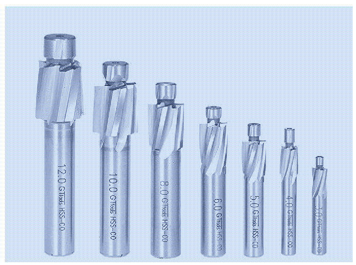

Step two, drill the hole for the correct tap size
step three. counter bore the hole approximately 1 mm, you will want the counter bore to be as close to the diameter of the lip on the insert as possible, this will mean using a counter bore with a pilot smaller than your hole. wrap some masking tape around the pilot on the counter bore to help the bit self center in the hole, oil the outside of the tape after. You are removing very little material here so the tape should last long enough for one or two holes. If you don't have a counterbore set, you will need to buy one. They can be had for as cheap as $37 on ebay and can be used for your other projects as well. Otherwise you can do it with a drill bit but be carefull because they will want to catch and dig in.

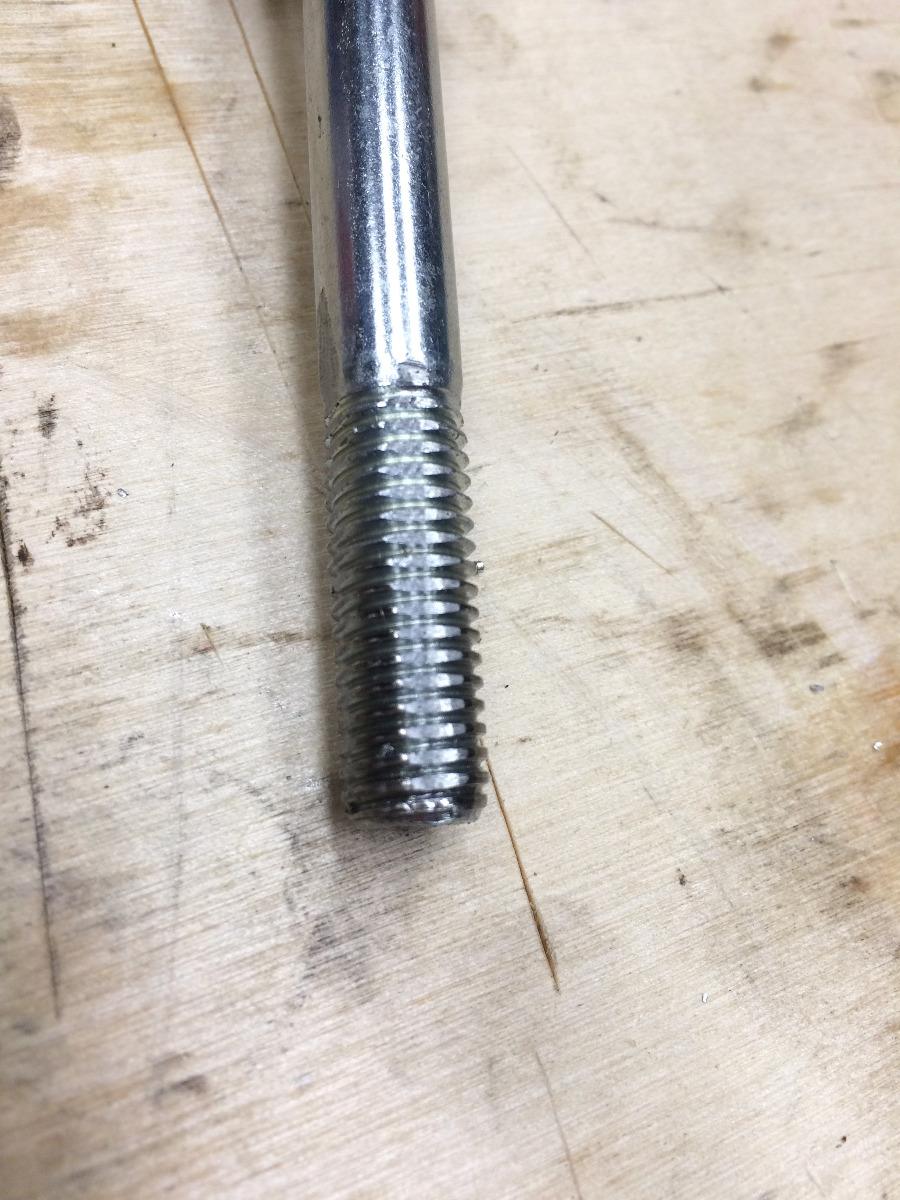

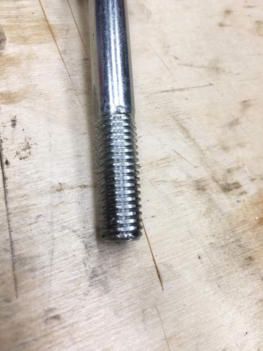

step 5 file four sides of a bolt thread flat, it is the same size of the insert ID. Take just enough off to take the thread down to the minor diameter of the threads. this is your insert driver.
step 6. make sure the tapped hole is clean and dry, thread the insert into the hole. Oil the driver and thread it into the insert all the way through the opening, thus expanding the insert and making it permanent.
