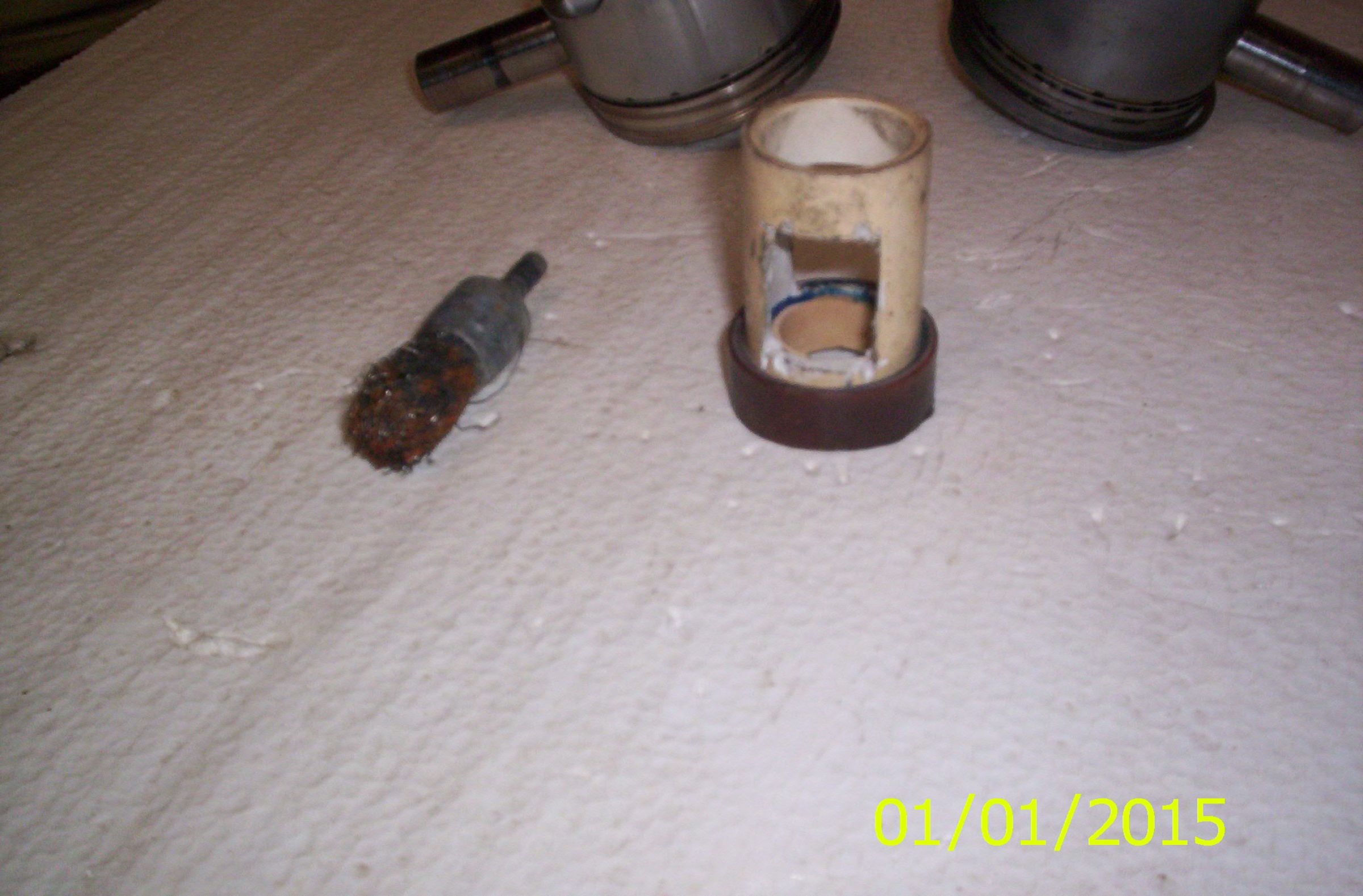

8" C clamp with the sides of the socket cut out. I've used a piece of PVC too but you have to use a deep socket to break free the keepers then the PVC to remove them.

That $18.50 jobby should work fine. I used a C-clamp from Harbor Freight and a PVC chunk with a window but I like the real spring compressor deal better.
