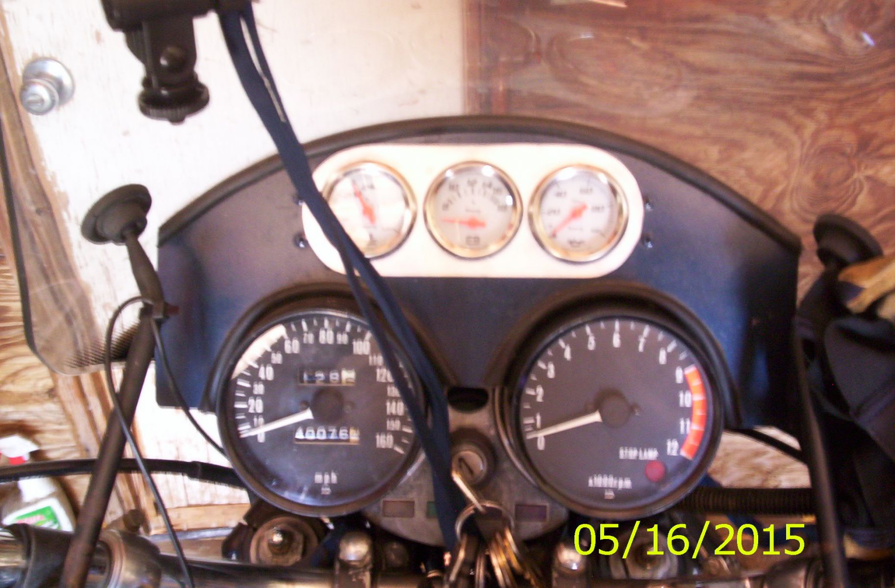

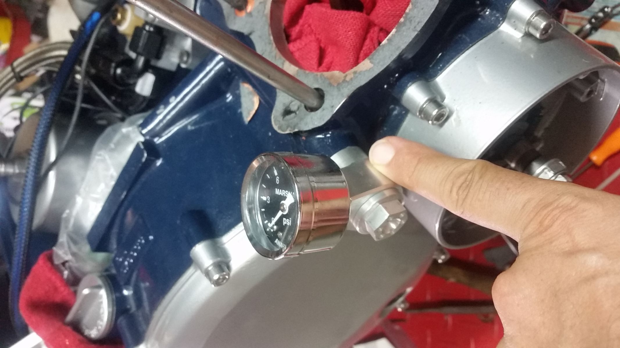

Oil pressure is between 3-10 lbs on our bikes, ...I don't think you could get an, or any reading on that oil pressure gauge, ...look at the one kaw-a- holic is displaying, ...that's the kind you need

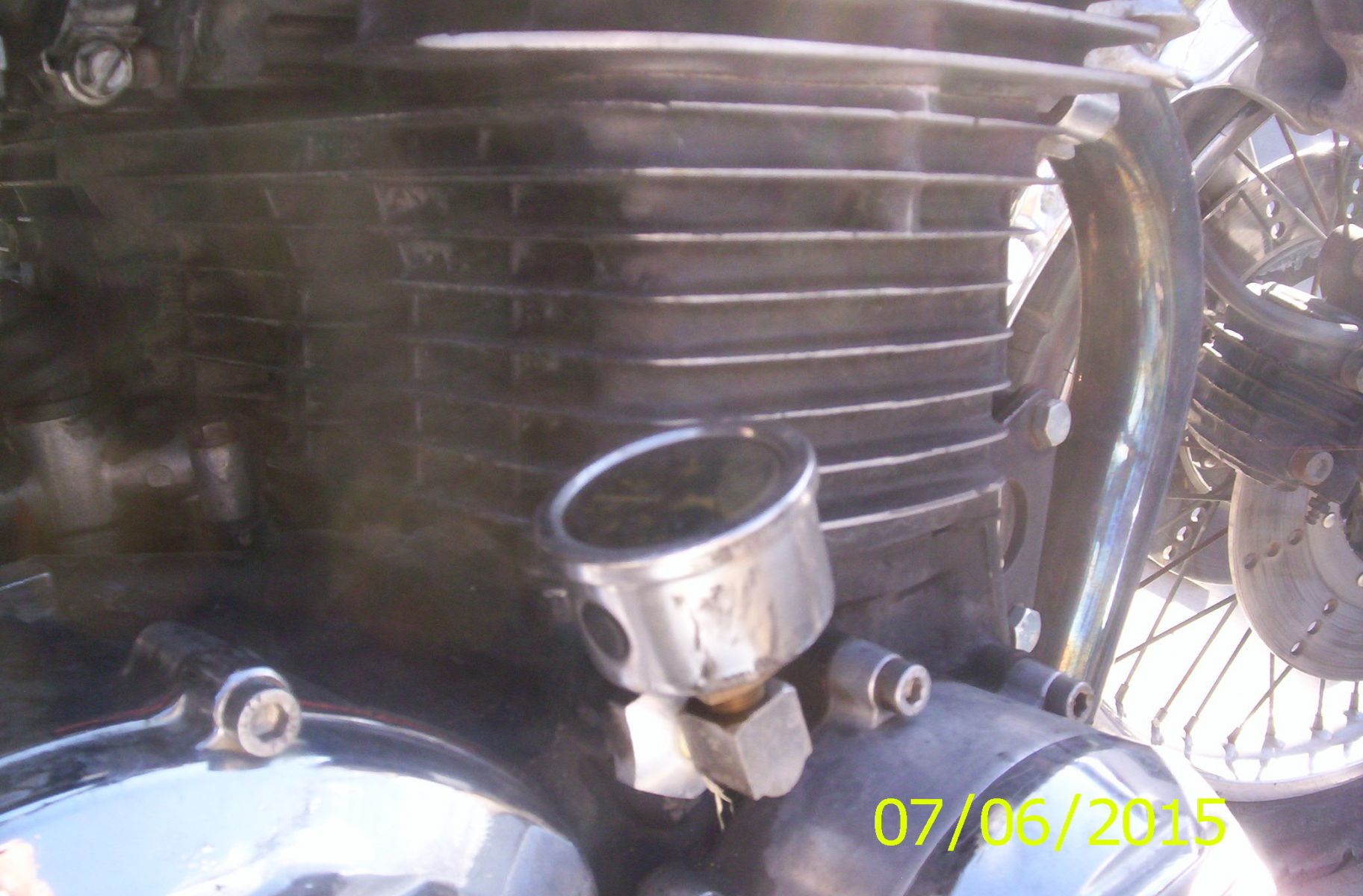

06 Jul 2015 15:48You could order one like ours on eBay. Higher pressure though. I have two. One down there and on on my dash. The lower one works all the time the other one doesn't. Too low pressure on the big Z's.
Jon, that gasket is ON there. No sealant?
As for the oil pressure gauge, look for one that is for motorcycles. You don't need anything that reads over 15 PSI.
Steve- yes the gasket is on there. I like to use copper coat on both sides of the gasket. Is it not needed?

The smaller bikes have higher pressure. Ours won't work for him. They have plane bearing lower ends.
I don't use sealant normally. If in doubt I will.
