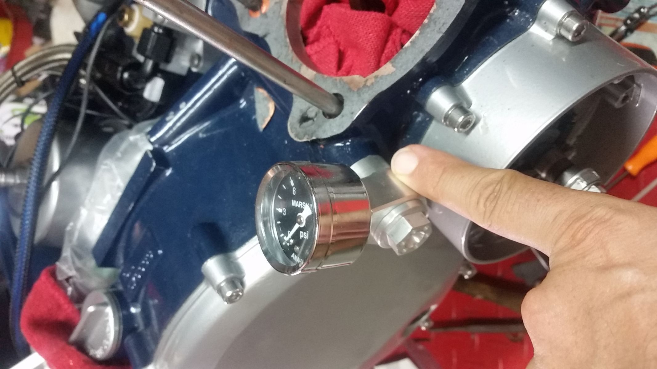

- kaw-a-holic
- Posts: 1808
- Thanks: 249
Re: Will this oil pressure gauge work?
06 Jul 2015 15:19
Jon
1977 KZ1000a1
Mesa, AZ
Phoenix Fighter Project
1977 KZ1000a1
Mesa, AZ

Oil pressure is between 3-10 lbs on our bikes, ...I don't think you could get an, or any reading on that oil pressure gauge, ...look at the one kaw-a- holic is displaying, ...that's the kind you need

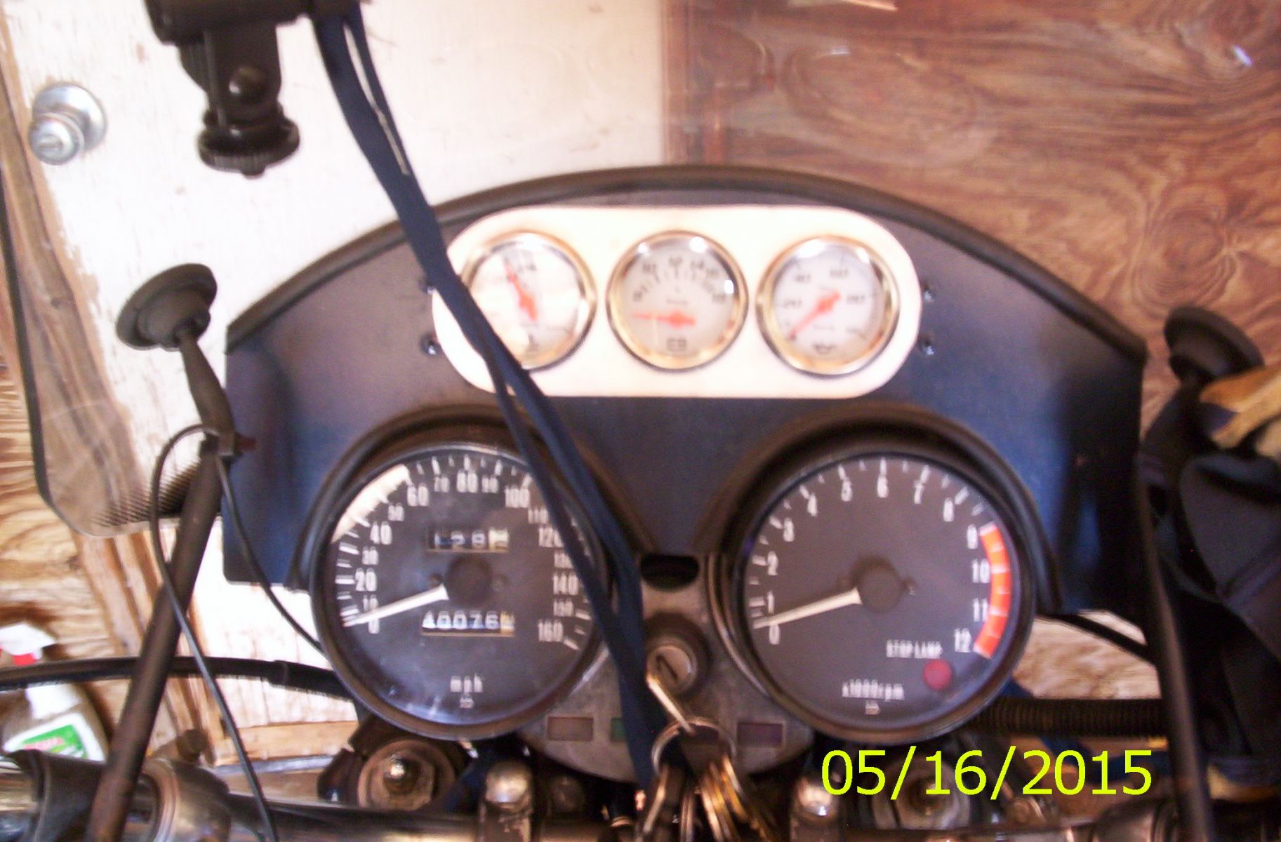

06 Jul 2015 15:48You could order one like ours on eBay. Higher pressure though. I have two. One down there and on on my dash. The lower one works all the time the other one doesn't. Too low pressure on the big Z's.
Jon, that gasket is ON there. No sealant?

As for the oil pressure gauge, look for one that is for motorcycles. You don't need anything that reads over 15 PSI.
Steve- yes the gasket is on there. I like to use copper coat on both sides of the gasket. Is it not needed?

I reworked my oil pump. Instead of 3-10 PSI I have around 20 when cold. As much as 30 at Rev. It goes down as it heats up. Multi grade oil. I blew two Doremi gauges. I returned one and kept the other for the sexy plumbing fixture. This is a cheap Sportster gauge. 60 PSI. It works fine but the Bezel is plastic and is discoloring in the sun. I plan to repaint the case and get a better one soon.
