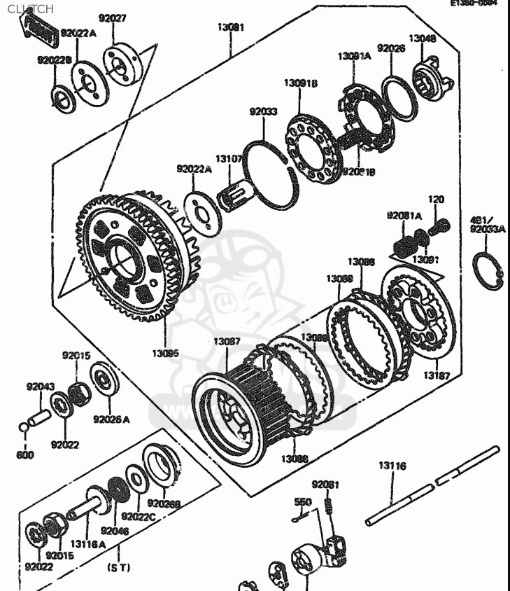

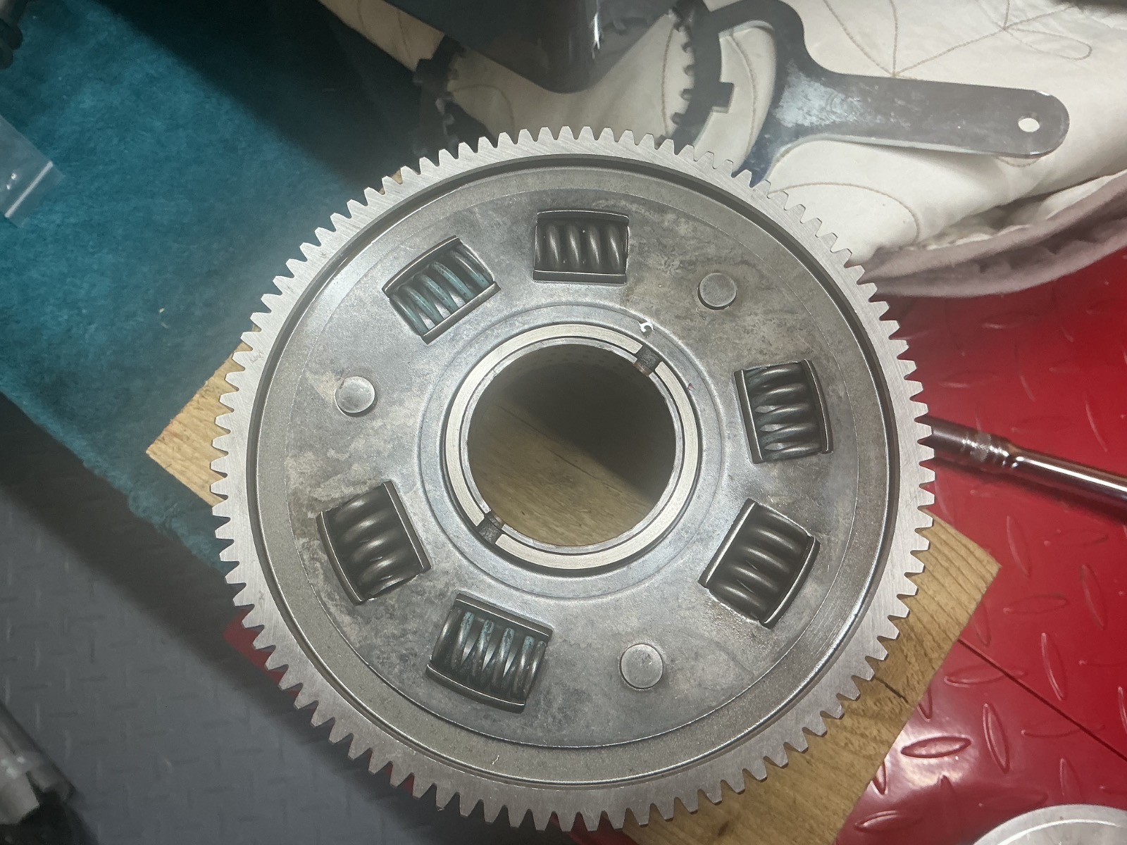

so basically ive noticed my clutch basket is rocking slightly (the clutch fibres aren’t fitted)the centre drum is fine so ive took it back off and measured it and its all in spec, i can see the way its built it will have movement but it looks wrong to me . Im trying to edit the vid to make it smaller with no success

Are all the spacers etc in the right order (large blueish shim behind and in front of the removable sleeve the basket runs on followed by a normal washer and then the nut) I don't recall any rock in mine when I took it apart last week ? The 1100 clutch is quite a lot different to the 1000 "J.,K,M etc"

As i see it normal washer 2.5 mm thick running against the bearing then blueish thin washer either side of the 57mm od. Bush that runs inside the basket then the splined collar then the centre hub assembly splined washer then the nut

That doesn't look right, from what I can see the basket is moving independently to the flywheel behind it and the two are riveted together !!!! is it moving on the rivets ?

I just looked at the basket again the gear wheel does move on the rivits its controled by the springs on the back maybe the need changed? Ive seen welded baskets for sale this maybe why

The 650/750 have rubber blocks between the two parts that wear - don’t know about the 1000/1100

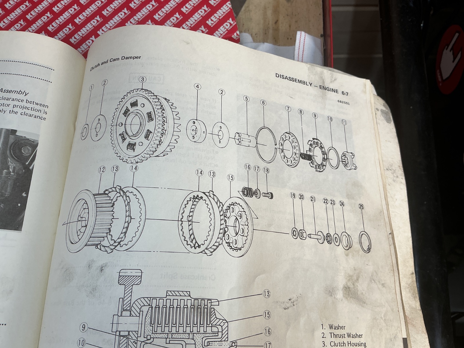

Re: Gpz1100 clutch
04 Mar 2026 10:30
I have changed the rubbers on my lc when I replaced the basket,i think the springs are instead of rubbers,
fyi I don’t think the drawing in the manual is the same as my clutch theres no mushroom (pushes the pressure plate)on mine like in the drawing
