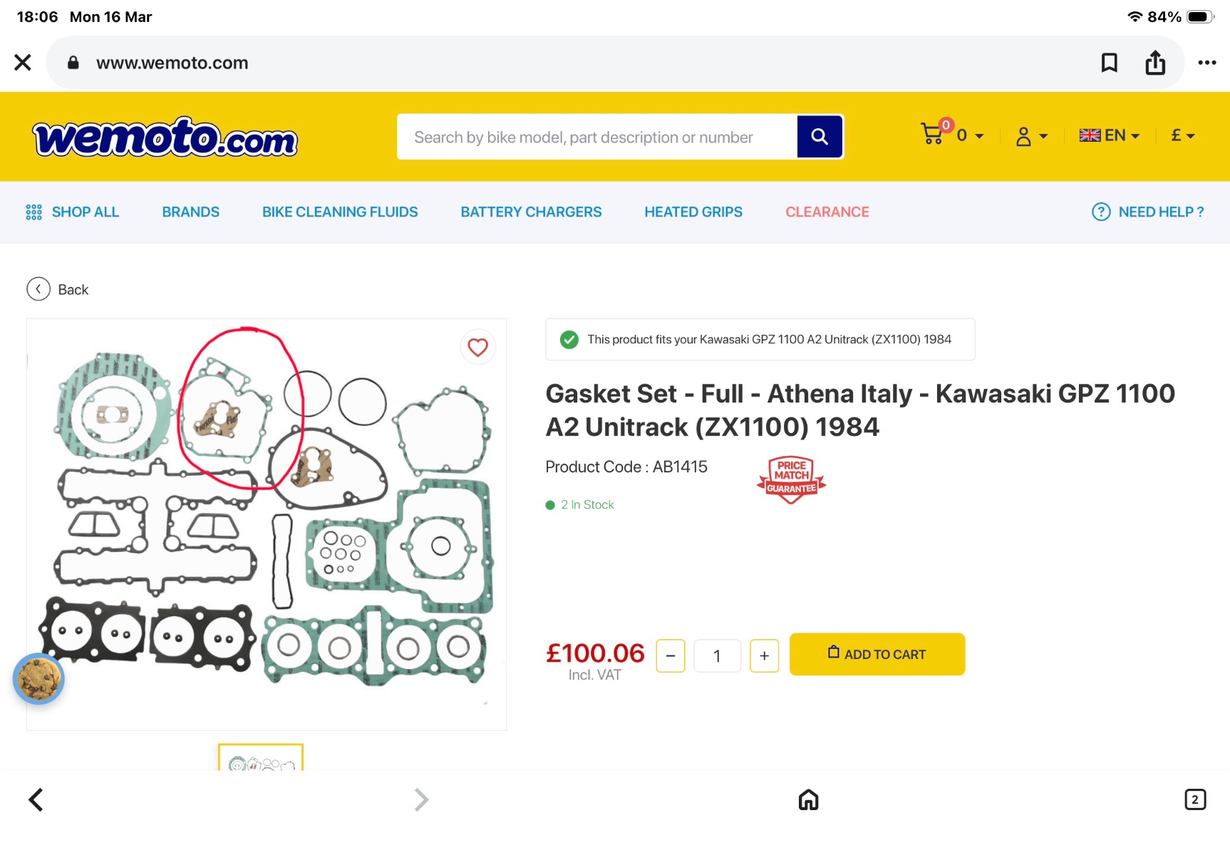

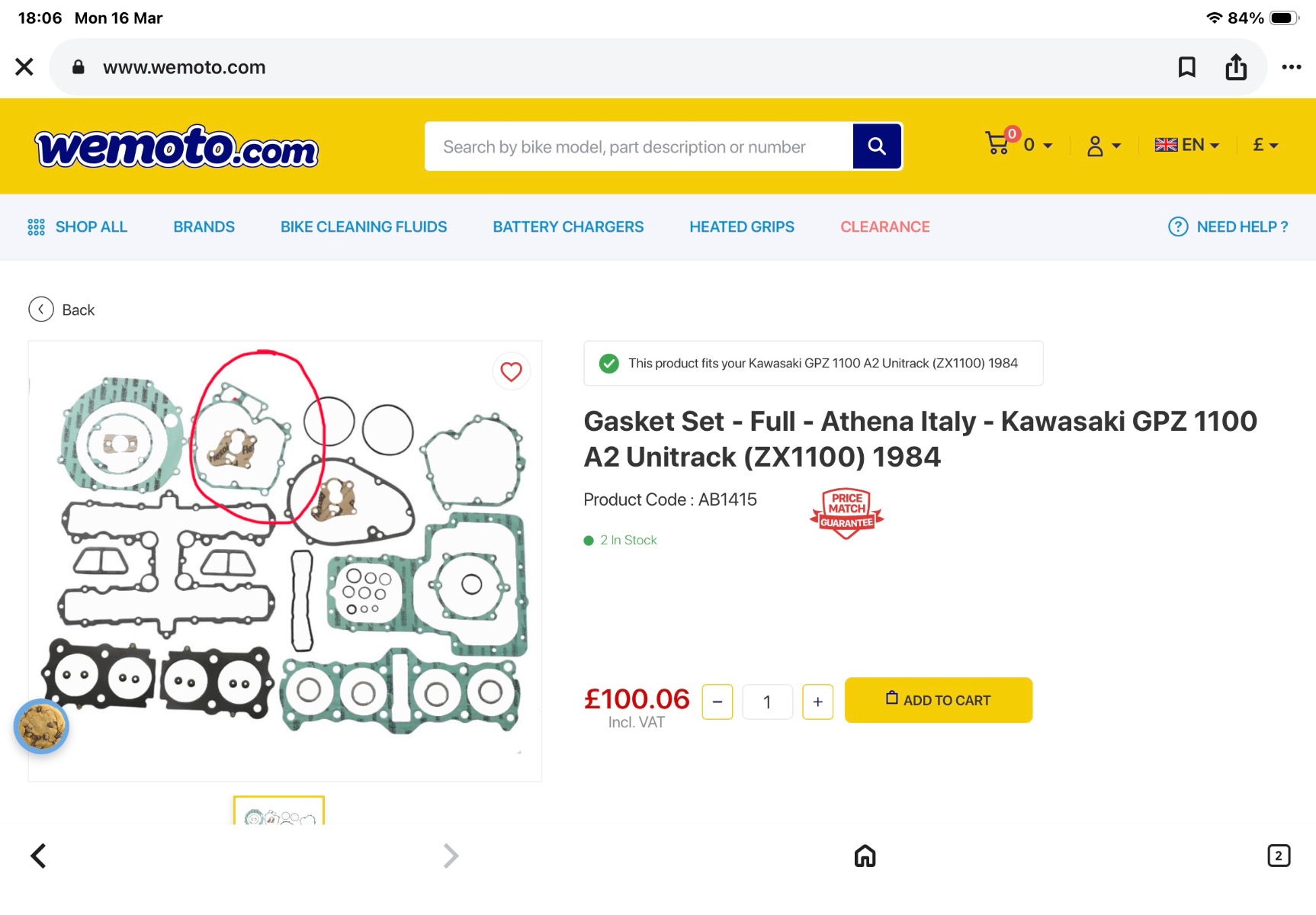

I’ve another question there seems to be a hole missing on my transmission gasket is this normal
red dot inside red circle

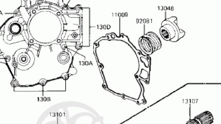

The one under the little red heart is the right one for yours (I have no idea about the one you have circled - maybe shaft drive ??)
EDIT: KZ1100 shaft drive bevel gear housing
