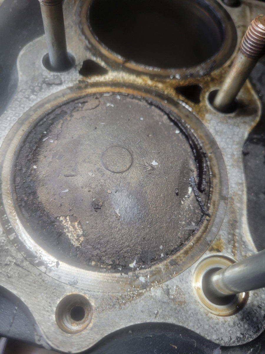

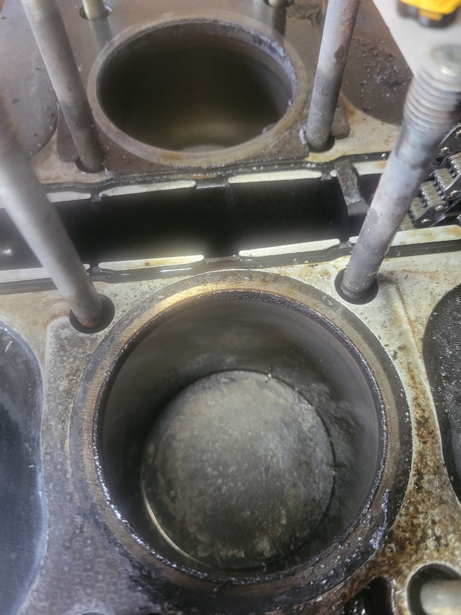

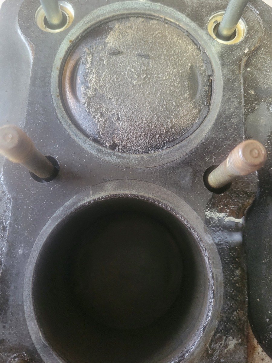

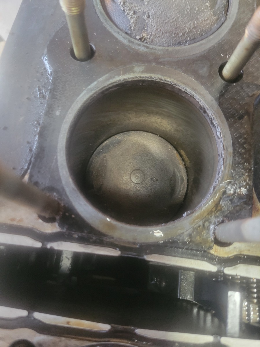

Okay I took the top half of the engine off I had a oil leak
I knew there was a problem with all the soot coming out from the reeds
no the barrel cylinders all are beautifully nice and smooth no scratches nothing the bottom of the piston looks brand new or I'm on all of them but the problem is I'm trying to figure out why I got so much carbon buildup on top of the Pistons I don't have a picture of the valves under the head but you can imagine what they look like by looking at these pictures of the Pistons

That's not at all bad. Looks pretty normal. If it were bad it'd be black and thick with soot.
Give it a decoke and reassemble.

Looks normal to me. Change your valve seals and clean things up.
