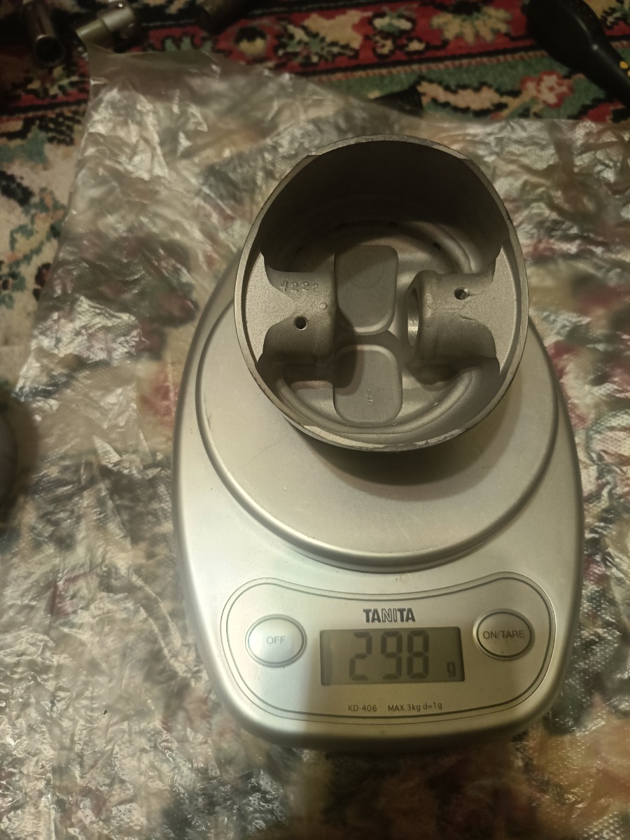

And here is the 83mm piston
I don't know who made it...

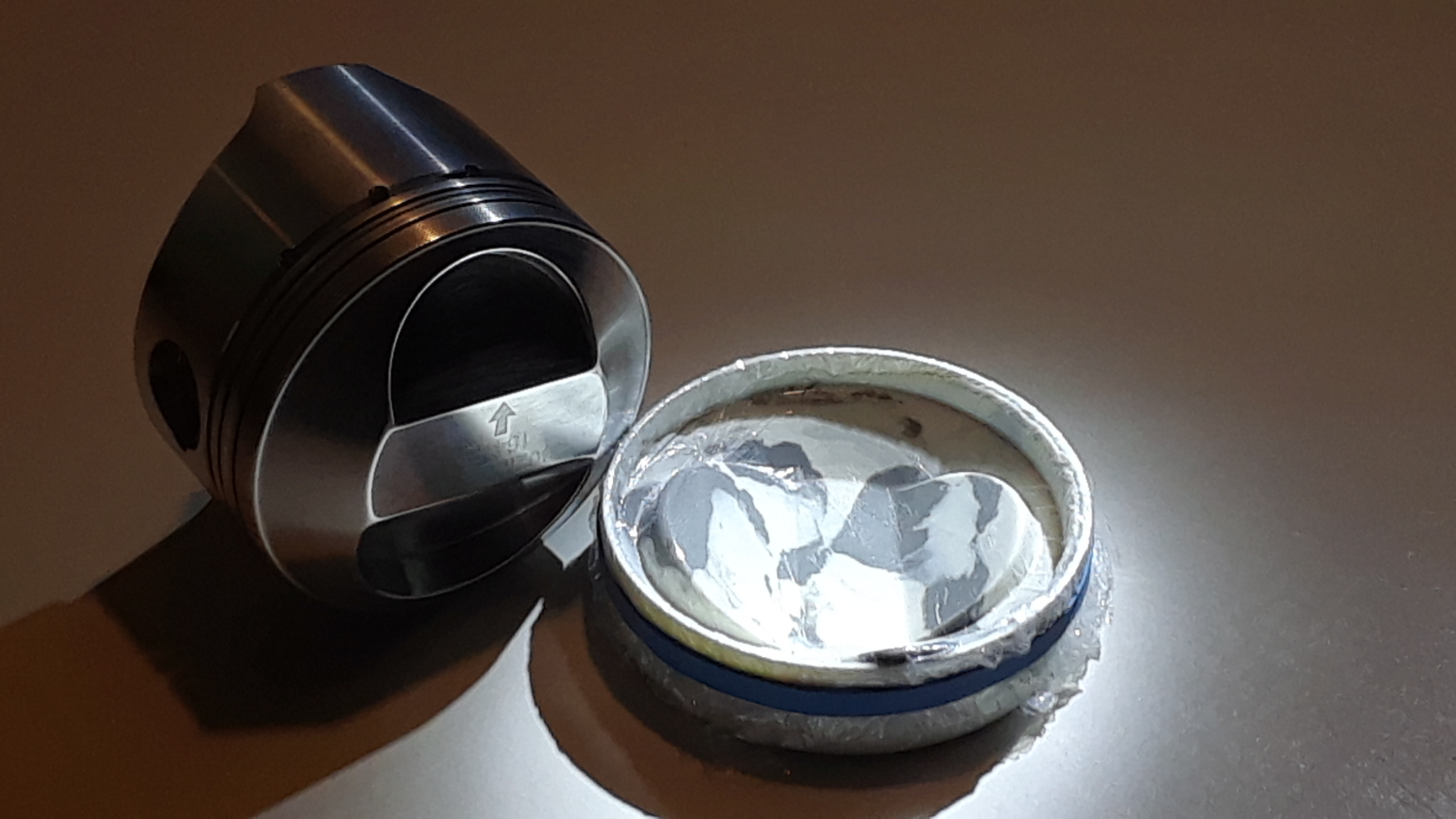

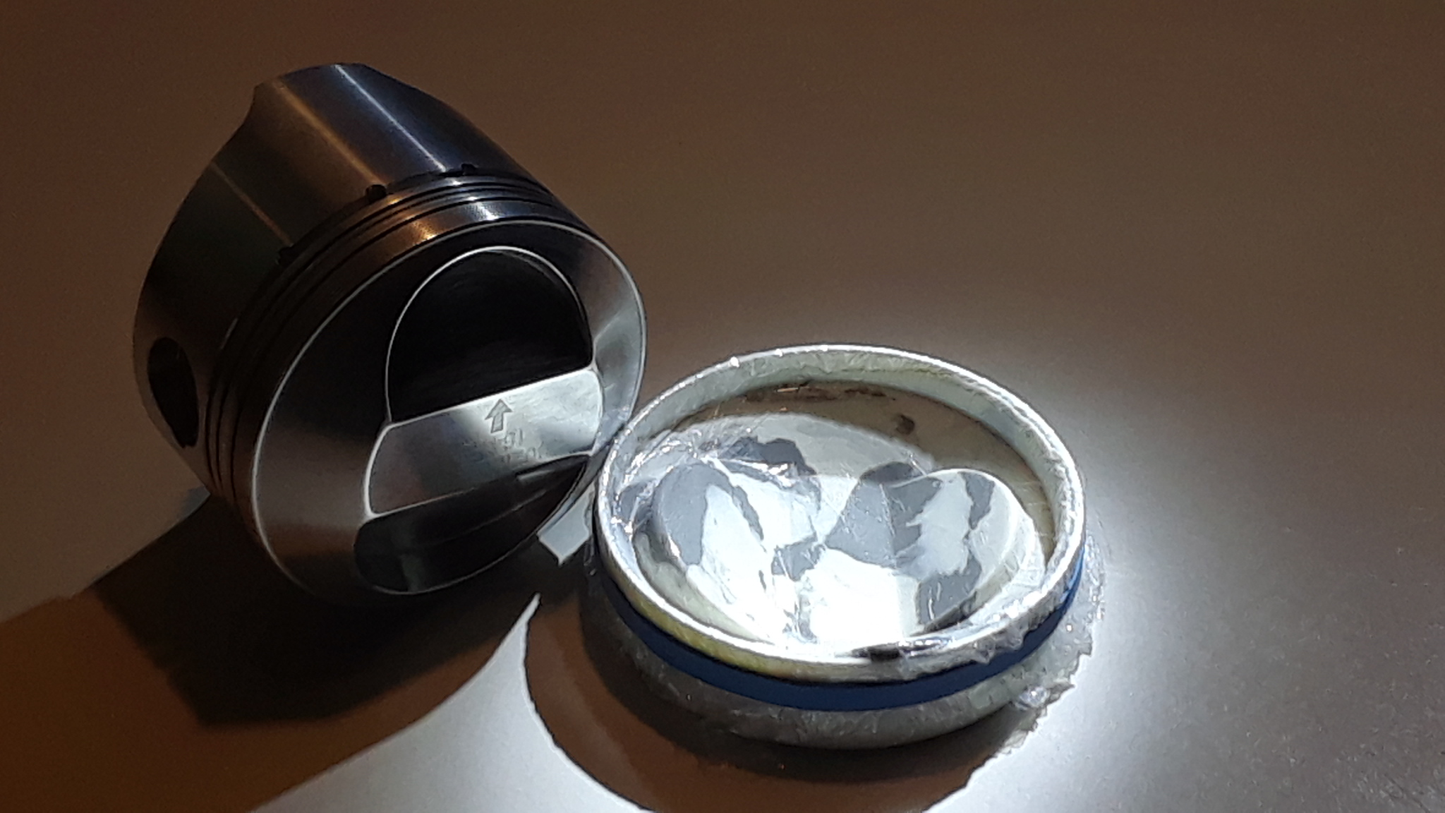

Daveo was that pic taken on a vibrating massage table - Lol
Nope, just the spinning kitchen table...
Discovered a simple measuring system.
I'll share it on the top-end...if anyone is interested
1982 KZ1100-A2/1170 sleeper 😀

Of course it's interesting!
Ok, I'll post soon...here's a segment:
photos.app.goo.gl/1VY9AUsKz4qLheoP6

Great method! Thanks!
What do you fill the mold with? Is it plaster?
You cc the mold to measure the piston crown/dome displacement.

Modeling clay is typically sold at hobby stores and is readily available on ebay.  Not much is needed, and it's reusable...
The plastic wrap provides for clean and immediate part separation.
Also, the slick barrier protects the clay and prevents it from drying out.

I tried using plasticine, but even when heated, it didn't always form a clear piston shape. I did try making a thick "pancake" without a cap-like base. In any case, I'll have to try and compare the results of pouring the piston in the block and pouring the impression.

That's right, then this impression is measured by pouring from a syringe or something else...
<Half a cup of kitchen salt, lol
photos.app.goo.gl/gVSyfzytp9PifjSo7
