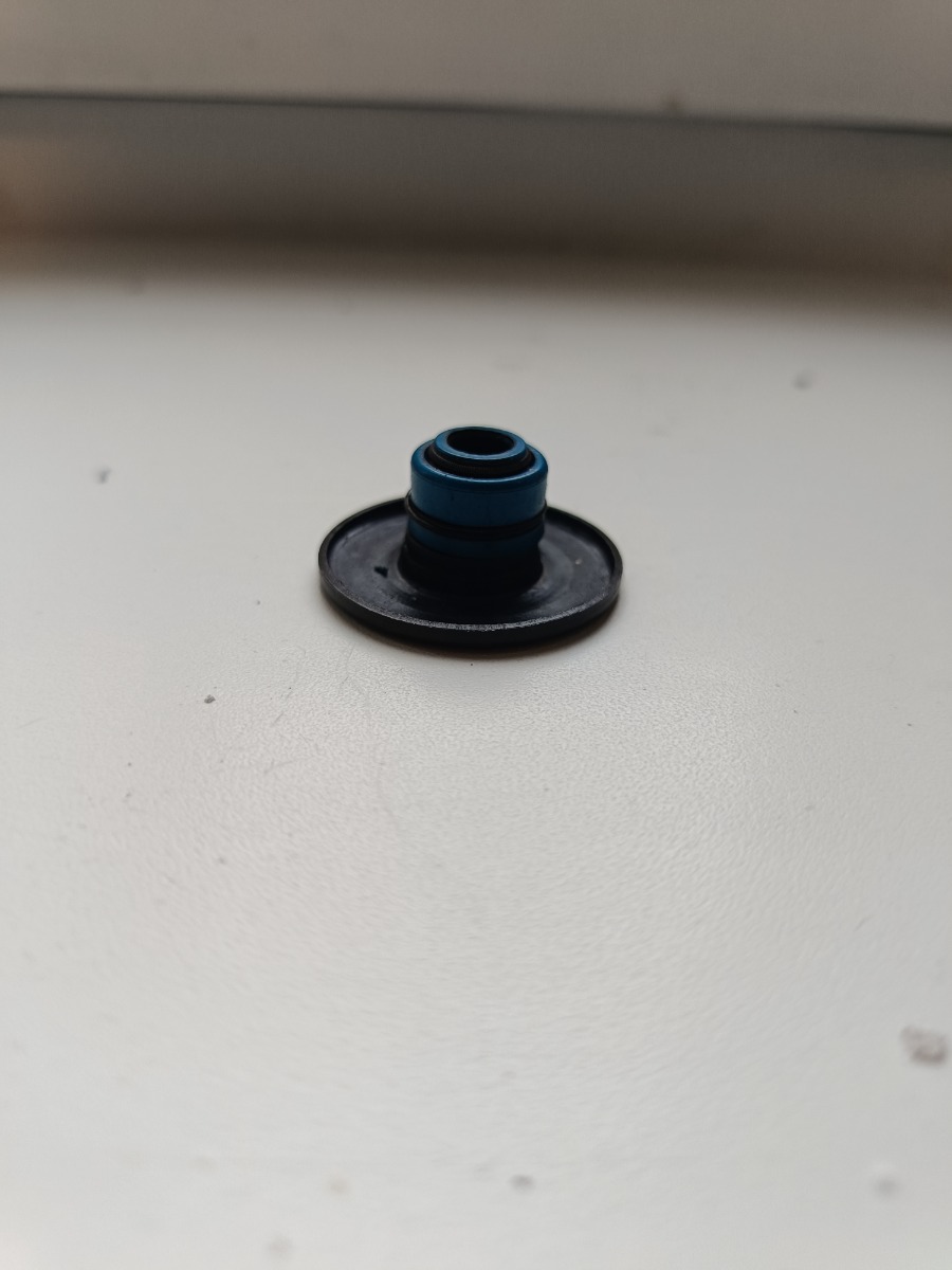

07 Oct 2025 02:40 - 07 Oct 2025 03:27I have a large 1385 cc engine and enlarged valves 40x34. I started installing 418 camshafts, but during a test fit, I found that the valve head hits the valve stem seal at maximum lift. Without the seal, everything is fine, the gap between the valve head and the guide is about 1.5 mm. Has anyone encountered such a problem? I'm writing through a translator, sorry.

Which valve guides do you have fitted ?
After market guides such as APE etc are shorter than stock OEM to prevent your issue.

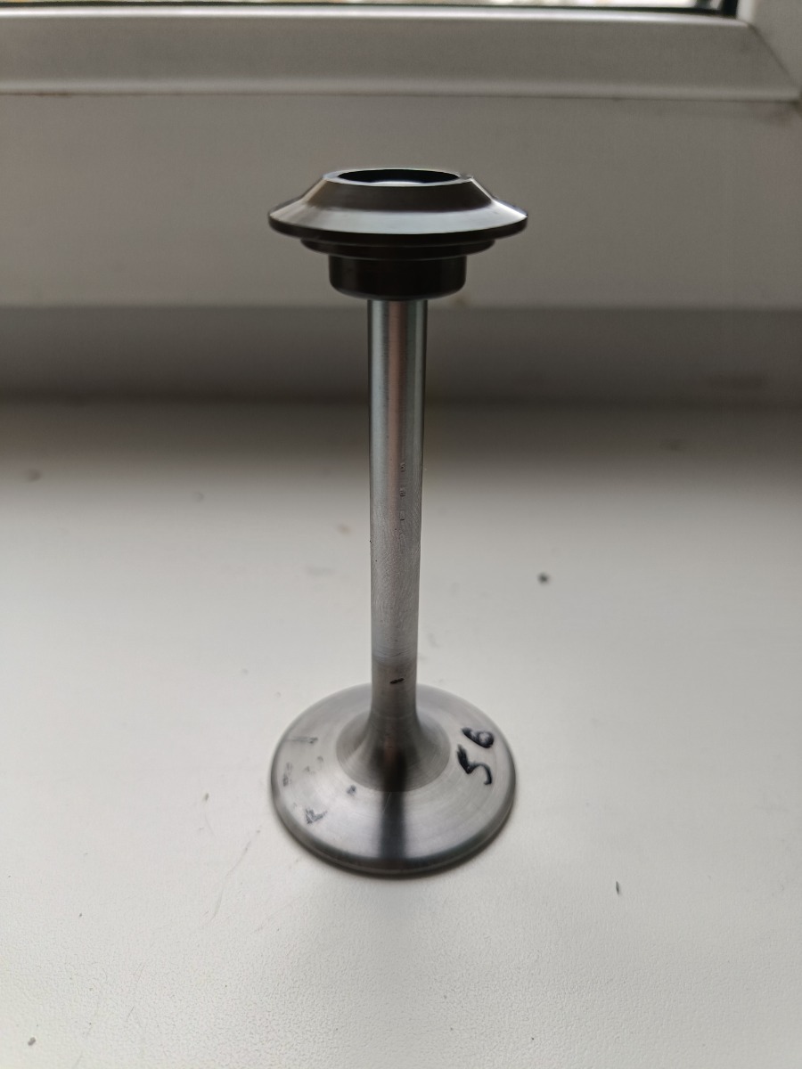

Yes, the margin between the cap and the spring support plate is quite large, more than 5 mm for sure. I agree. But this will not solve the problem..... If you just cut the guides and put the oil scraper caps on the glue.....

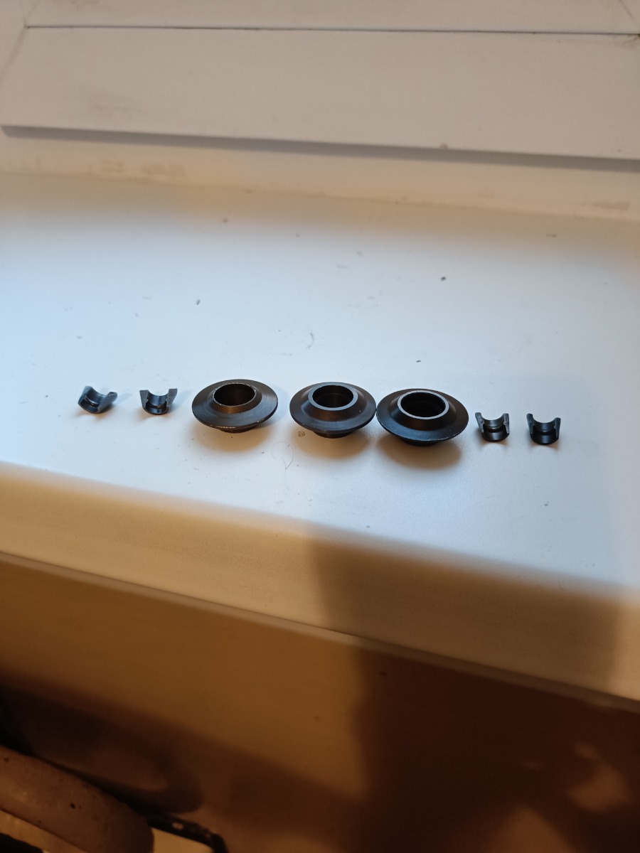

У меня титановые пластины клапанов, но они такие же, и это не ape. Я могу их обрезать, но сухари клапанов будут ниже уровня пластин. Есть также алюминиевые пластины, и они гораздо ниже, и сухари из них не торчат, но я боюсь ставить их на пружины с лифтом 440. Спасибо, я посмотрю, что есть у APE. Пластина Kawasaki, моя титановая пластина и алюминиевая пластина.

Translation...
I have titanium valve covers, but they're the same size and not APE. I can trim them, but the valve keepers will be below the cover. There are also aluminum covers, and they're much lower and the keepers don't stick out, but I'm afraid to put them on the 440 lift springs. Thanks, I'll see what APE has. The Kawasaki cover, my titanium cover, and the aluminum cover.
