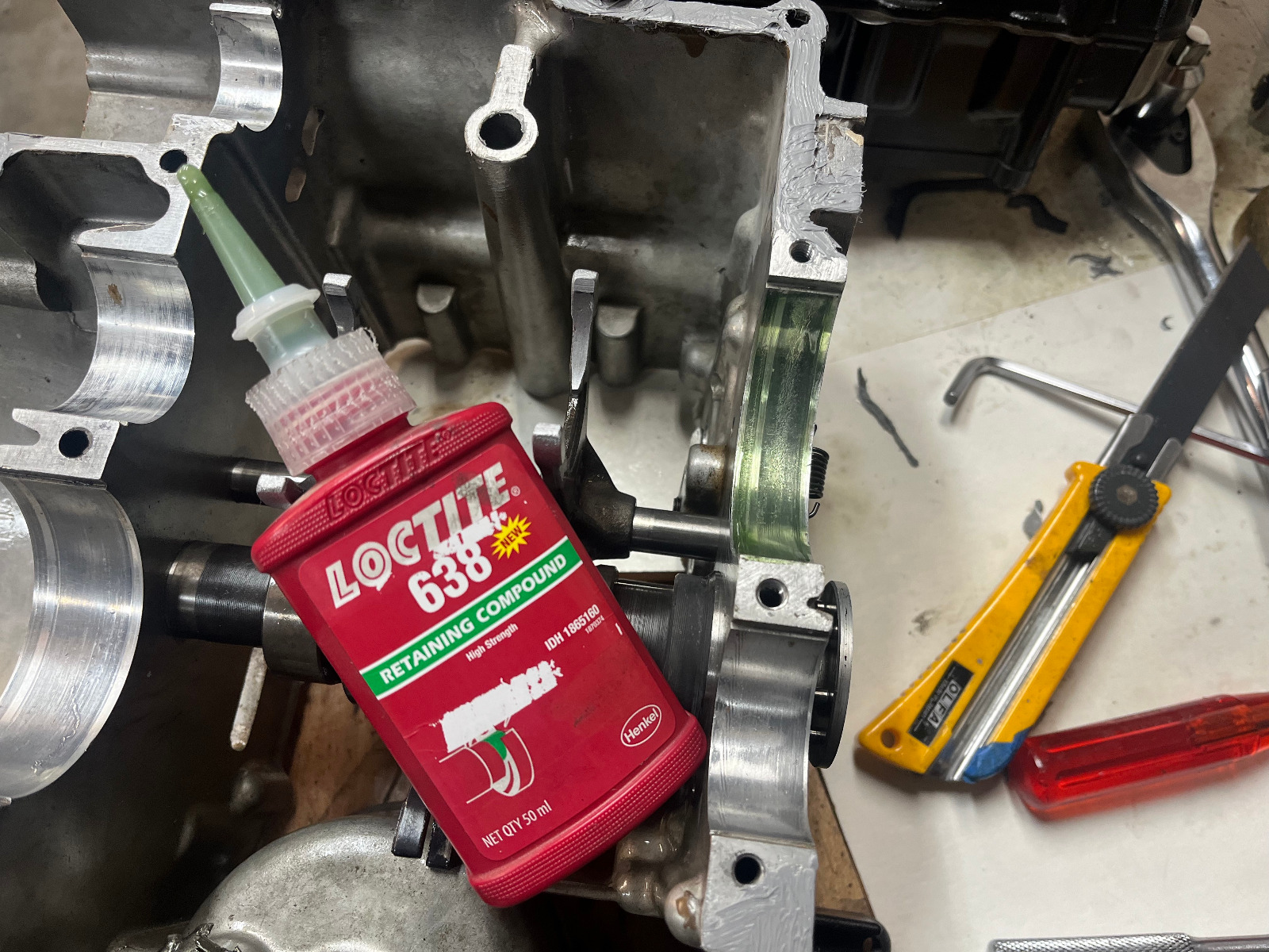

However I decided to do it the right way and pull the engine out again so i could use bearing retaining compound. You can see the brinelling in the pic. Since I had just done the process it went super fast. Engine back out, stripped, and back together in 2.5 hours yesterday. I'll put it in the frame today.
Using bearing retaining compound is the preferred installation technique for a lot of high speed spindles on cnc routers/mills. I recently rebuilt a 30k RPM spindle and I was asking the engineer why they use bearing compound rather than a press fit on the bearings and he told me it was because it increases bearing life and reduces run-out by removing any possibility of the bearing not seating 100% perfectly. This machine will hold 0.0001"+/- tolerance.
