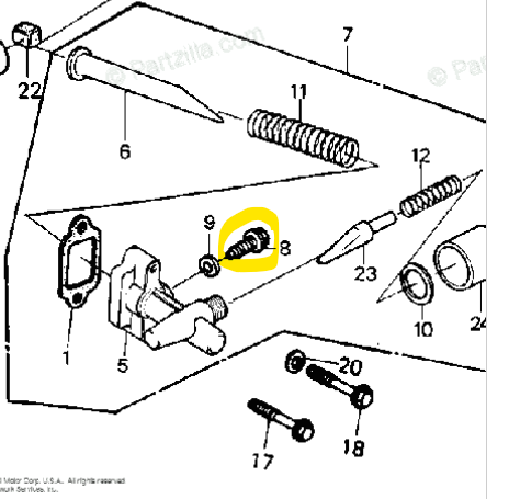

That noise is normal. The cam is going over the top of the lobe nose, then jumping forward due to valve spring tension.
Double check the valve timing, both at the crank (1-4T aligned), and the marks on the cam sprockets, and if all looks okay, put the crank at at 1-4 TDC, remove the tensioner spring, and pull back the wedge, and put the valve cover back on. Once the cover is on, put the tensioner spring and wedge back in and rotate again. The noise you are hearing should be much less, or it will be entirely gone.

27 May 2025 15:30Sorry, man, something doesn't seem right. That chain snatch should go away with the valve cover installed, and the cam chain tensioner working correctly. Did you back off the set screw after installing the wedge and spring?So I did as you mentioned above, sound is still present for sure. It seems slightly less noisy, but guessing that is from the cover being re-installed.That noise is normal. The cam is going over the top of the lobe nose, then jumping forward due to valve spring tension.

27 May 2025 15:40 - 27 May 2025 15:48Yes, I backed the set screw out. the chain isn't "hopping" on the cam sprocket anymore, but its still making the jerk/hitch motion and noise when hand cranking. You stated that was from the tension in the valve springs as the lobes pass over.Sorry, man, something doesn't seem right. That chain snatch should go away with the valve cover installed, and the cam chain tensioner working correctly. Did you back off the set screw after installing the wedge and spring?So I did as you mentioned above, sound is still present for sure. It seems slightly less noisy, but guessing that is from the cover being re-installed.That noise is normal. The cam is going over the top of the lobe nose, then jumping forward due to valve spring tension.

27 May 2025 17:20Yes, I did say that. Thing is, though, with the chain properly tensioned, and the valve cover installed, there should not be much of any noise.Yes, I backed the set screw out. the chain isn't "hopping" on the cam sprocket anymore, but its still making the jerk/hitch motion and noise when hand cranking. You stated that was from the tension in the valve springs as the lobes pass over.Sorry, man, something doesn't seem right. That chain snatch should go away with the valve cover installed, and the cam chain tensioner working correctly. Did you back off the set screw after installing the wedge and spring?So I did as you mentioned above, sound is still present for sure. It seems slightly less noisy, but guessing that is from the cover being re-installed.That noise is normal. The cam is going over the top of the lobe nose, then jumping forward due to valve spring tension.

Would it be advised that I focus on the chain tensioner? Could it be binding for some reason? I basically reinstalled it without the side wedge installed then installed the wedge. I did re-measur my valve clearance after the shim installs and the numbers are better now. More toward the max clearance then the low end. As for the timing, I getting really good and setting the cams and the chain now. I feel I am so close to restarting, but having doubts. I do plan on going back through the carbs tonight with some carb brushes/wires as you have stated in the past. I figured with them off the bike might as well.

03 Jun 2025 17:20So tonight I pulled the plugs and hand cranked still hearing that clunk. Pulled the tensioner wedge and hand cranked, no clunk. Still no idea how to fix this.Start up after timing can be nerve wracking but as long as rotate several times by hand with the plugs out (so you can better feel any resistance) and then re-check the chain tension you will be "good to go"

04 Jun 2025 07:39 - 04 Jun 2025 07:40Thanks Wook. I do have one of those already. Being that the sound goes away with the tensioner wedge remove and comes back when installed seems to point that it is in fact something with the tensioner, but what it is eludes me. Its not like their is much to to it. The Wedge pushes on the tensioner plunger which pushes on the pivoting chain guide inside the motor to keep the correct tension on the cam chain. I even put a bore scope camera down inside, but couldn't really tell what I was looking at.You might want to invest in a mechanics stethoscope (around $10 on Amazon) this will help pinpoint where the noise is coming from

if you poke your finger in the tensioner hole (carefully) to apply pressure to the chain and rotate manually does it still make a noise ? (this should prove or eliminate the tensioner as the source of the noise)
