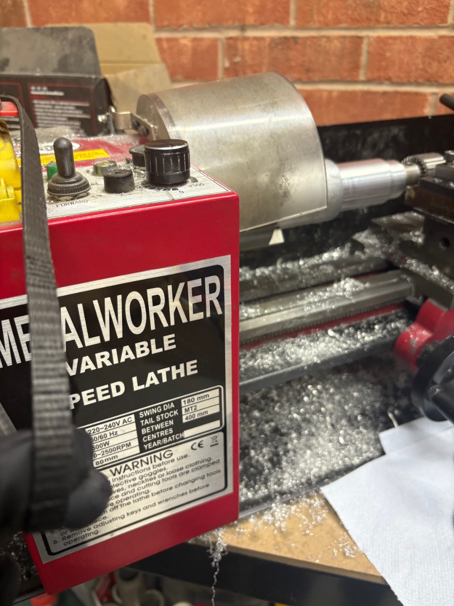

Thanks for the advice Joe, it has been a steep learning curve of "have a go" and "U-Tube video's" to work out how to use it. Once this project is finished I will be giving it some attention as I am sure a few of those plastic gears have been to the dentist as a result of my "heavy handedness" (it's a little noisy !!) and also it came with a "tapered bearing" upgrade for the spindle that hadn't been fitted so I can do that as well

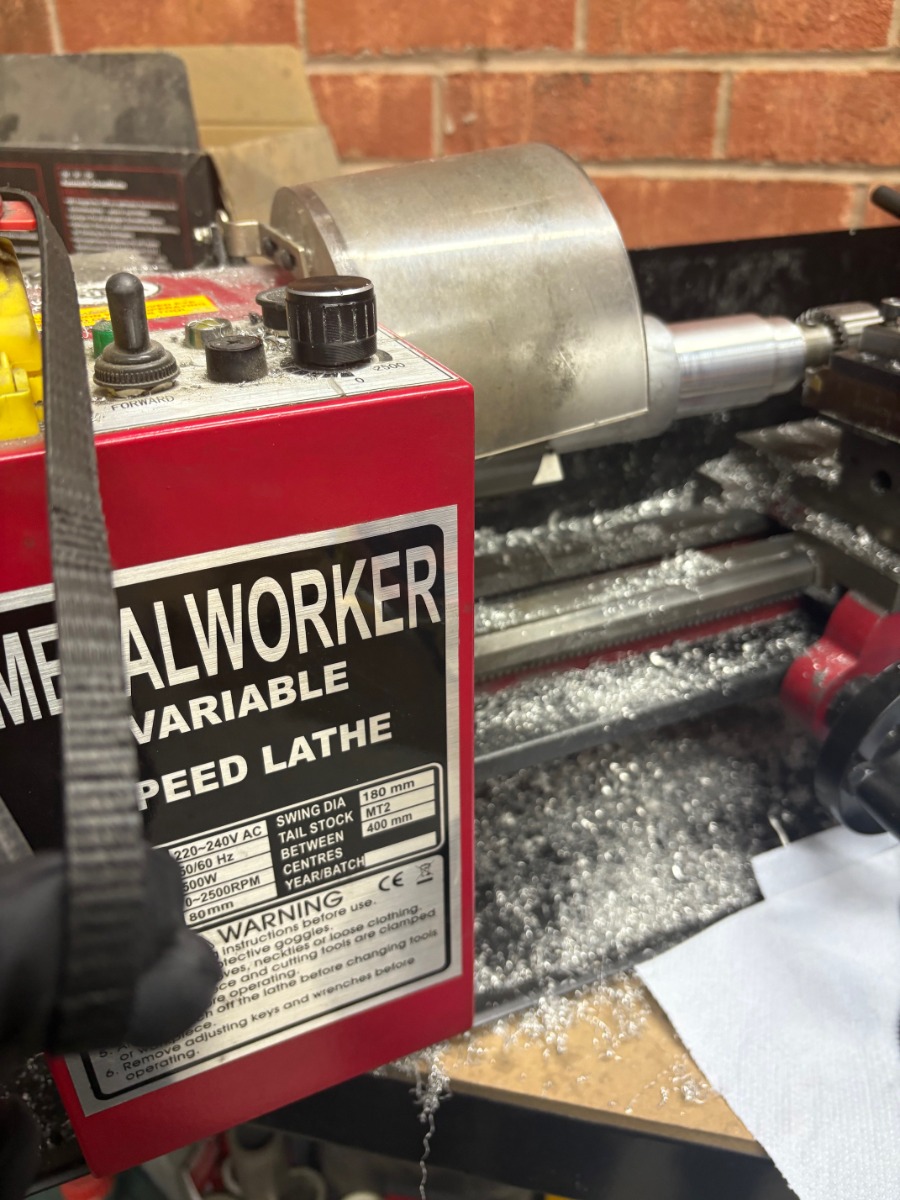

03 Aug 2025 10:44Looks like my lathe has different idea !!!! it's decided not to wait until the project is finished. I was trying to cut my engine mounts today but it was getting worse (hardly a surprise as it turns out) Entirely my fault and lesson learnt, on the upside all the plastic gears are perfect. When I bought it I just set it up and away we goĀ - turns out it's belt drive (which I didn't know) and as a result of lack of maintenance the belt is completely stripped of it's teeth. I got on the website you recommended but the belts are back ordered for 11-12 weeks which isn't helpful. Luckily I found a supplier of generic drive belts that have the correct length, pitch and width so should be back in business in a couple of daysThanks for the advice Joe, it has been a steep learning curve of "have a go" and "U-Tube video's" to work out how to use it. Once this project is finished I will be giving it some attention as I am sure a few of those plastic gears have been to the dentist as a result of my "heavy handedness" (it's a little noisy !!) and also it came with a "tapered bearing" upgrade for the spindle that hadn't been fitted so I can do that as well

Go to the Aliexpress website and search for C3 mini lathe. You'll find steel belts and sprockets much cheaper.
I have a mini lathe like this one, and I got a complete set of steel pinions and a set of pulleys. I also changed the spindle bearings.

That's the cheapest problem you can have with it...and the cheapest solution to fix it! - Be glad it wasn't more serious damage!!
