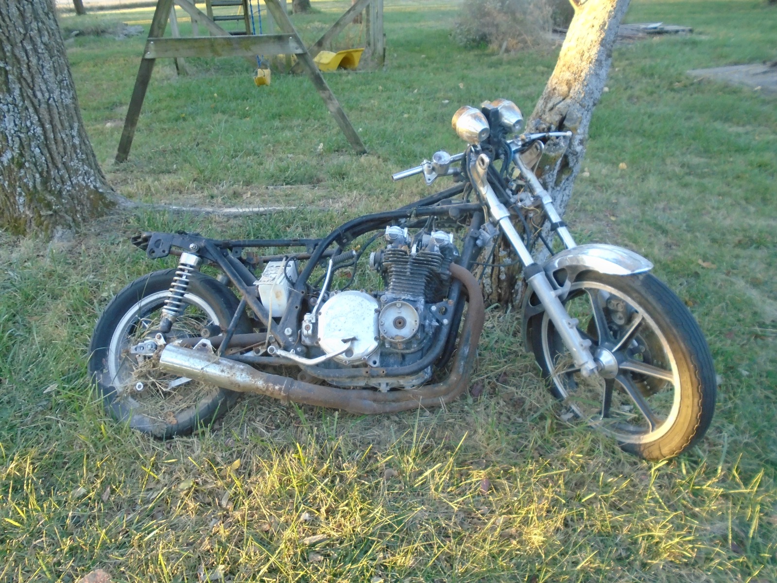

Joe, spare engine you say, do i have a deal for You! KZ1000 "spare" engine on a rolling dolly of crappy/cracked KZ900 frame. Just have Jeeves heat-up the hot air balloon and fly on over to pick-it-up. See you in a month, haha.
The following user(s) said Thank You: MFP-Joe, Gdizard, kimchella
- Posts: 5918
- Thanks: 3705
Re: Cylinderhead for "Reserve"
01 Apr 2025 05:01I could do something with that Clay but at $1500 for shipping !!!Joe, spare engine you say, do i have a deal for You! KZ1000 "spare" engine on a rolling dolly of crappy/cracked KZ900 frame. Just have Jeeves heat-up the hot air balloon and fly on over to pick-it-up. See you in a month, haha.

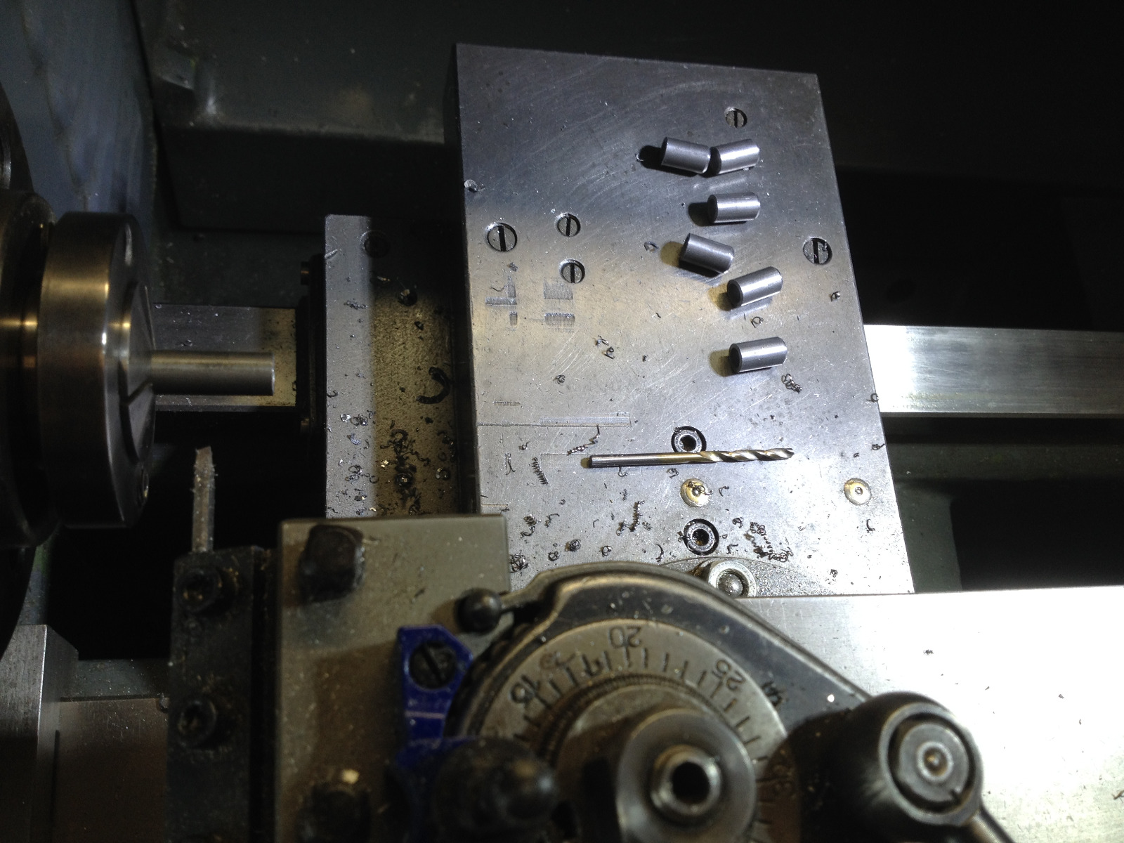

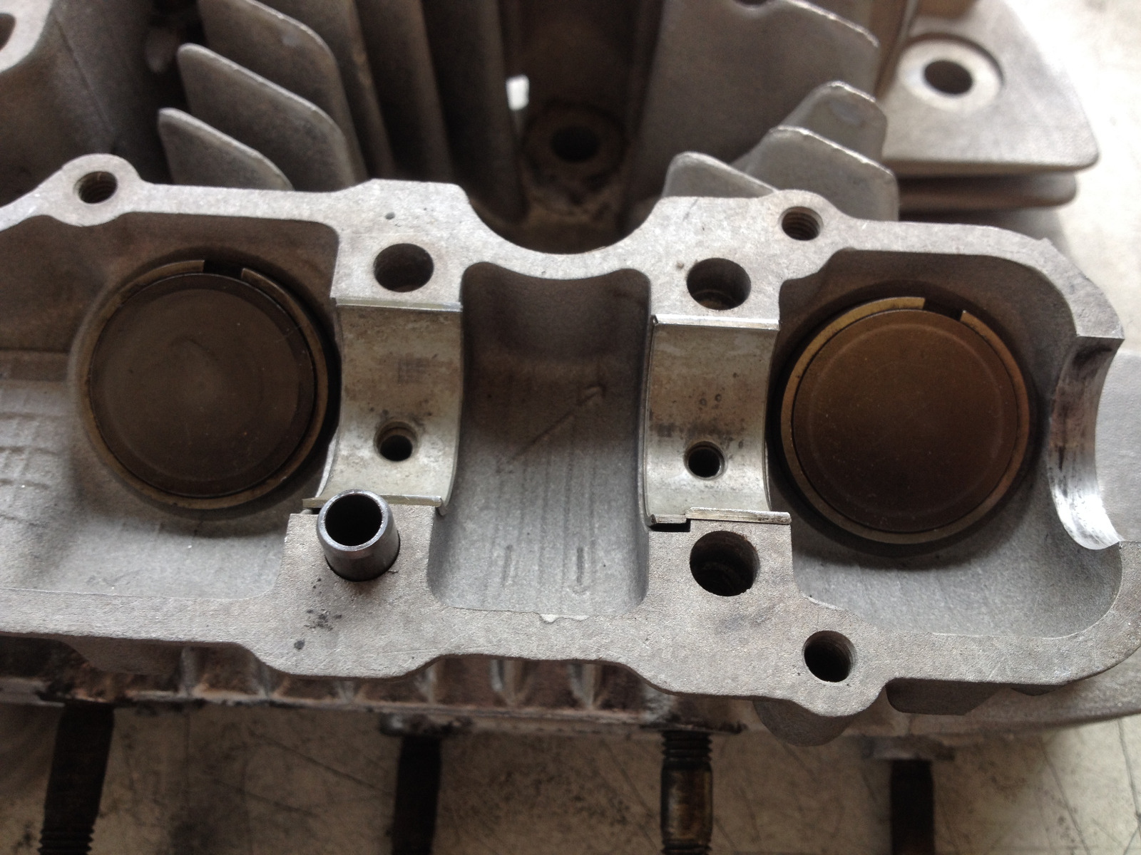

This morning, I quickly made the 8 guide bushings for the camshaft bearings:
(The guy I bought the head from lost all 16 screws and the 8 bushings...).
(When I make such relatively thin-walled and small bushings, I always convert my lathe to a collet chuck to ensure that the roundness or dimensional accuracy of the bushings is not compromised by any "squashing" or compression!)
I used 8x1 mm precision steel tubing for this, which has exactly the same dimensions as the original bushings. It's important that the upper end of the bushings also has a fine outer radius so that the bearing blocks can be easily guided onto them!
Then I cut them to a length of 14 mm, deburred them, and they're done. Fits like a glove....
