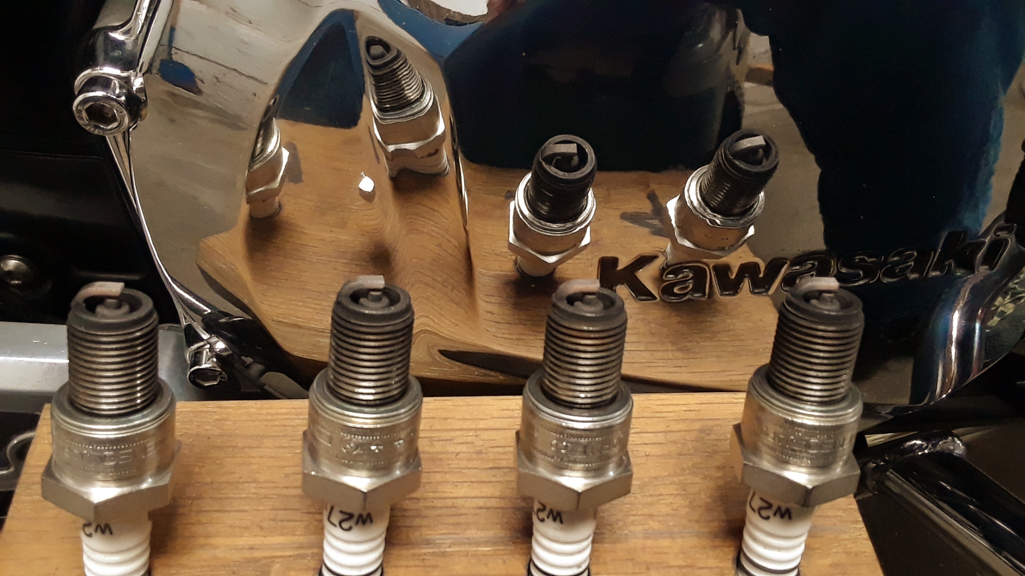

Do the spark plugs pictured below show evidence of oil consumption?

They look good but the uneven compression is suspect. Maybe some nice LONG rides?

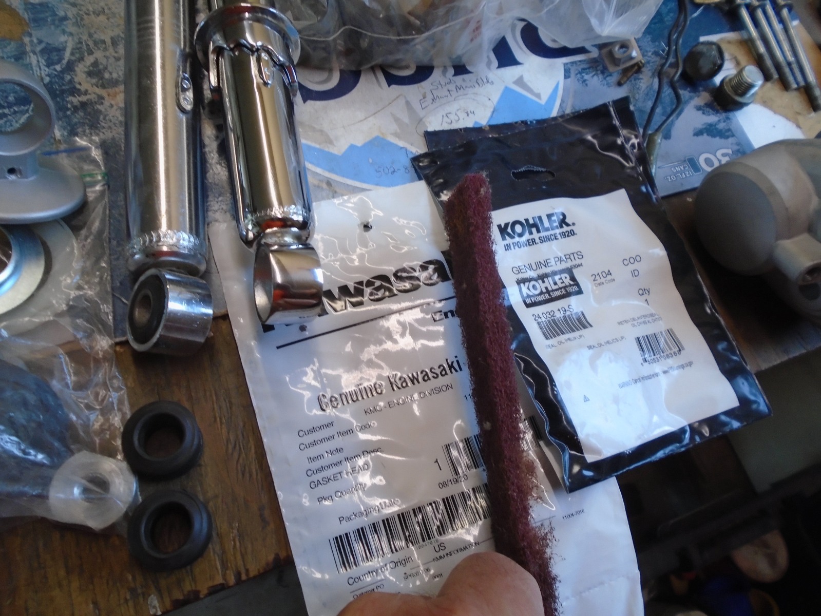

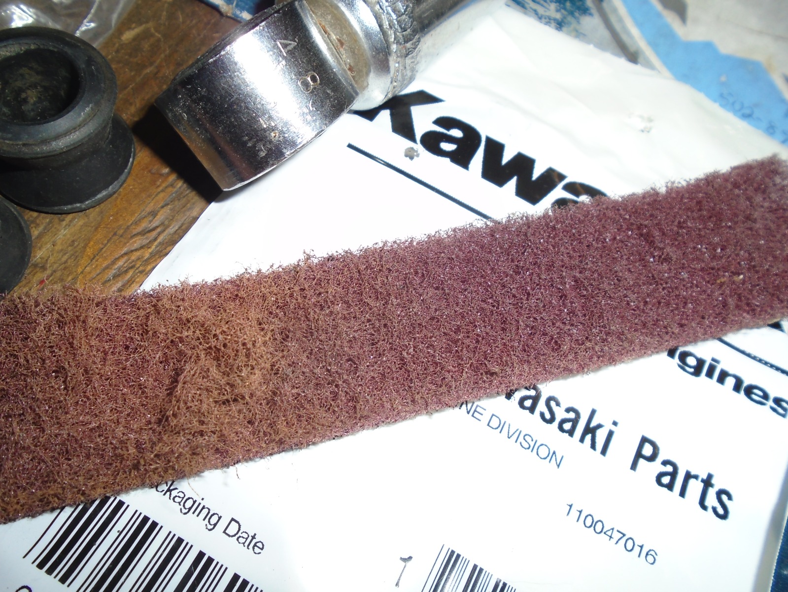

But Wookie that's where all those entertaining videos of "runaway" diesels stem from, ha. Everyone runs away, scared of flying components. Got to thinkin? That filter material isn't going to survive in that environment very long before turning to mush. Here's "kinda" what you want if you were to pursue this train of thought. Although keep in mind Fully, this shouldn't be happening in the first place if you're getting puddles of oil out the airbox lower vent holes. This shown is just a strip of scotchbrite pad and it's even too fine grained.

I would be afeared of that Scotchbrite stuff dropping abrasive into places it does not belong.

Me too Tex, that Scotchbrite was just to represent a more desirable material density, not application. They make material even more porous designed for this purpose but i wouldn't know where to get it in such large sheets? Good Luck DaveO!!
