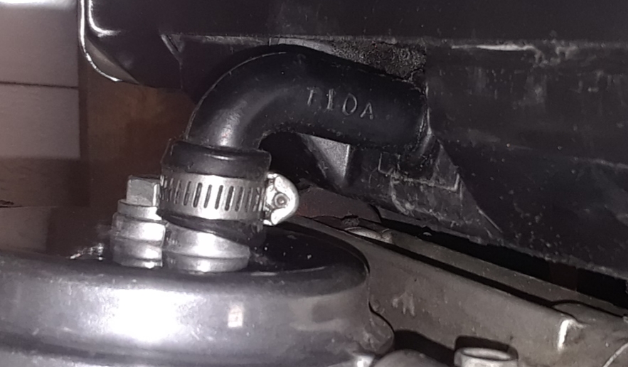

Was finding oil puddling in the bottom of my air box...
It was coming out the rubber hose that connects the breather cover to the air box, and making a bloody mess...
Is that a common issue with the big fours?

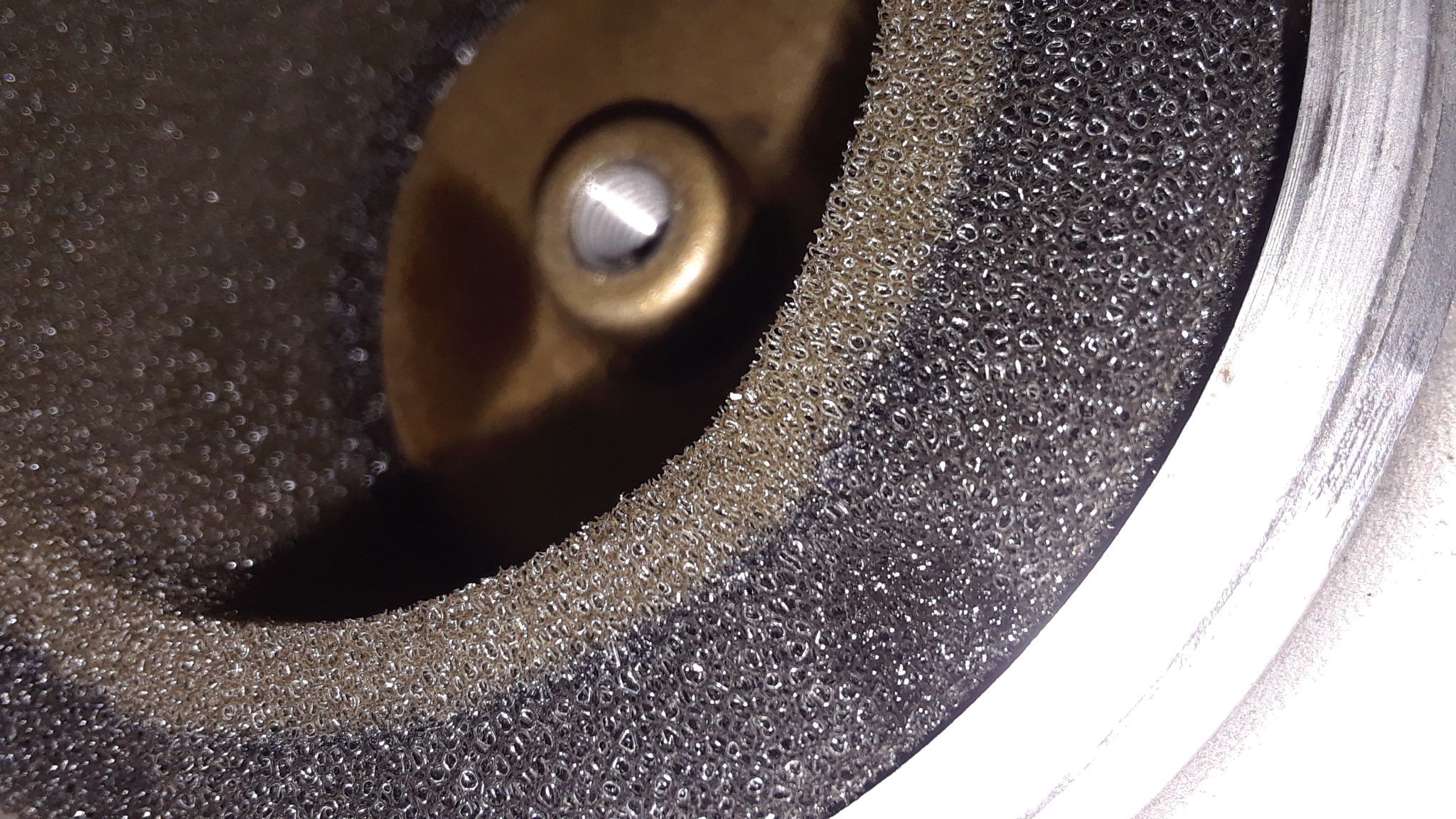

Been using Rotella 15W40 T4...
Wasn't finding much oil, but residue buildup over the span of several 5-8k rpm rides.
This stopped that completely:
...and there are no oil leaks anywhere on the motor!
Dry as a bone!

Yes, and it performs much better than expected.
It's a strip cut from a sheet of RamAir filter media I acquired nearly ten years ago.
It may be similar to the material used in their product offerings today.
