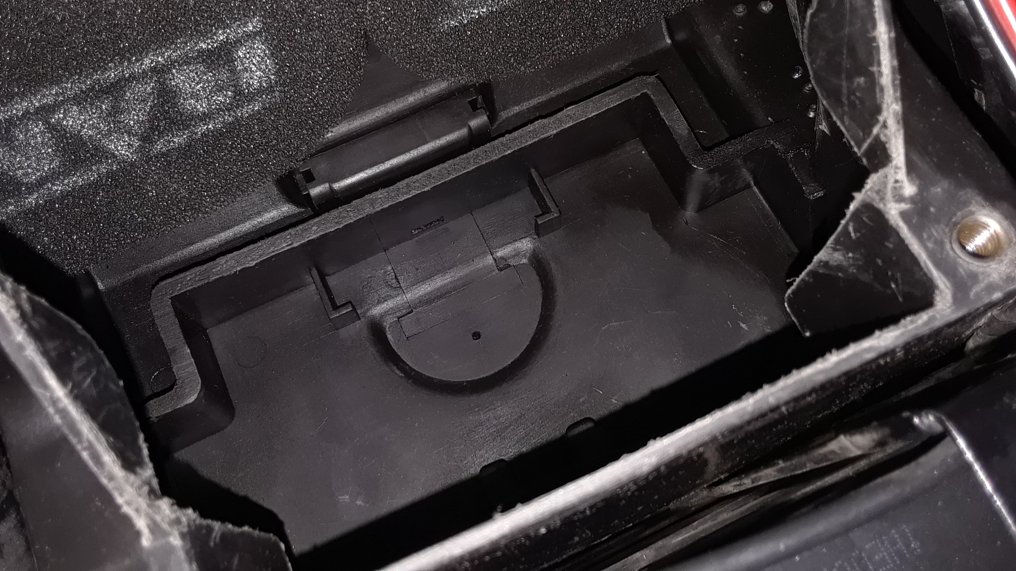

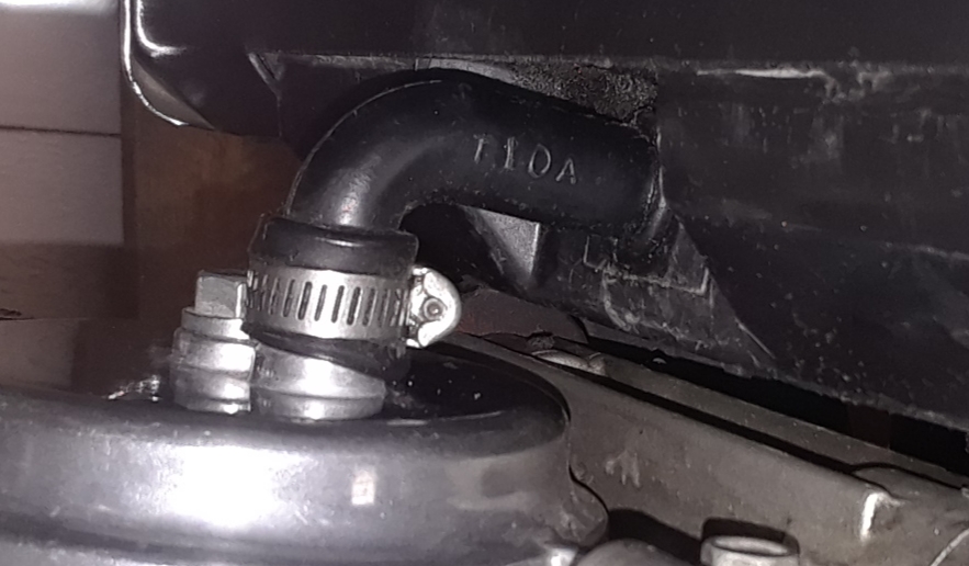

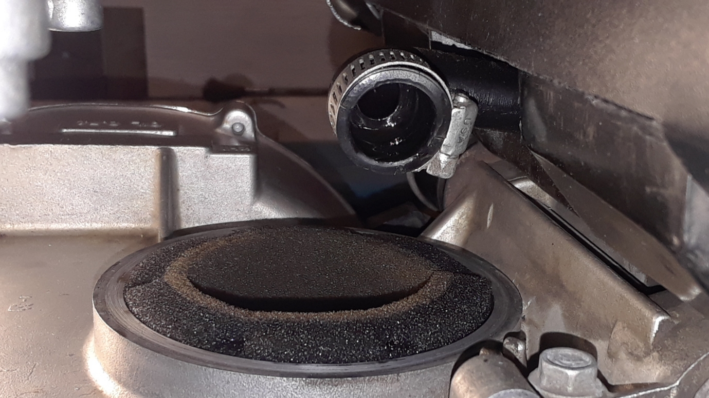

Was finding oil puddling in the bottom of my air box...
It was coming out the rubber hose that connects the breather cover to the air box, and making a bloody mess...
Is that a common issue with the big fours?

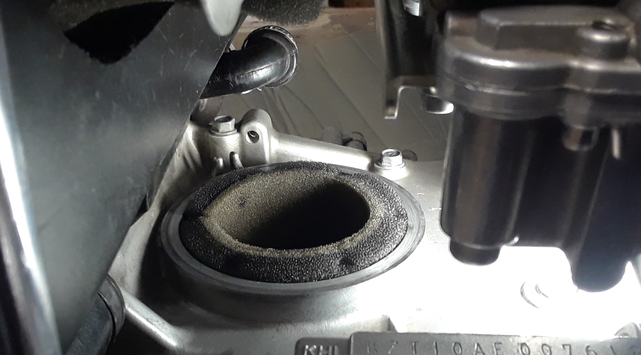

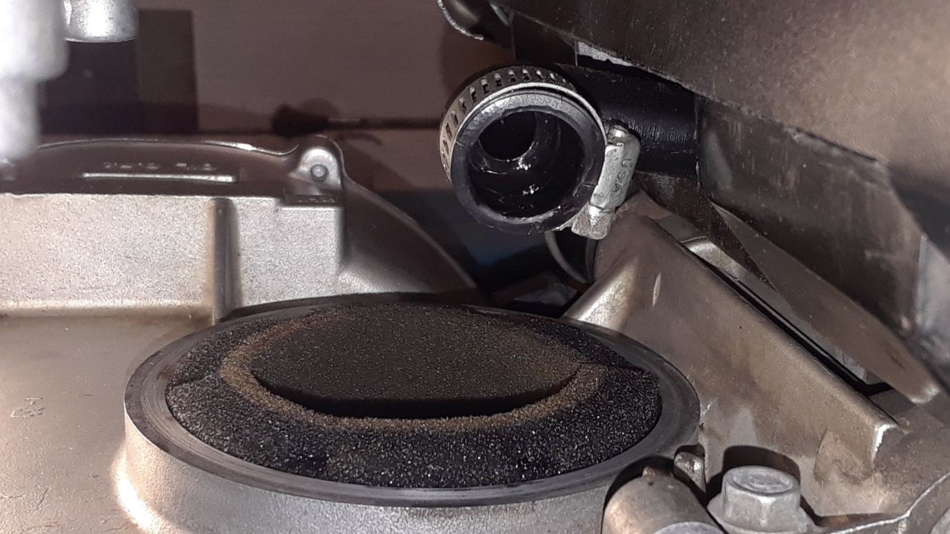

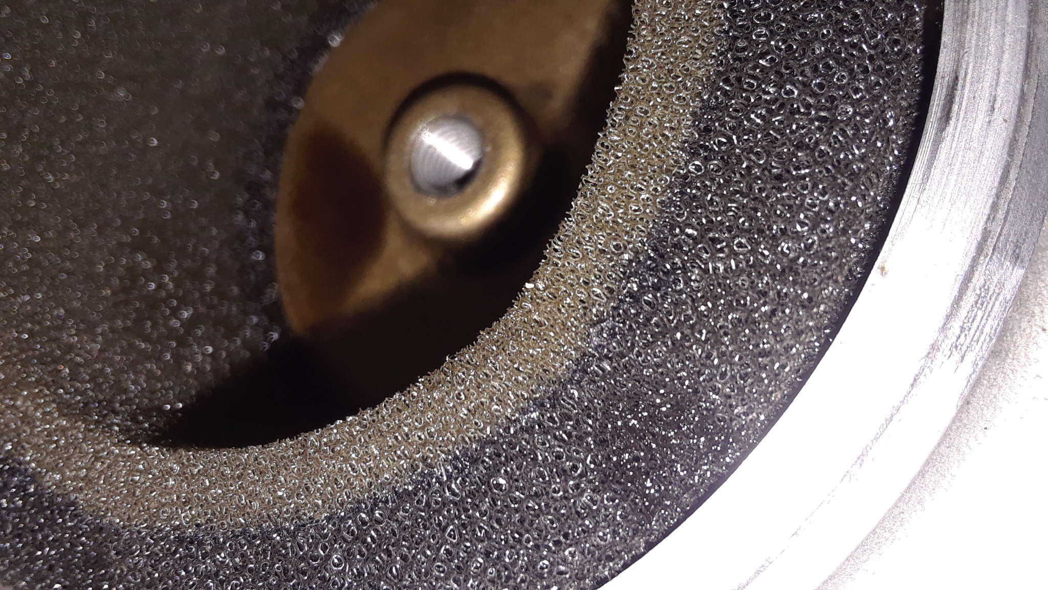

Been using Rotella 15W40 T4...
Wasn't finding much oil, but residue buildup over the span of several 5-8k rpm rides.
This stopped that completely:
...and there are no oil leaks anywhere on the motor!
Dry as a bone!
Dry as a bone!

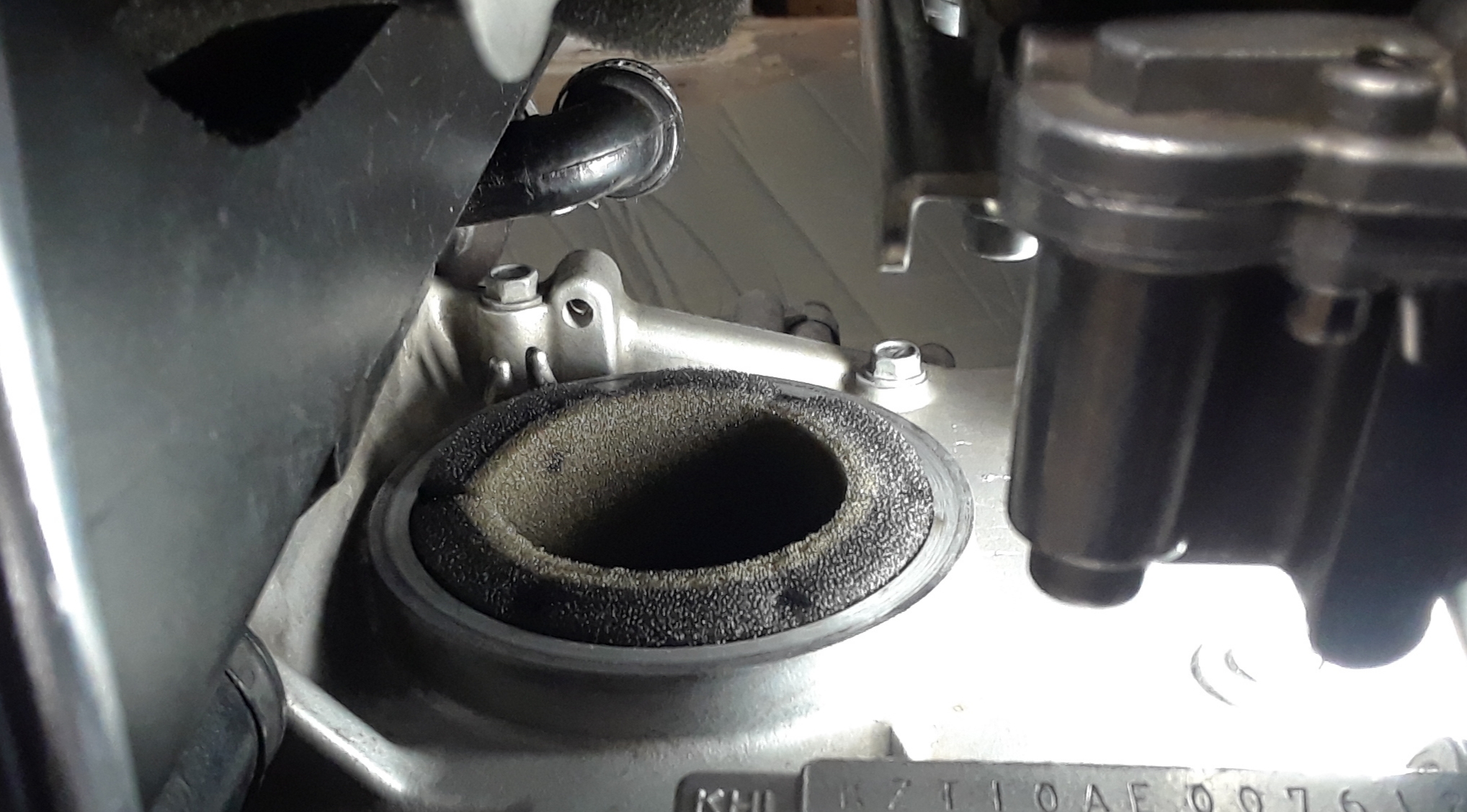

07 Jul 2024 04:37Love that solution Dave, is that "ram air" filter foam or something similar that won't cause a pressure build up??
- daveo
- Posts: 3195
- Thanks: 913
Re: Oil in the Air Box
07 Jul 2024 06:14 - 07 Jul 2024 06:18
Yes, and it performs much better than expected.
It's a strip cut from a sheet of RamAir filter media I acquired nearly ten years ago.
It may be similar to the material used in their product offerings today.
Â
Â
