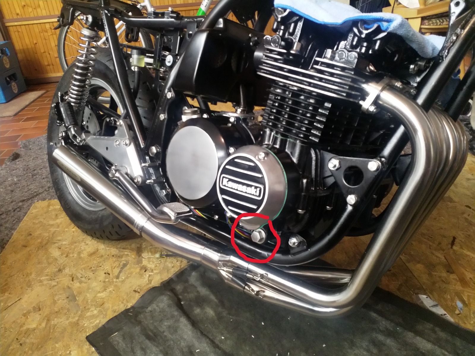

Had the same problem on my 750H last year. Stopped the bike immediately and took the timing cover off. Turned out the timing plate was pressing against the lead and grounding it - I wasn't careful enough when I put everything back together. Took the plate off and moved the wire out from under it and had no more problems. Still put the pressure gauge on when I got home to double-check though. The pressure gauge can be screwed in to the side of the crankcase (where the plug is in the picture below). Putting it in instead of the pressure switch won't work as you won't be able to mount the timing plate.
