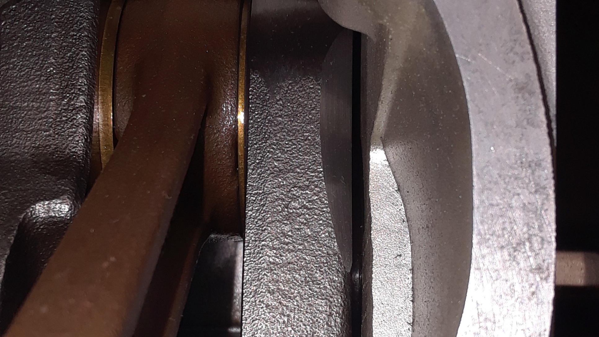

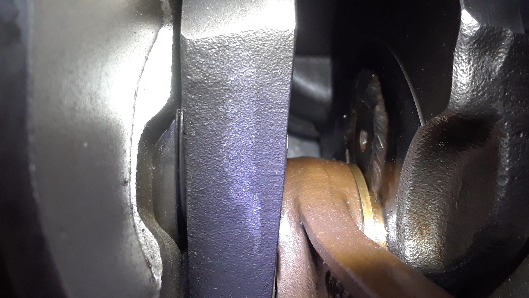

04 Feb 2024 15:26 - 04 Feb 2024 15:26So are you implying that this is a common issue and these things get ridden like this many thousands and thousands of miles without issue?
The pictured crank installation has .090"+/- gap at every similar location measured across it's width, and it has no side to side movement that I could detect.

04 Feb 2024 18:22It all looks quite new and and im assuming your retaining pins and thrust hardware are all nice and intact. So this outcome is.... expected? or are those .090 gaps not supposed to be there? I dont mean come off rude, I'm new to these engines and have lots to learn.The pictured crank installation has .090"+/- gap at every similar location measured across it's width, and it has no side to side movement that I could detect.
I'm sure mine will have wear marks and some when i finally get it opened up.

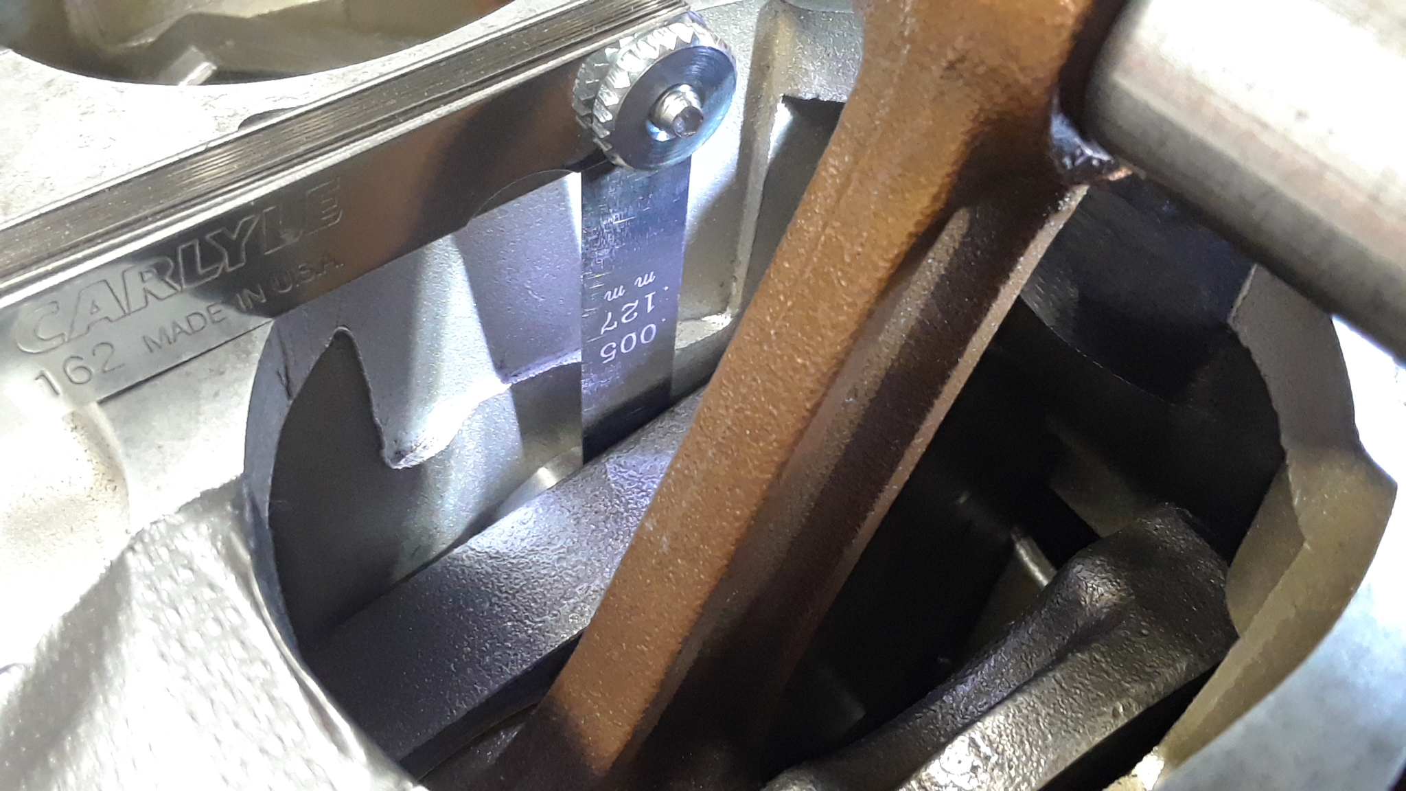

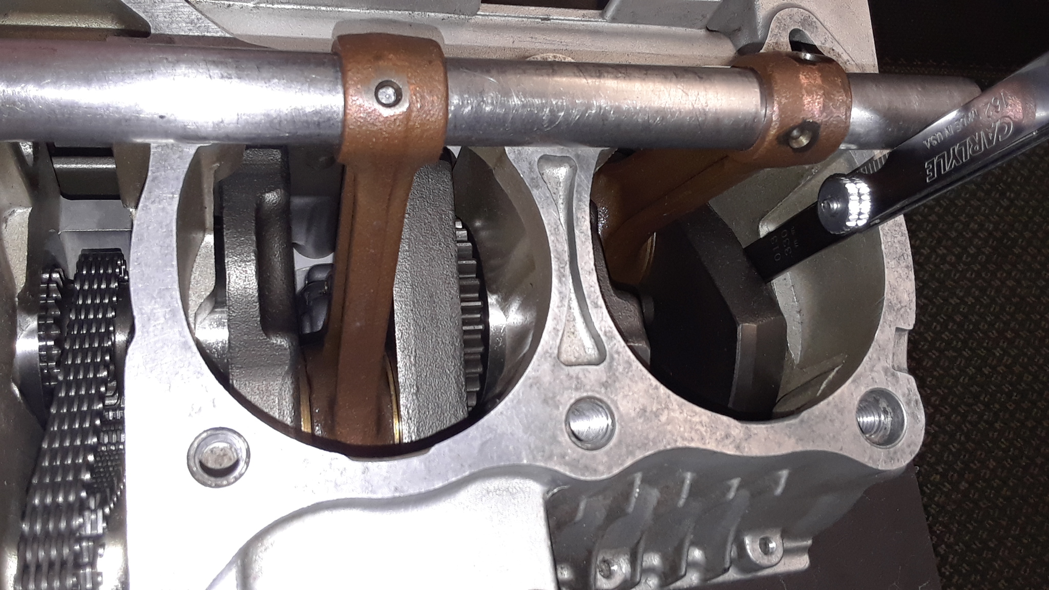

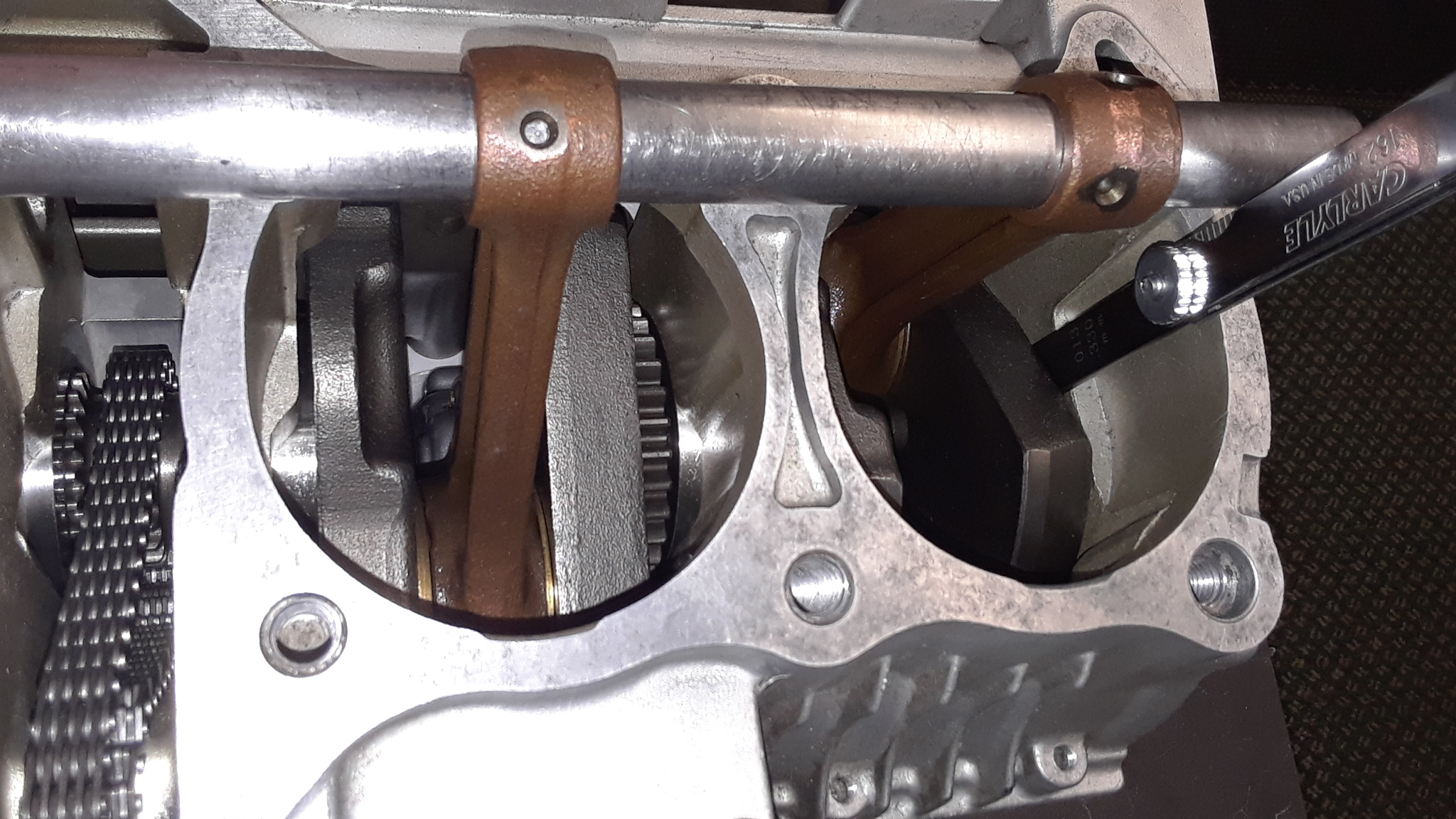

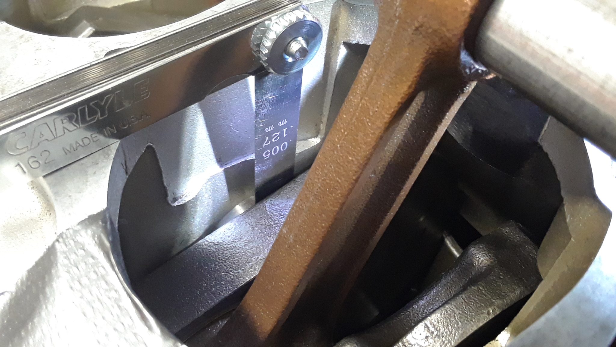

RGBGuy
Following up, and wonder what you found in there...
I am able to get a .127 mm (.005") blade in the #5 thrust bearing gap, but the fit is tight.
