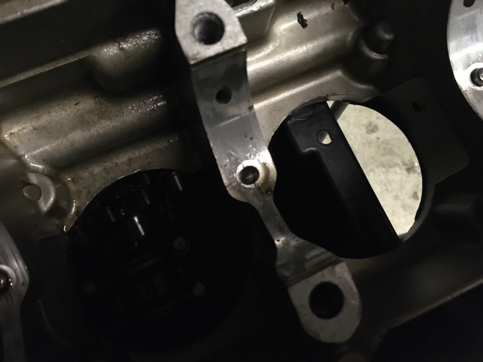

There is a thrust bearing on all Z/KZ cranks. But what often happens is the casting upper webbing that has the locating pins cracks. You won't loose the pin unless the casting bit just falls out. Normally the casting around the pin just cracks and that pin wanders.

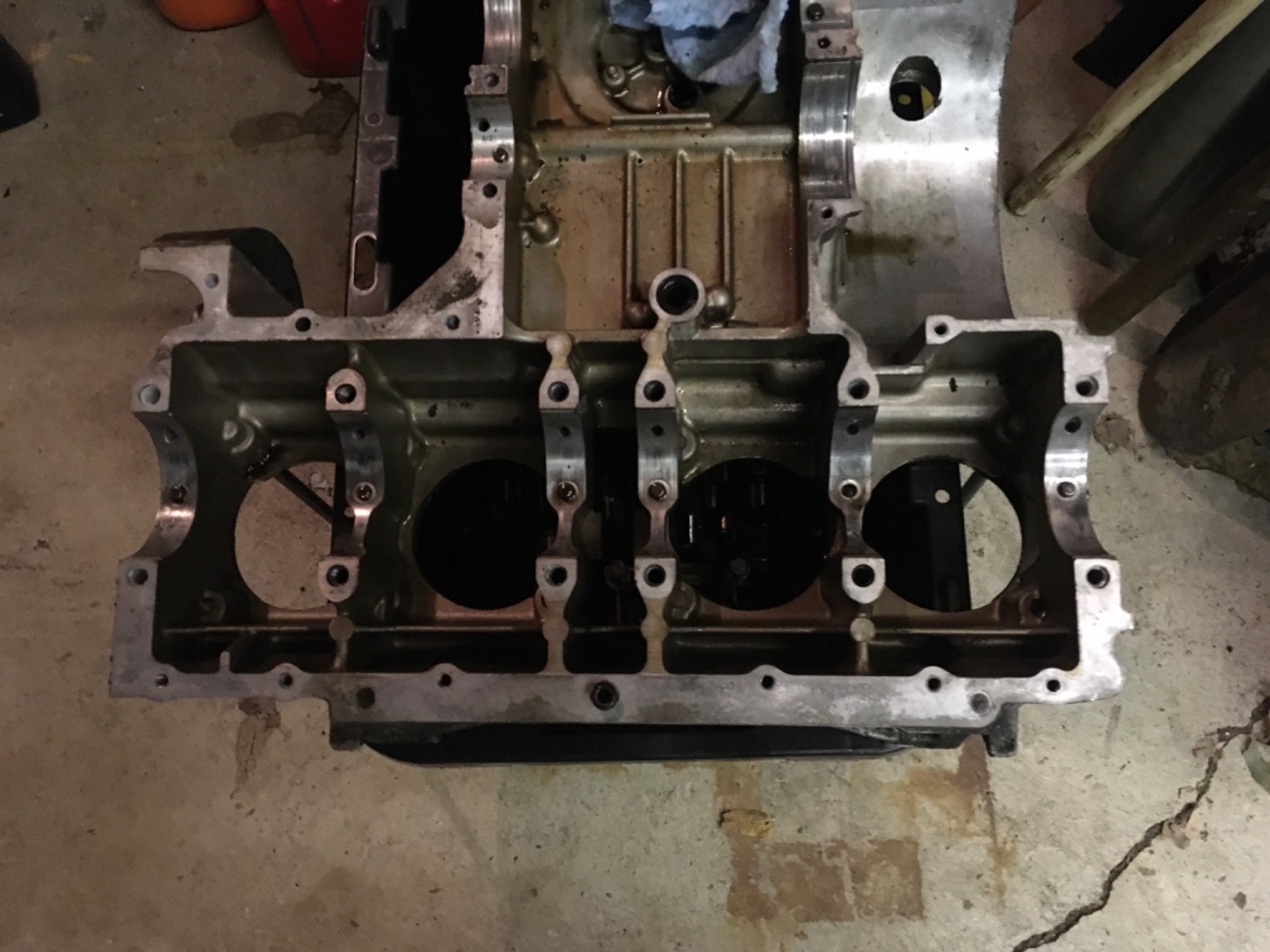

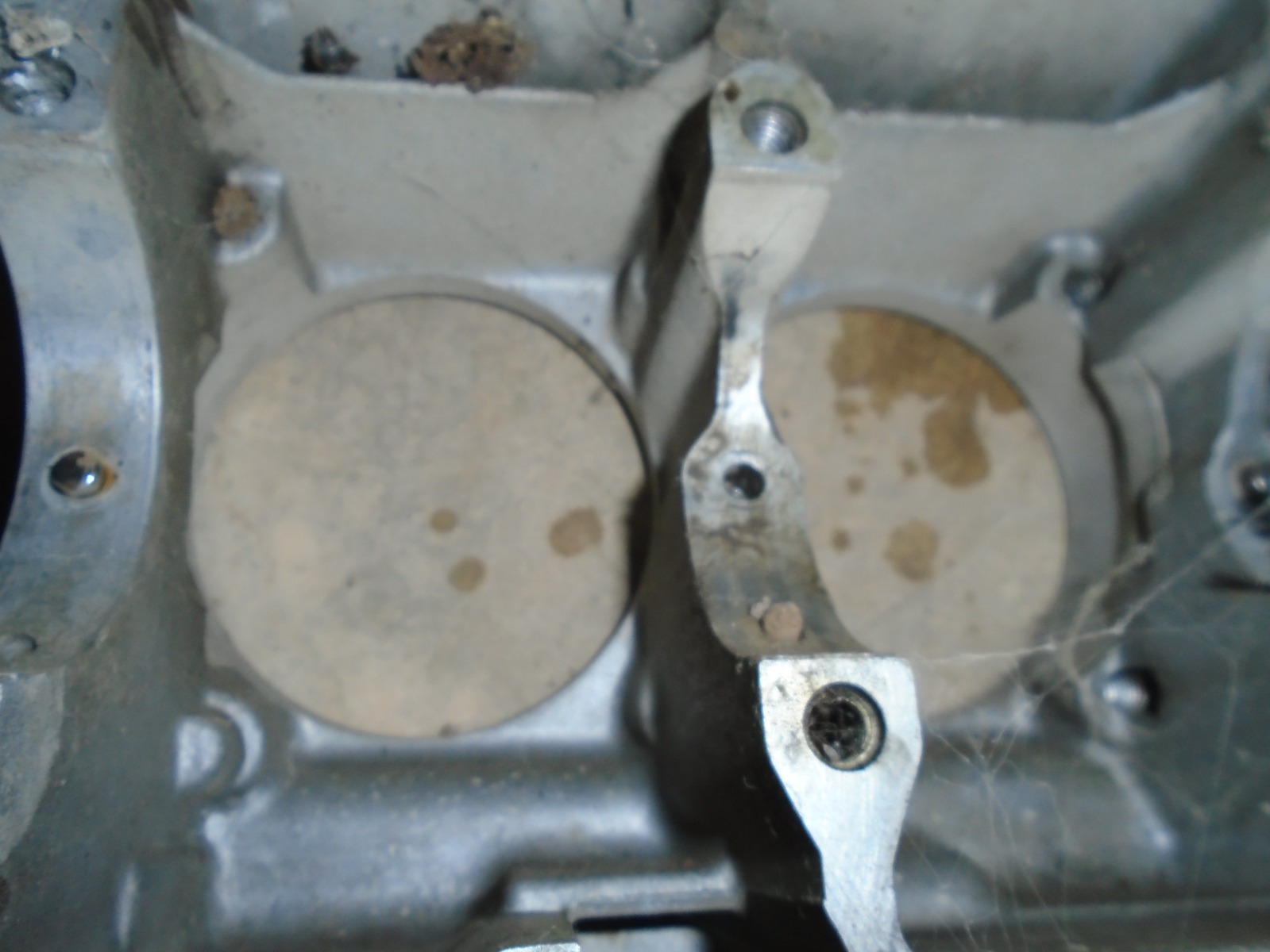

A photo example of a 1974 Z with the same symptom. Note the missing pin. This is the pin, same as yours #5, that controls side-to-side motion of the crankshaft assembly. The thrust control is built into the bushing that plate each side of that #5 crank bearing in the built-up crank/rod assembly. Just info if it helps?

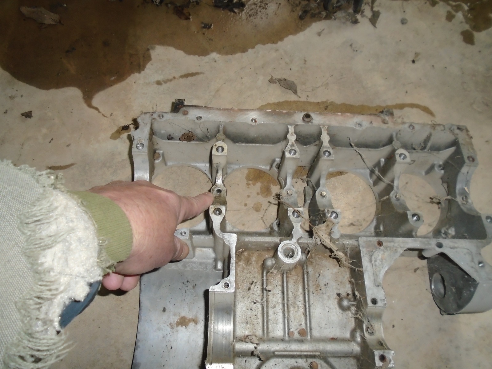

I agree with Asphalt900, here is a an upper casing with that alignment pin bore egg shaped because the web cracked. I have another case with all webs cracked. I’m sure that’s what is causing your crankshaft walk.
