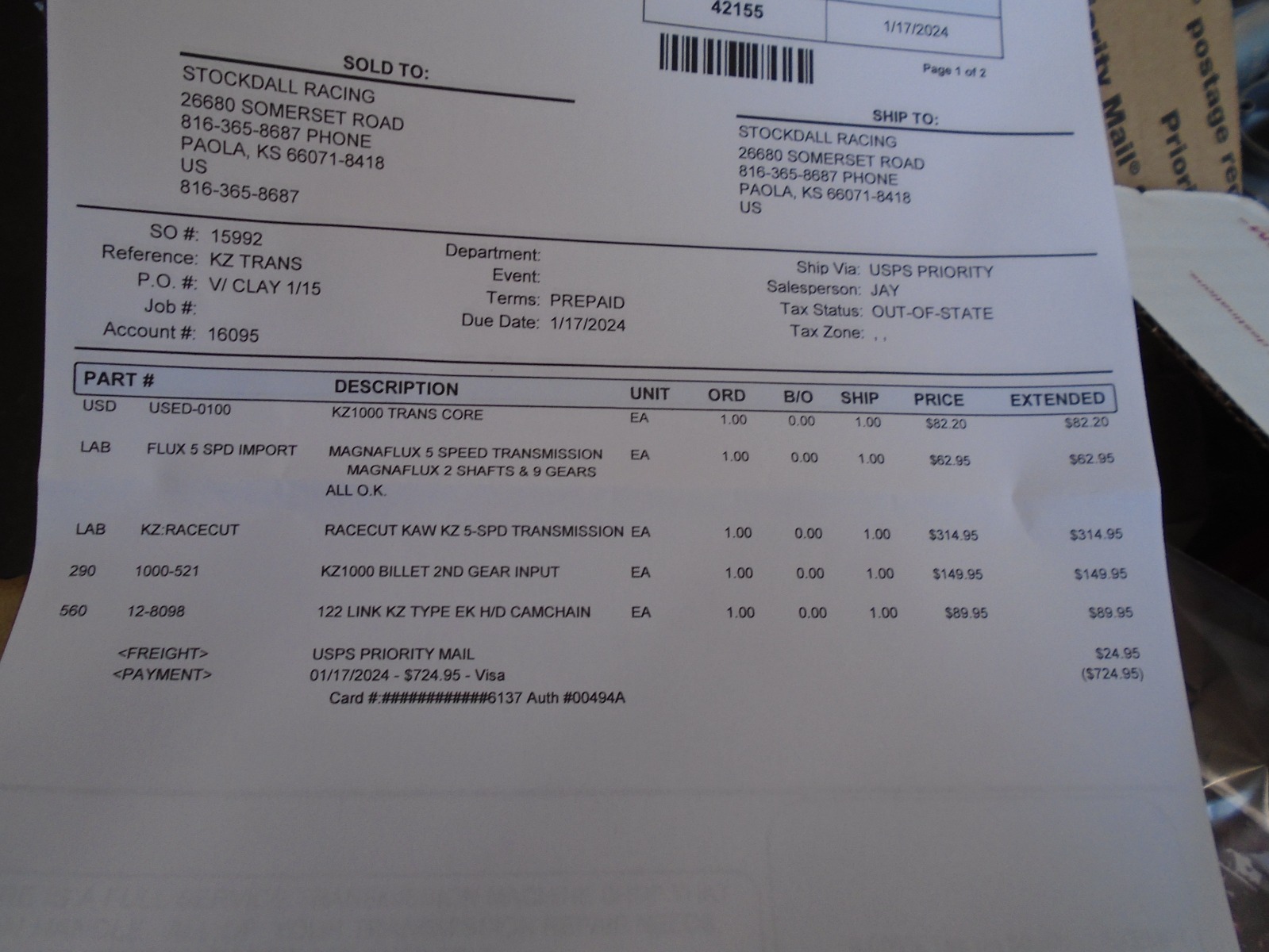

Thank's for the additional info Fella's. Just purchased a Gear-set from MRE, Jay was soo personable.Not to be confused with the Jay from APE. But ain't as cheap as You fellas remember, Just shy of 700USD.so added a 122 camchain that is NOT a split roller 122. 2ND gear set is what Orient Express uses and the usual undercut. It's just money ya know.

#894306
Just for reference, gearsets just arrived. These are the costs these days. Albeit i did purchase a 122 camchain, so take that off the price of course. Offered a core but they were't really interested. Just Info.

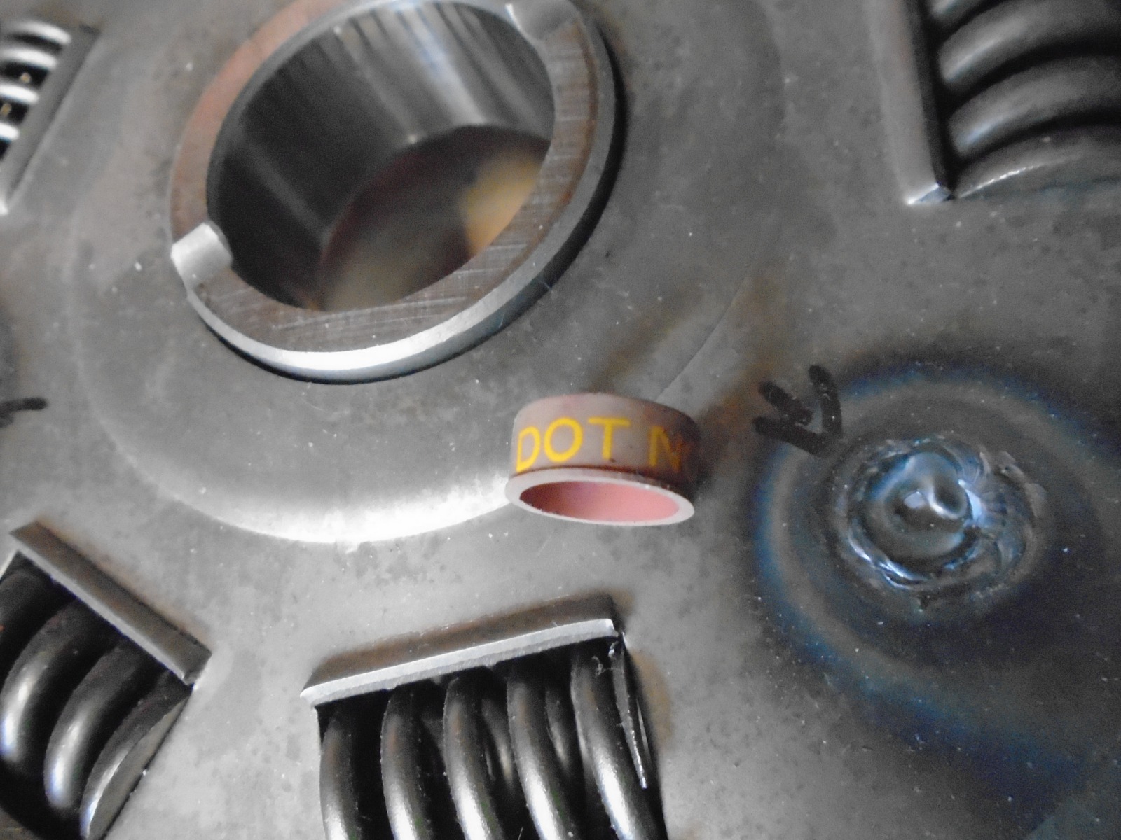

don't forget the clutch basket.

But of course!
