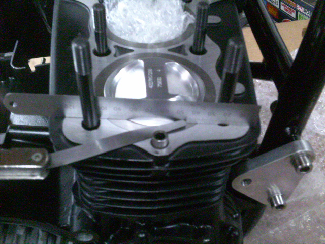

thank you so much you are a wealth of knowledge are the pistons typically 0 deck on a stock untouched motor or are they down in the barrel. thanks!!!
- zed1015
- Posts: 3362
- Thanks: 2072
Re: turbo engine build recomendations. thanks!
06 Dec 2023 08:14
I've never had a stock motor with zero deck height.
A motor i'm building now that already has the block decked an unknown amount to level in the new liner tops is still 0.35mm below the surface.
- turbodarnell
- Posts: 16
07 Dec 2023 07:58
ah that is very significant. it appears i will have to pre assemble the engine and check deck height then order the corresponding spacer needed. thank you!
