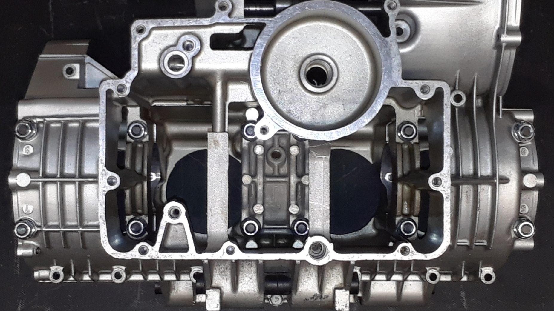

Isn't deck height normally measured with the cylinder torqued down??        Or was this just a "photo op"?
Yes! Measurements were take with the block nipped down.
That pic is from my build thread over on the Z1 forum and was taken after i'd took my head substitute spacers off.

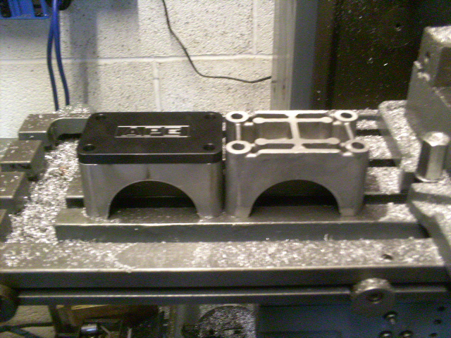

hey zed, im using a main bearing support cap plate. does that require new fasteners, or do i mill the cap down so that the old bolts will fit? thanks!
The cap has to be milled to fit the cap.
Once the hump has been machined off you then have to further mill off the thickness of the support plate to make it the same height as it was originally where the bolts sat .
You can then either use the original bolts or fit a HD stud kit.
Pic shows a couple of caps i'm in the process of doing for my current builds.
The one on the right has the hump removed but is still the original height where the bolts sat.
And the one on the left has had the thickness of the support cap milled off so that the whole assembly is the same height as original when fitted. .
