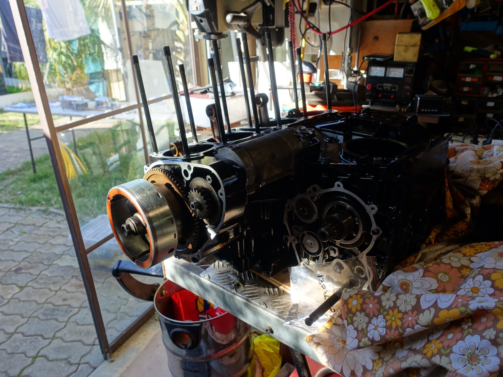

Thankyou, I suppose my bikes have been going too well to consult / read the posts.
I now have a GPZ1100 83 unitrack motor which has been totally rebuilt (just the head to finish next week). I want to replace the standard as new GPZ1100B1 motor in my Franken bike (with 83 cams), this motor develops 95RWH BUT I always wanted the 83 so when a good engine was advertised I bought it,

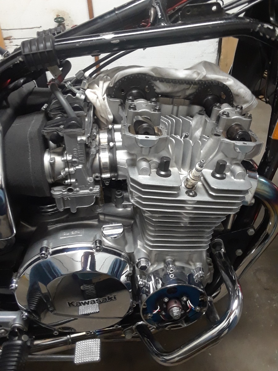

27 Sep 2023 11:50 - 27 Sep 2023 11:51Agreed 1000%
Would it make sense to install J-head valve components (springs, retainers, buckets, etc) into the ZX1100A head to simplify lash adjustments, comparatively speaking?

27 Sep 2023 12:52 - 27 Sep 2023 17:23Correct, not the head, just the valve components...As I understand it the "J"head isn't compatible with the pistons used in the later motor ??
Agreed 1000%
Easily change shims without removing the camshafts, comparatively speaking of course.

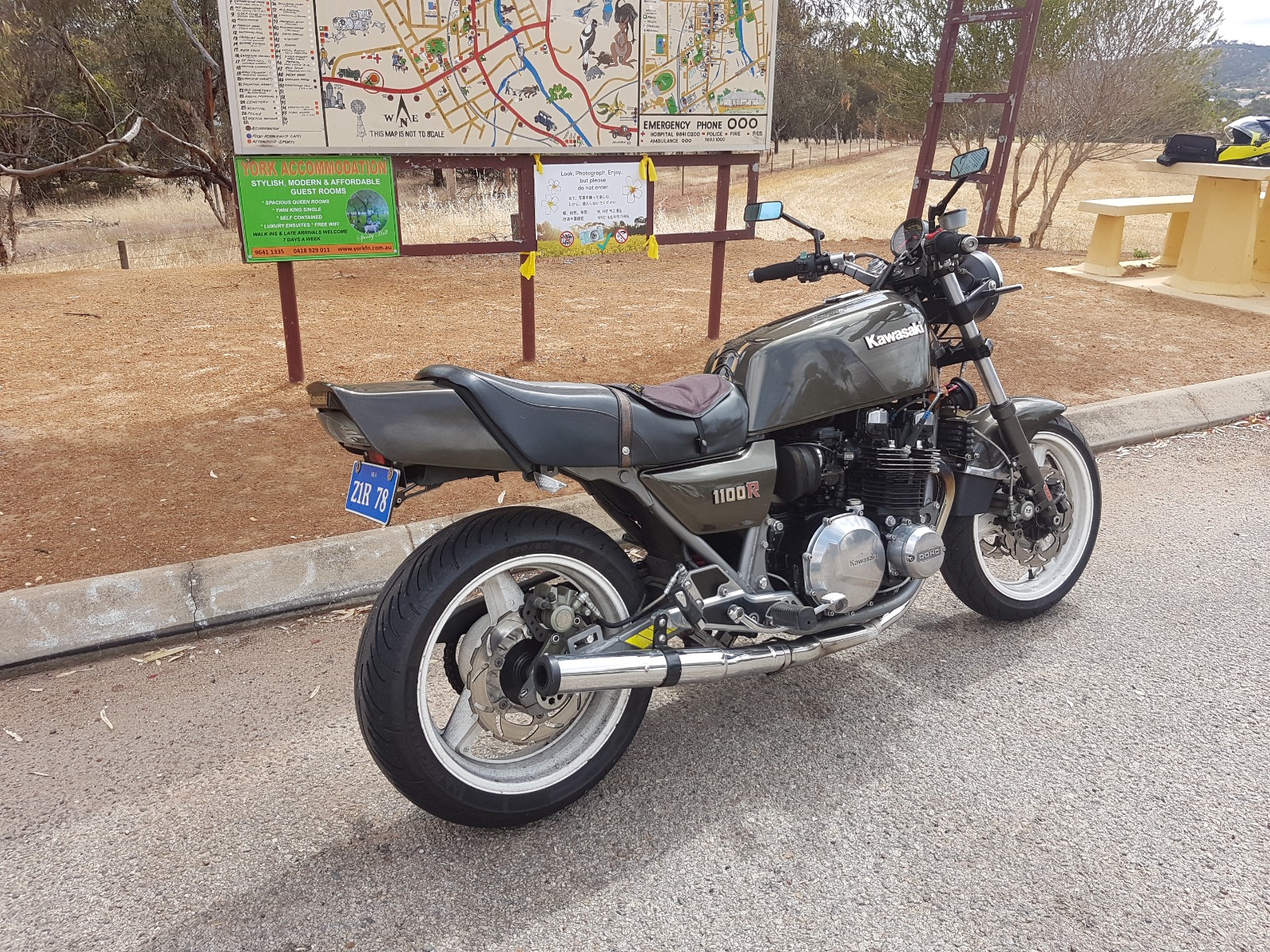

28 Sep 2023 04:19 - 28 Sep 2023 04:23That 1100 is really nice Bozo Thanks again. This particular engine has a J model head, I did clean up the porting. Cams are GPZ1100 83 Unitrack model. Would you believe there are around 17 different motorcycle bits used hence Frankenstein,CBR1000F wheels, speedhut gauges, zx10 clutch lever, ZRX1100 carbies, GTR1400 radial master brake, EX650 brakes (new addition re welded brackets), GPZ900R Front end, GPZ750 turbo swingarm, ZX750R Bitubo Shock (this bike weights 215kg with fuel), marving race pipe plus many more.Handles and goes incredible BUT I still want the GPZ1100 83 Unitrack motor
Daveo, that motor in your picture is Fantastic Porn

28 Sep 2023 05:04I can easily believe the "donor" list. Don't know if you have seen my build thread but I will end up at a similar number of donors I thinkThat 1100 is really nice Bozo Thanks again. This particular engine has a J model head, I did clean up the porting. Cams are GPZ1100 83 Unitrack model. Would you believe there are around 17 different motorcycle bits used hence Frankenstein,CBR1000F wheels, speedhut gauges, zx10 clutch lever, ZRX1100 carbies, GTR1400 radial master brake, EX650 brakes (new addition re welded brackets), GPZ900R Front end, GPZ750 turbo swingarm, ZX750R Bitubo Shock (this bike weights 215kg with fuel), marving race pipe plus many more.Handles and goes incredible BUT I still want the GPZ1100 83 Unitrack motor
