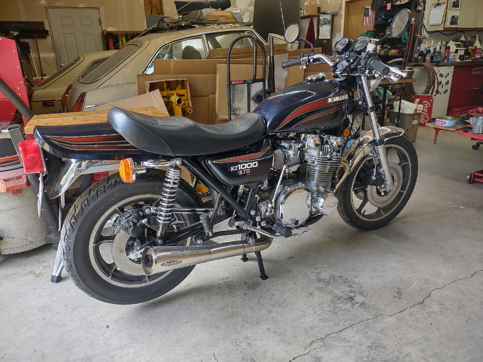

Nice LTD, I have the same seat and it lets me get both feet flat on the ground. I don't have the grab rail so I picked up a set of the small handles that attach to the shock mount and the hole in front of the turn signal. It helps with putting the bike up on the centerstand and someplace to hook bungees to.

28 Jun 2023 07:42That's a great looking bike you have!! I see it has a paint job like the 76 KZ900 LTD, very nice, I call it give me a ticket red.

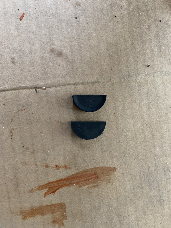

Yeah unfortunately it’s the same leftover shit on the inside when they make them. I’ve seen it on aftermarket ones and oem kawasaki ones.

09 Jul 2023 06:33Do yourself a favor and save yourself from a big headache......throw that garbage in the trash.
I installed these a while back and had one pop out puking oil down the side of my bike that I have spent days cleaning also soaking my leg with oil. I was lucky to be a few hundred feet from my driveway. When I felt the hot oil on my leg I looked down to see the plug laying on the top fin. Back in the garage I tried several times to reinstall, when I put the cover back on just getting the bolts finger tight the same plug kept popping out.
I searched my stash and found four used OE plugs and they fit like a glove. If I were you I'd just reseal your stock plugs if they appear to be I good shape if not I'd suck it up and buy OE they may be over priced but you get what you pay for sometimes.
Below is a pic of the (OE top pic) and the aftermarket junk below, it seems to me the aftermarket is a bit larger than OE.
