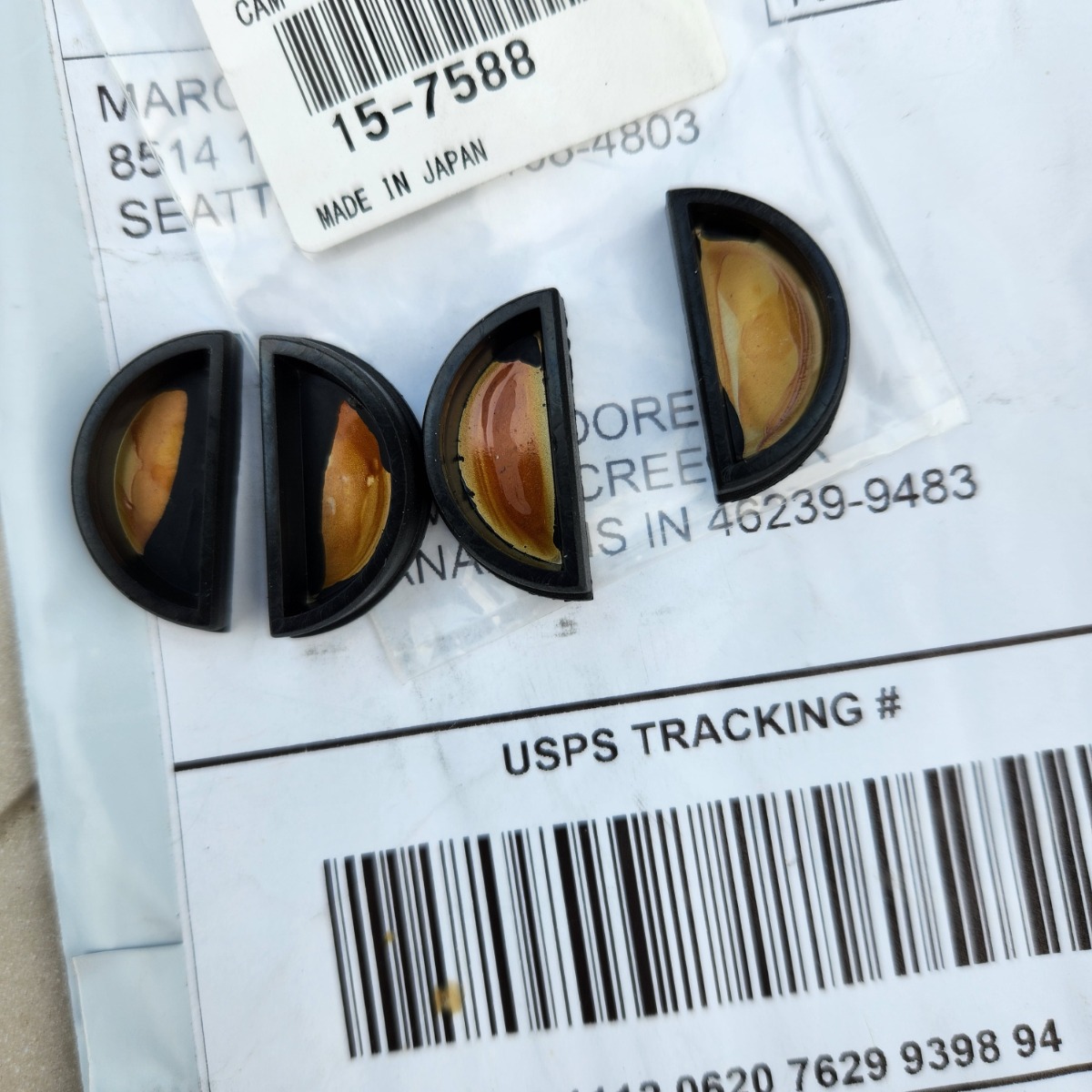

Hello KZriders ! Just got these new Vesrah cam end plugs and noticed the backs have a brown reflective "residue" inside. They were listed as new. Hmm.
Is this how they should look inside ?

The rubber appears new so I would say the residue you can see is from the moulding and bonding of the rubber and inner support.
If there was any evidence of oil or use on the outside faces of the rubber I would have doubts.

Thank you Warren. No sign of oil. I'll plan pick out all the brown moulding/bonding on the installation day.
2Thumbs down Vesrah.
I would've hoped for some better quality than that.

I would agree with Warren, it is also not uncommon for raw steel parts to have a corrosion inhibitor applied so they don't start to rust in storage

Update-According to the vendor, it's epoxy and all of them have that. (Free and no extra charge !)..
I think we are good,
Never seen a bold gold recessed version b4. AmaZing.

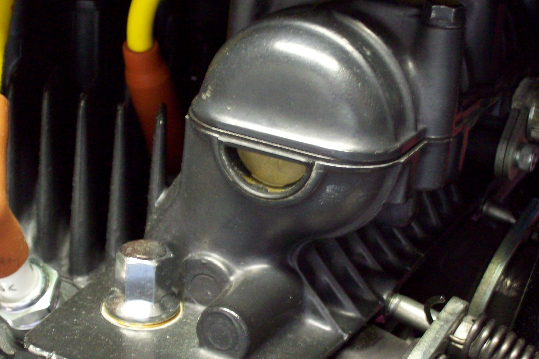

26 Jun 2023 12:19Never seen a bold gold recessed version b4. AmaZing.
It's been fitted inside out. Common thing to do to stop them being pushed out.
The lip around the edge would fit on the inside.

I just installed the Vesrah cam end plugs on the Turd along with a new cam cover gasket from Z1parts.
I put a bead of 3M adhesive on the bottom of the end plugs and installed the cam cover without the gasket and let it set overnight and the next morning I installed the gasket dry, the 3M adhesive is some good stuff much better than rtv. I did put a small dab of rtv where the plugs meet the head surface. No leaks so far.
