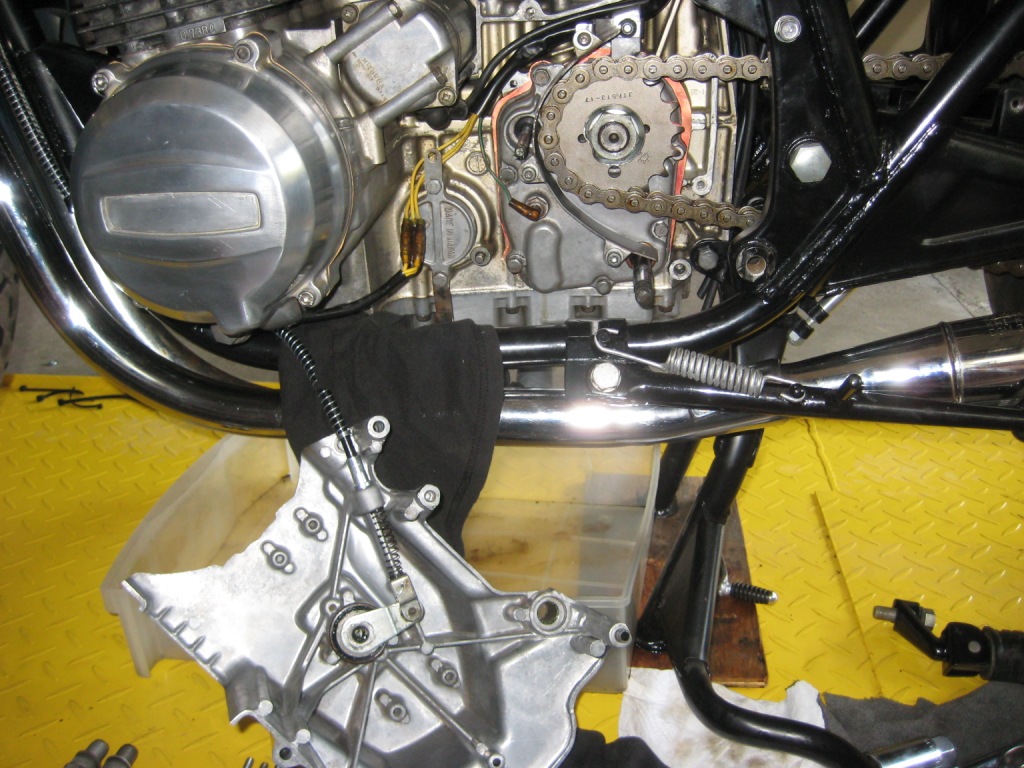

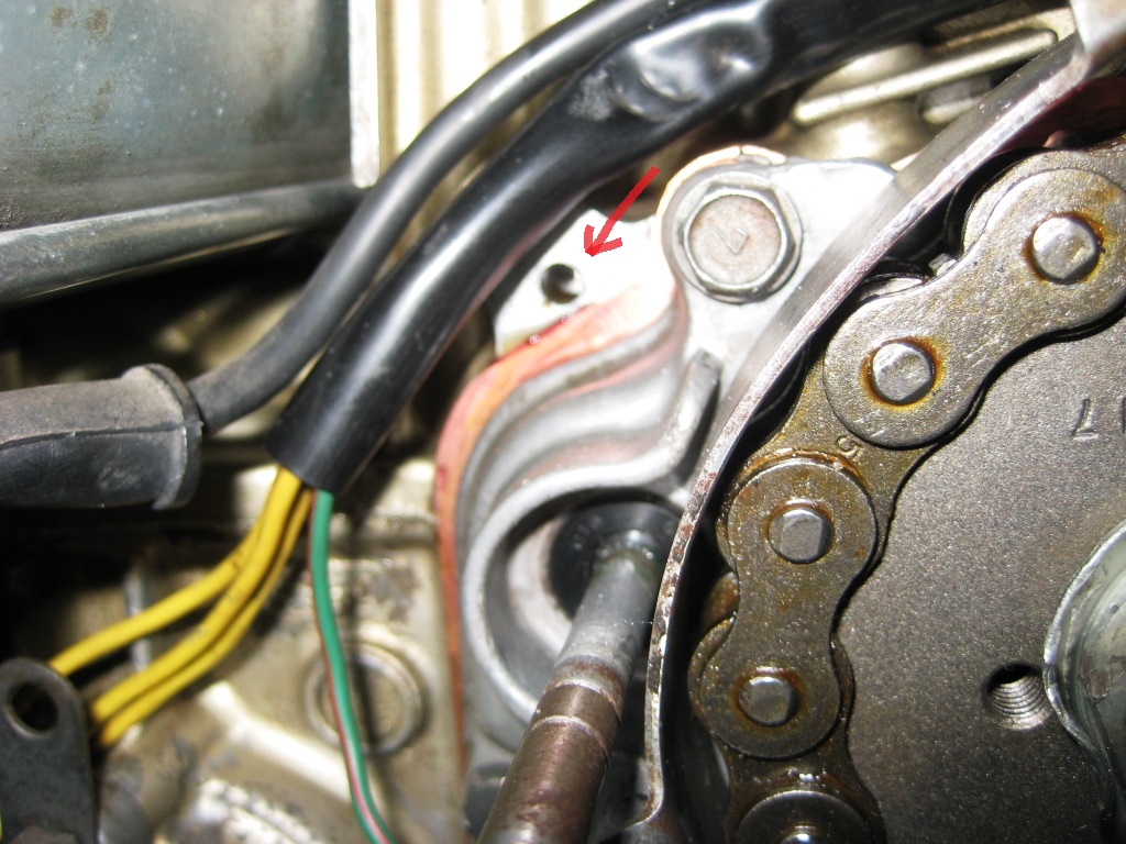

There is room for a 17T front running a 530 non O-ring chain so it clears the stock steel front chain guard.
It may rub with a O-ring chain, not sure.
I had to change my gearing because I could not make it across a intersection without lifting the front wheel. Since then this has been my go to gearing for my non stock 650 builds (750 Spectre engine shown)
