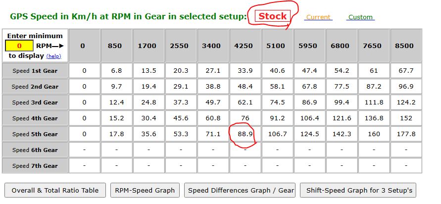

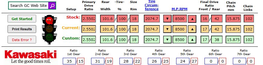

18 May 2023 14:43Scirocco did all the leg work for you and posted the results :It was Norwegian national day here yesterday, so sorry for the delay
Front wheel - 100/90 - 19
Rear wheel - 130/90 - 16
Front sprocket - 16 tooth
Rear sprocket - 42 tooth
Haven`t checked these up against the webpage yet.
Stock gearing in red, +1 front sprocket in yellow, +1 front and - 4 rear in green - Only the rear wheel size matters.

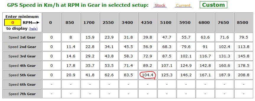

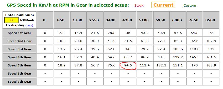

Thank you all.
I`m some confuse but I belived I had largest sprocket I could have in front already.. I remember I got advise some years ago to go big as possible to reduce wear on the sprocket,
but what you saying there is space for 17th also ?
From looking at the table I think my RPM reader show approx. 1000RPM to much, I can also realte to these when it comes to idle for I`m idling at 2000RPM and not around 1000RPM.
So today:
4250 RPM - 88.9km/h
Going up to 17th in front:
4250 RPM - 94,6km/h
Going up to 17th front and down to 38th rear:
4250 RPM - 104.4km/h
What do you think ?

As advised by "Injected" 17/38 looks good for road use

I think with your 810 kit this will be fine and you will then have 210Kmh at 8500rpm
